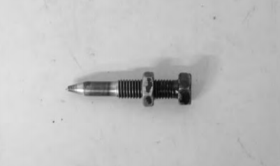

A nut, bolt and five minutes on a lathe could make that. How many do you need? :D
   / Fuel Filter Issues - Model A Toolcat #42
when I had the 2005 toolcat I had made a set, borrowed them from the dealer for the weekend and copied them and yes easy to make up on a lathe and they workwell to get the toolcat on a trailer
