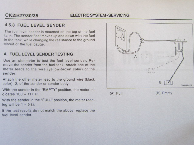

I had issues with my 08 CK30 HST fuel gauge. It was fairly easy to remove and test with an ohm meter. Mine was reading low all the time, it was $80 to buy a replacement. IMG_1554.JPG

I had issues with my 08 CK30 HST fuel gauge. It was fairly easy to remove and test with an ohm meter. Mine was reading low all the time, it was $80 to buy a replacement.View attachment 558592
Tell me how you removed the meter. It looks like it would be more difficult than you allude to.
/ Fuel gage #8
My fuel level sending unit is under the hood, larger tractor & bigger tank but looks the same as the one pictured by Ranchofla. Just unplug, remove the small nuts and pull it out, not that allusive. It takes a bit of fanangleing to get it out but not impossible. I found that with moving mine up and down from full to empty it was hit and miss if the ohm meter gave a bad reading.

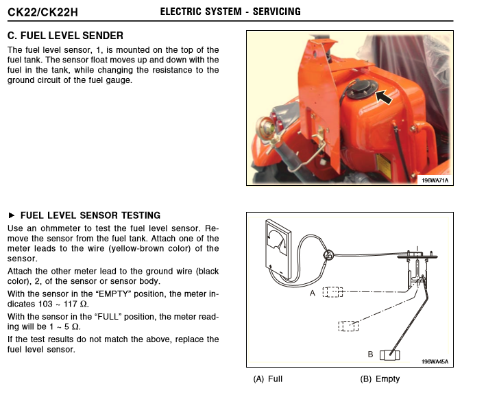

If you click on the picture in my post it has steps on how to test the unit if you remove it from the tank.

thanks, i did check out your links and are appreciative you took the time to post them, however iam reasonably sure thats not my issue as the gauge is always showing full scale even when the ignition is off. this would suggest an issue with the needle mechanism itself.
any issues with the resistance or sender faults would result in incorrect scale or no needle movement at all, as well as the needle returning to empty on accessory shut-off.
