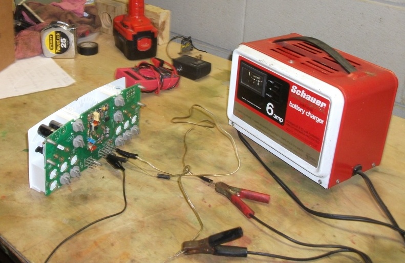

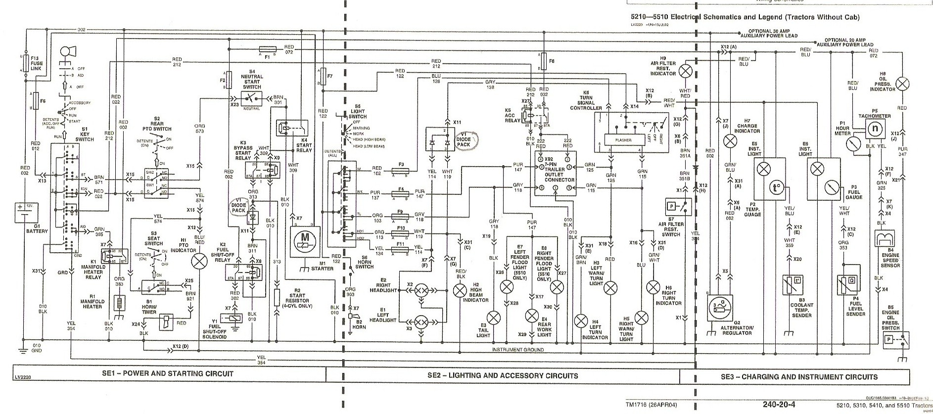

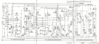

So much for that idea. You might consider removing the cluster and do this. I had to replace the cluster in my tractor, because the tach died and have done this. Use a battery charger as your power source to the cluster, tie together the negative from the cluster negative from the battery charger negative from the sender. Use a jumper to connect the sender to the cluster. If you still have the problem at least you will know it is in the cluster. I attached a picture of when I was helping someone determine the problem with a temperature gauge
I have attached the wire diagram for the 5X10 tractor. You will need to determine if it is the same for your tractor. If you decide to do this disconnect the negative battery cable before starting to take things apart. You might look at selectmanuals.com to get the tech repair and diagnostic manuals.
If you decide to do this, avoid taking the cluster out of the black frame, reason is if you do not tighten the screws evenly you run the risk of breaking the glass. I have include a pdf of the order to tighten then screws if you need it.
Thanks I'll try that looks like I'll have to buy a cluster
