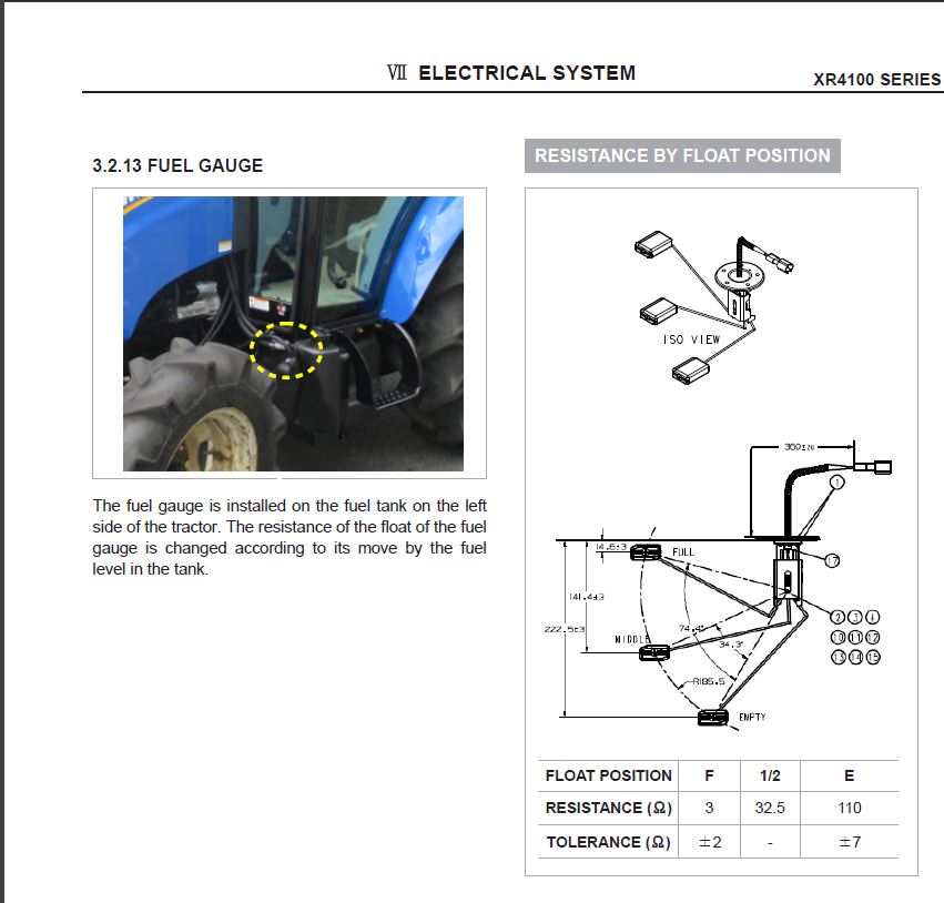

You may need to get a service manual. Here is a snipit from mine about the float and what resistance by position it should be at. Something to check for your machine.

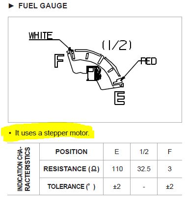

Also, mine uses a stepper motor to move the gauge. If your tractor also uses this motor, might be the motor is bad.
