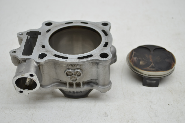

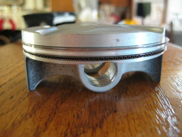

It has a 14,000 rpm redline and requires a new piston every 40 hours of use. Manual wants
me to change the piston every 15 hours but I don't ride too hard all the time.
Is that a motocross bike? FI on thumpers quite common now.
What do the piston & rings look like at changing time?
   / Fuel Injection ATVs #49
It is a crf250x and crf450x models. The they are very similar to the motocross bikes but geared, suspension valved and cammed for woods riding. They have a wide ratio transmission plus the magic button that this old man needs. Looking at them side by side you can only tell the difference by the x model having a kickstand basically.
Pistons show a little wear on the bottom of the skirt but the Rings are always still good. These pistons having very little skirt is why they have to be replaced so often preventing wearing the cylinder. Not much keeping them straight. Low mass is the name of this game.
   / Fuel Injection ATVs #50
Wow, that IS a short skirt!
