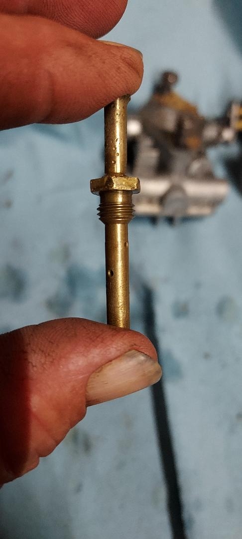

I just acquired a TO 35 and the whole fuel system was full of old stale gas with lots of varnish. Old fuel in the bottom of the tank about 1" deep. I used Simple Green Pro HD cleaner (it is purple in color) in the tank after putting some 3/4" limestone in the tank and jostled around to remove the heavy rust. Poured in the Simple Green in the tank enough to cover the nasty remains and let it soak for 24 hrs. It did a very good job of cleaning it up. Also used it in my new ultrasonic cleaner at a 3:1 ratio per directions on the jug to clean the sediment bowl and carb. which made them look like new. These are before and after pics of the emulsion tube out of the carb. to show how good of a job the cleaner did. I did not preclean before putting it in the U-S cleaner for 30 minutes on purpose, just to see how good of a job it would do. I was amazed at the results. I did spray it with brake cleaner when it came out just to remove what was left on it and wiped off with a shop towel.
