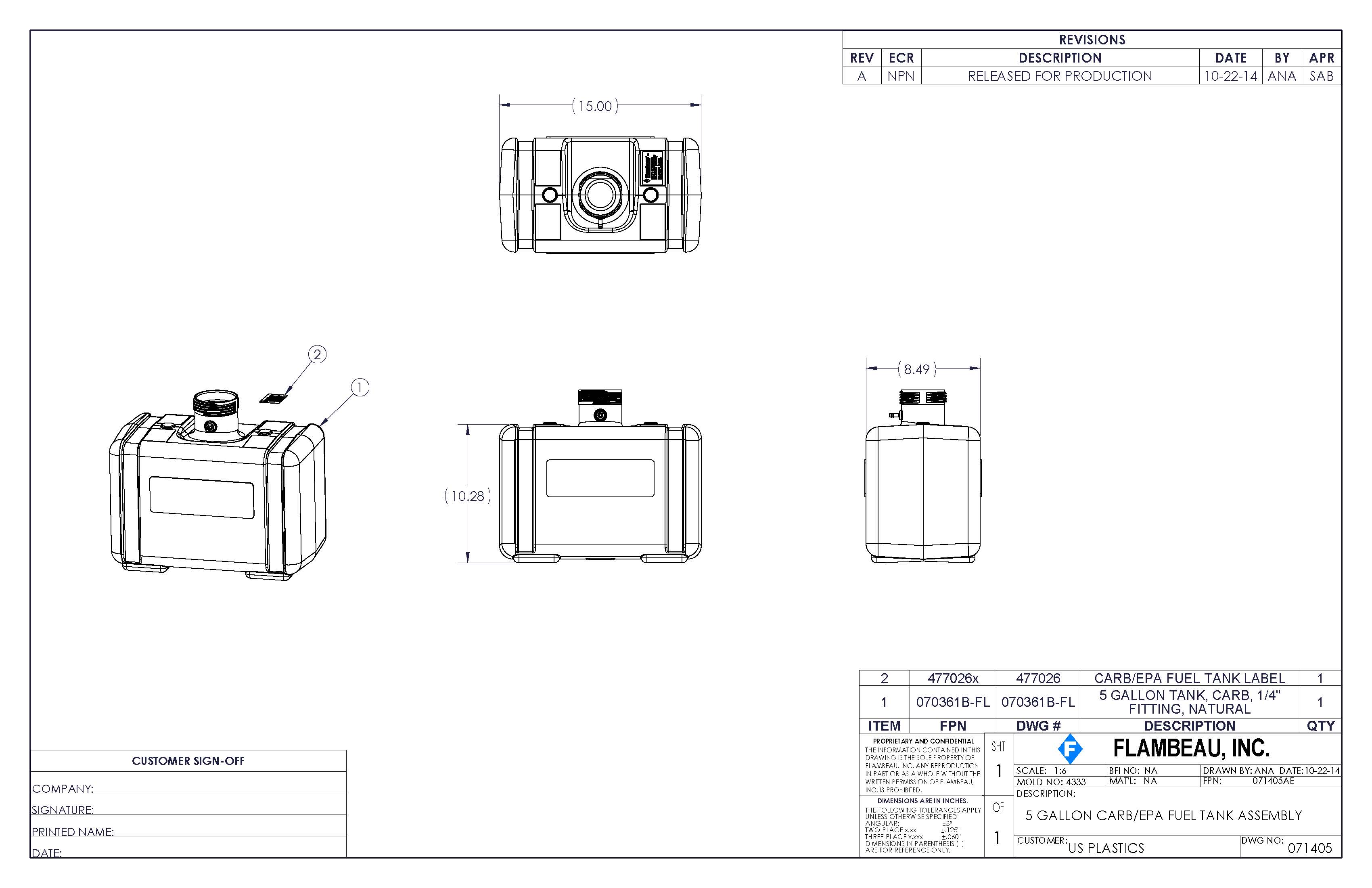

Yeh, I came to the same conclusion. However, PT should have noticed the leak when they removed it and not shipped it back to me in that condition... Anyway, I am going to try the idea of using a bulkhead fitting before trying another two alternatives (more on those later). I sent the pic with the dimensions to Boyd Welding (instead of doing a 3D drawing. They did not reply. I did find a tank at US Plastics that I think would fit. See below. But I want to try the bulkhead fitting first.
5 Gallon CARB/EPA Natural Tank with 3.5" Neck - 15" L x 8.5" W x 1.25" H | U.S. Plastic Corp.
WOW, that's a cheap price, even their 20 gallon tank is much cheaper than what your dealer wanted for the 5 gallon direct replacement!.. But, I say a metal tank is much better!.. it's hard to put out a gasoline fire!..
