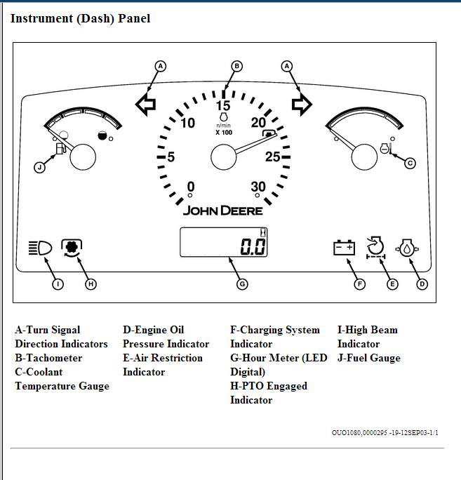

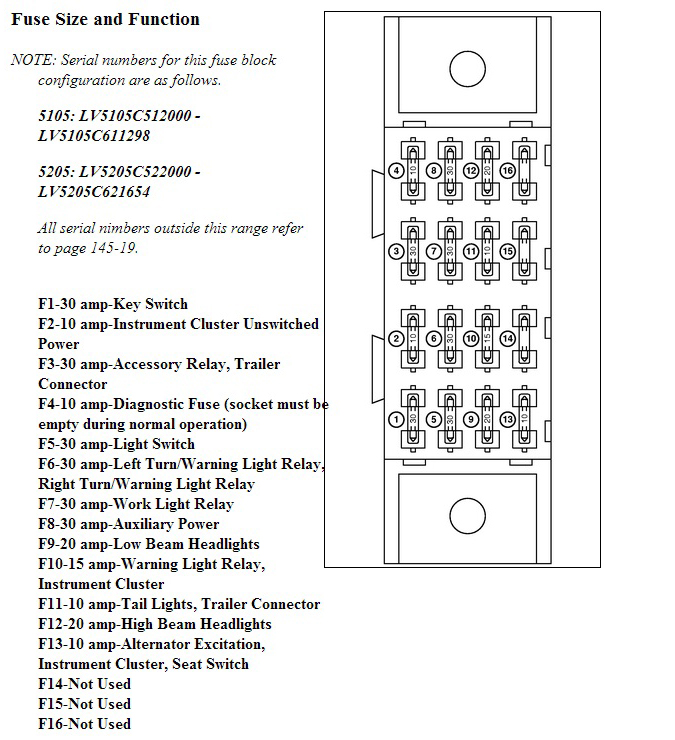

I have a 5105 John Deere tractor, made in 2004, which has a fuel level indicator which does not work. On the dash, everything else works. I was wondering if anyone could tell me which fuse might control that indicator. Fuse size and Function.jpg
The Dash looks like the picture below. It has fill on both sides of the tractor behind the seat.Dash-JD.jpg

According to the first pic, either f3, f10 or f13. Is there anyway to check for power at the back of the fuel guage?

Rick...Thanks for your quick reply. I will take off dash and clean fuses f3, f10, and f13 if they are not blown. Not sure about how to check for power at the back of the fuel guage. Ed
/ Fuel level indicator problem #4
Sorry Ed, that was f2, my thumbs hit the wrong key. Basically any fuse marked "Instrument Cluster".
Rick...Got it, fuses f2, f10, and f13. It'll take me a while to remove the dash and check the fuses. Will report back with results, though. Ed
Rick...None of the fuses were blown and I cleaned the ones you suggested. When I turned on the key, the fuel indicator needle went all the way to full, then went back to empty. Still not working correctly. Ed

Your instrument cluster looks about the same as on my 5210.
Most likely the problem is the fuel sender in the tank. Disconnect the 2 wires from the sender at the tank and connect them together, then turn the key to the run position (do not start the tractor) the fuel gauge on the cluster should go to full. If it does not then test the wiring from the sender to the instrument cluster.

JD5210...I will have my mechanic look at your suggestion on Monday. I have also noticed that the PTO light comes on now that it is warmer, even though I don't have the PTO engaged. That's H on the Dash. Sometimes it quits as I drive, sometimes it does not light up if I stop the tractor and turn the key off. It is erratic to say the least. Dash-JD.jpg
