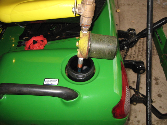

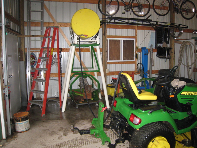

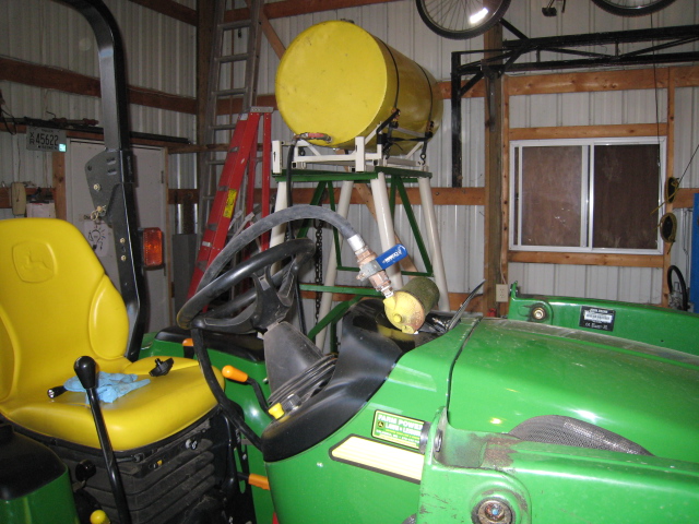

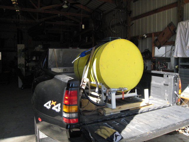

I am sort of done but had a couple hiccups in the system. This is basically what I come up with. Do you think the legs are sturdy enough?
I had a spin on filter at the source but there was to much restriction so pulled that out. I had a nozzle like at a gas station and that didn't work out. I ended up putting the 3/4 hose straight to the valve on the tank and put another valve at the end with a old style furnace fuel tank filter after that, that I got with the old tank, and that works fairly good. I can get a nice solid stream out of a 3/8" pipe. I was hoping for a nice solid stream out of a 3/4" hose but I would have to find a bigger filter with a lot of flow capacity using gravity. I fill a JD3720 and a JD X740 and they have fairly small tanks anyway so speed isn't a serious matter. At least I don't have to hold the 6 gallon can over my head for 5 minutes filling the tank. I just stick it in and turn the valve on, and don't walk away:ashamed:

Yea, you need a much bigger filter and have it mounted up by tank. Mine has a drain on the bottom to remove water and debris.
