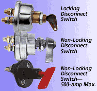

N80,
Here is a picture with three different versions of the battery cut off.
   / Fuel shutoff and general theft protection.
#19
Thanks Jerry, that helps. I think I'll look into that.
   / Fuel shutoff and general theft protection. #20
George-
I looked at Jerry's switches - Very good idea. The top one has a removable key, all the keys are the same, is probably the best and is the most expensive. The center switch has a knob held on with a small screw. If you use this one, remove the screw and knob - you only need to slide the knob on to open/close the circuit. Both switches need to be on all the time the engine is running.
If you are still concerned, after you shut off the fuel tank, get a rag to keep the area dry, disconnect the fuel line after the shutoff, insert a metal rod/stud the same diameter as the I.D. of the hose, and re-connect the hose. This will prevent the necessary fuel from reaching the engine. More work, messy, but secure.
