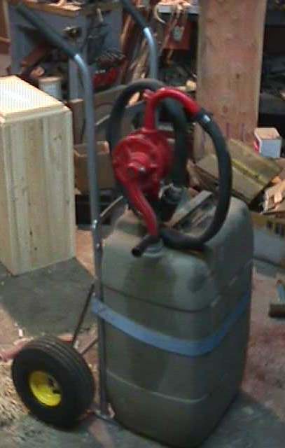

The tank was some sort of industrial chemical container.
It contains about 25 gals and is manageable when full. ie, I can unload it from the pickup but would never try to load in.
Tricky part was fitting the pump as this tank has non standard threads. (not pipe threads).
What I did was use about a 6" length of 1 1/2" abs water pipe with three slits cut 1/3 lengthwise and firmly clamp with pipe clamps (jublee clamps).
The result is a nice snug taper fit that is 'just right'.
I can crank away as much as I want and it remains in place.
Sure beats the bucket/5 gal pouring with a bench.
Forget actual GPM of the pump, but it is very adaquate and sure makes fueling a pleasure.
And the pump was a mere $15-20. on EBay.

<font color="blue"> 1*The tank was some sort of industrial chemical container.
2*Sure beats the bucket / 5 gal pouring with a bench.
PILOON </font>

I must admit that this is what prompted my idea. (the concept, not the price)
The cart I had as well as the container.
The pump came from EBay for, I think about $20.00.
It pumps (quote from the label) 10 gals/min. Guess that depends on how fast you crank. Just right for me!
I know harbor freight stocks that 'barrel pump' at, I believe $39.oo.
Must admit it sure is nice to wheel the handcart over to the tractor, insert hose and crank. Couple of minits and she is full.
A turn or 2 in reverse empties the hose back to the drum to avoid spills.
