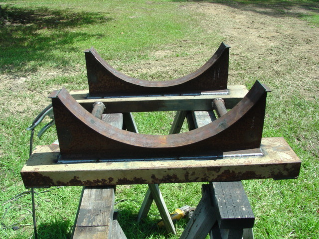

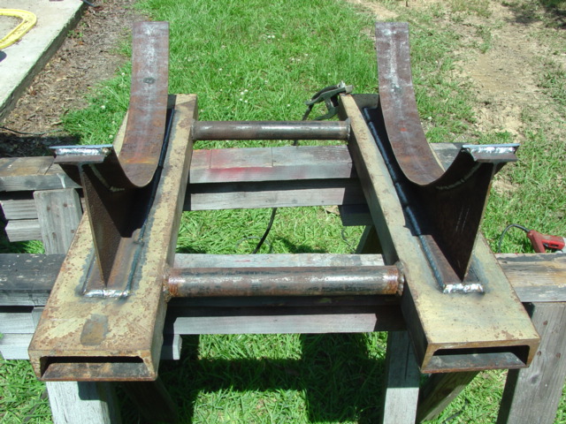

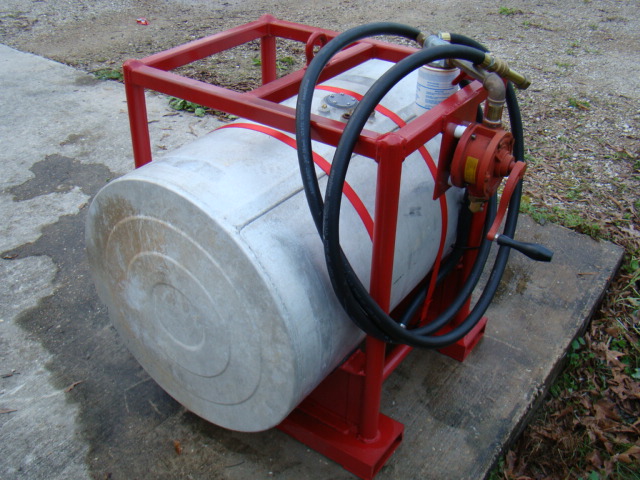

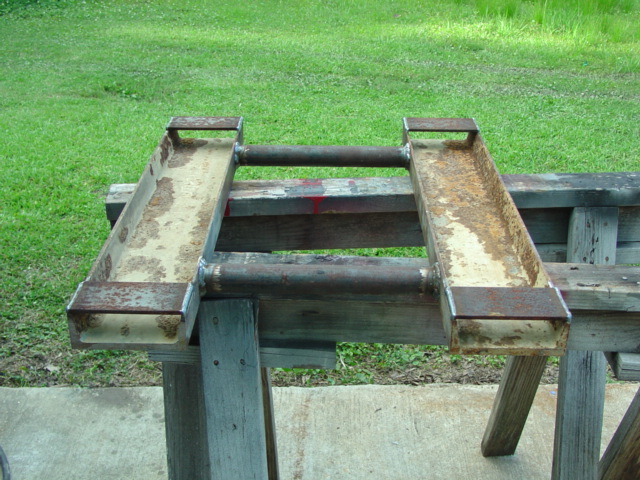

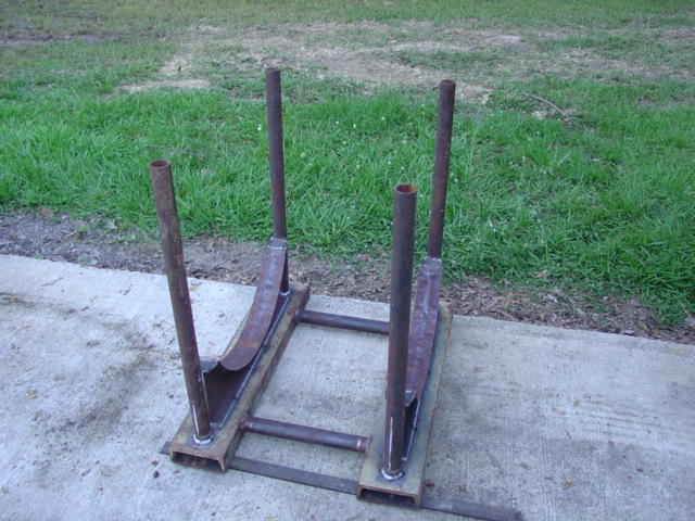

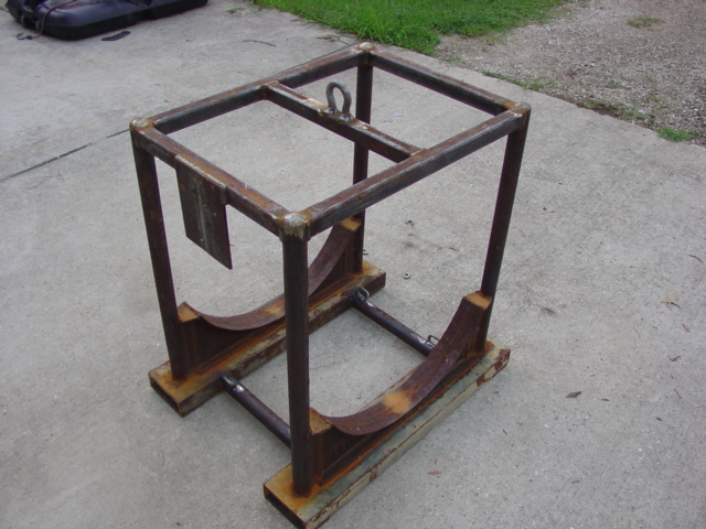

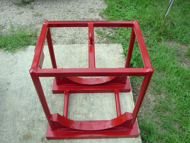

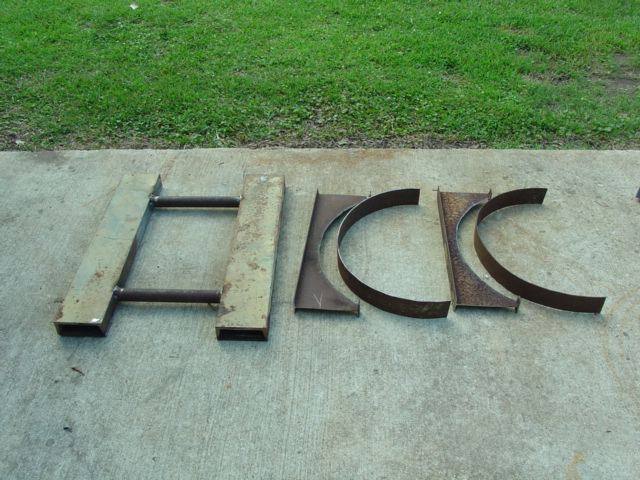

Here is a fuel tank stand I built for a 75 gallon tank from a Mack truck. The skids are built out of 6" channel iron with 1-1/2" ID pipe used for the spreaders. 3" flat bar was welded to the open side so it could be securely transported by a set of forks. The cradles were made from a section of trailer house frame with a strip of 1/8" sheet metal cut 3" wide and welded in place to hold the tank. The upper part of the frame was made out of the same 1-1/2" ID pipe and 1-1/2" square tubing. A shackle was cut and welded on top to be used as a lifting eye, and a piece of 1/4" plate was used for the mounting location for the hand rotary pump. Brass fittings, valves and fuel hose finish off the plumbing.
Enjoy.
Enjoy.
Neat
Good Job.
Do you fill it with off road?
   / Fuel Storage Tank and Stand #3
Cool, good idea using a truck fuel tank, nice job.

Thanks for the compliments guys.
When I bought this house I'm living in now, several years ago, the tank was in the backyard. I was originally going to get rid of it, but I couldn't find anyone to take it. I even set it out by the road for the garbage man to pick up but they consider a fuel tank hazardous material and wouldn't touch it. I carried back up to the house, and after it set in the back yard for a couple of years, I got the idea from this forum to build a storage tank.
LBrown59,
I just finished it couple of weeks ago and have not had time to fill it yet, but yes, it will be filled with off road fuel.
harwill,
Lifting a full drum out of the back of the pickup with the front loader is a bit touchy though.
Yes, I know what you mean. That is why I built this to be lifted by a set of forks or from the lifting eye.
Joe

Only thing I'd have done different is to have plumed in another hose on the pump.
