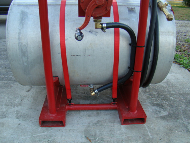

LBrown59,
Only thing I'd have done different is to have plumed in another hose on the pump.
What do you mean by plumbing another hose on the pump?

LBrown59,
*What do you mean by plumbing another hose on the pump?
Thanks,Joe
I'm talking about the hose looped around the green hanger.
The hose has a white end on it and is clipped to the stud near the ceiling.
I use that hose for pumping fuel from any other container besides the set ups drums.
To unload your 75 gallon tank off your truck I'd simply drop this hose in the tank and pump it empty.

Here's two more pictures that show a better view of the plumbing.

LBrown59,
Joe
There are only 2 hoses connected to this pump.
1 goes to the top outlet side of the pump and the other hose goes to the bottom inlet side of the pump.
Every pump and storage set up system I'v seen and read about on here except one is plumbed this way.
There are 3 hoses connected to this pump.
1 goes to the left outlet side of the pump and the other 2 hoses go to the right inlet side of the pimp
This and one other set up are the only ones I know of that are plumbed like this.

I see what you're saying now. With that setup you can pull from one container to fill another container. That's a good idea since yours are not portable. I designed mine to be portable so it is easily loaded and unloaded onto a truck or trailer, even when full. What kind of pump are you using, and where did you get it from?

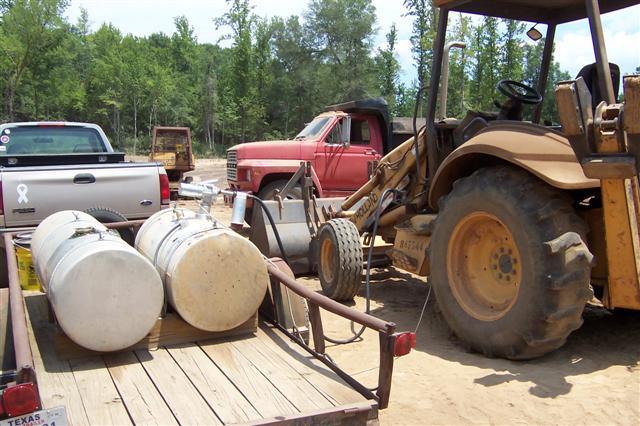

I'm a big fan of saddle tanks and used two of them for my fuel storage. I like that they wont rust and can stay out in the elements year round without a worry. I added a 12 volt fuel pump to one of mine and connected them together with three, 3/4 inch hose lines. I fill one tank and pump from the other.
Eddie
