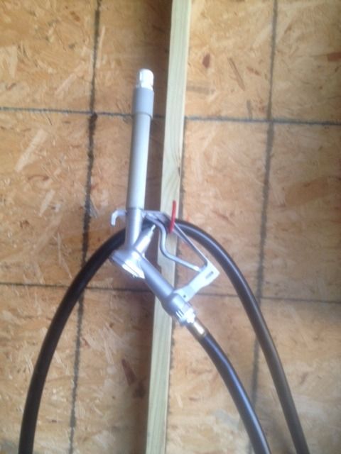

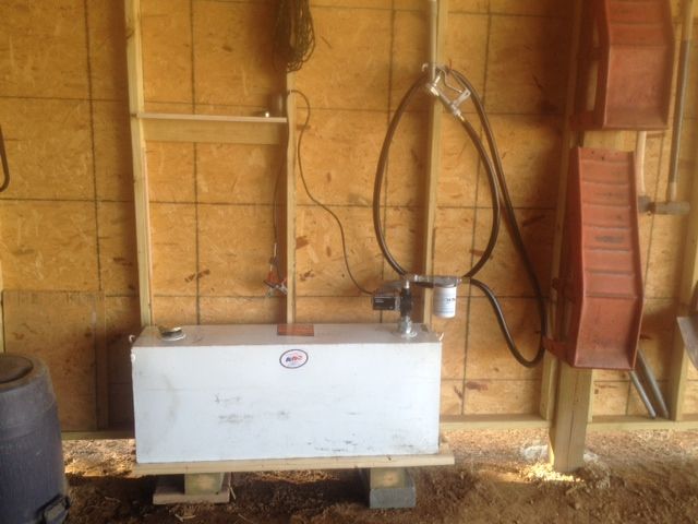

Update: Ok I got the tank installed with 12Volt pump and filter. It was a snap to load the tank and go fill it and bring it home. I have fueled both my tractors with it and man does it work great. Pop the hood, clamp to battery and lower hood so that I can open fuel cap then pump fuel. No splash, no over filling, no lifting 5 gallon cans while doing a balancing act to pour them in, no funnels and fills a lot faster than with jugs. I love this setup, should have done this a long time ago.
I got the tank at a pawn shop for 130.00, pump and filter from Northern Tool 211.00 shipped to my door.
Mounted in my tractor shed in the dry, I can pull right up beside it to fill tractors.

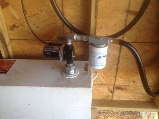

Here is the pump, I think it is rated at 8GPM, had lock on fill handle and On and Off switch. 6FT 12 Volt cord and I believe 13ft fill hose. I did have to cut off the pickup tube, it was to long for the tank.
I built a PVC cover for the nozzle to keep the dirt dobbers and crap out of the fill nozzle.
I can undo large nut on pump and pull it out, hang it on the wall, put cap on tank and pick tank up with tractor and sit it in back of truck to go fill it. Reverse order to put back in place. With our tractor use, I feel like this will be approx 1 year of fuel for us.
