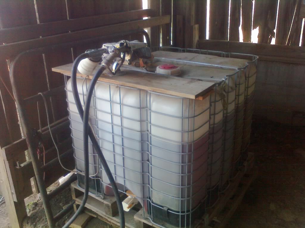

   / Fuel storage tank questions-Help needed #14
That's what I have. I added an electric pump and an inline filter. It works great.
I did have one supplier look at it and say something about they are not supposed to fill plastic tanks, but he went ahead and nothing more has been said.
I do keep it out of the sun, I'm not sure how long that plastic will last if it is constantly exposed to sunlight.
I still have the original water and particulate filter on it. It's been in use for 5 years now. I go through 3-500 gallons a year.
Some time when I need fuel for starting a brush fire or something, I will tap off of the bottom drain and see if there is any moisture in it.
I have been contemplating on how to fix mine up for use. How did you attach the pump to the tank to make it vapor tight?

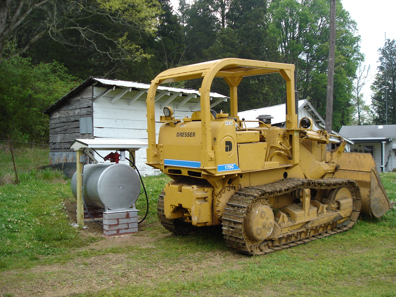

Update:
Thanks for all the help and suggestions. After some consideration, I elected to purchase a steel tank, pictured below, off of Craigslist. The former owner allowed me to climb on top and lower my LED flash light into the fill hole and inspect the tank. There was almost no rust. The tubing is still in good shape.
Outside of changing the filter and painting the tank to a color more reflective of UV radiation, do you have any other suggestions about how to convert this tank over to diesel? I note that one of you suggested that the residual gasoline in the tank would have a negligible effect on the new diesel.
A second question is about the timing of filling the tank. Since I won't need much diesel now, should I wait till spring to fill it and run the chance of increasing the corrosion or fill it now with winter mix?

   / Fuel storage tank questions-Help needed #16
The pump flange is mounted on the board going across the tank. I cut a hole in the tank for the tube and caulked around it.
I wouldn't worry about the gasoline that might still be on the walls of the tank. That is an insignificant amount that it doesn't matter. Water in the tank is your only concern. Water in the air forms condensation, so the more air you have in the tank, the more chance for water to form on the walls of the tank. The water then drips into the fuel, and forms rust on the wall of the tank. Keeping it full is the best way to stop this, but having a good filter and changing it often is the only real way to deal with what is going to happen no matter what you do.
Congrats, it's a nice looking tank.
Eddie

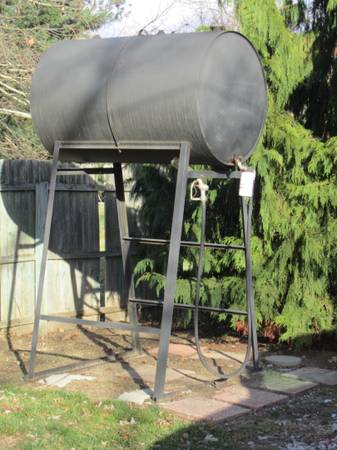

   / Fuel storage tank questions-Help needed #18
That is a nice looking tank. Wish ours was around that size. The gravity feed should be low maintenance and should save you a few hundred on a pump. We restored this old tank as it had served for 40 years with no TLC. The old pump was leaking bad and as you can imagine would give you quite a workout filling the loader.
Here's a before and after shot.
We also put the tank on a slant with a drain off in the back. We typically just fill it when it needs it, but hardly goes 4 or 5 months without a refill. We've sampled a it few times but haven't found any water.
