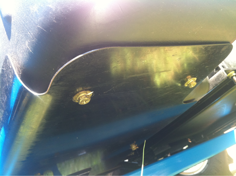

I just returned from a month in Wyoming and found my newly filled 25 gallon fuel tank empty. After putting in some fuel, I discovered that it appears to be leaking under the small metal "skid" plate at the front of the tank which is held to the plastic tank by 4 bolts into the plastic tank. This looks like a PP engineering job of placing a protective plate under the tank but bolting it into the plastic tank itself. I called the dealer and asked him to order a new tank for it.
My question is "Has anyone else had an issue with their fuel tank leaking? I know of lots of issues discussed right here on TBN with the LS manufactured Montana's fuel tank leaking and this seems to be an identical issue. I have lost about 30 gallons of fuel to this now not to mention the down time without a tractor that this is going to take to get a replacement tank.

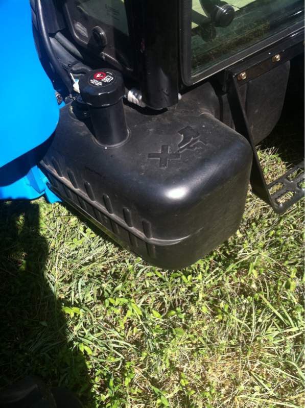

If someone has a chance, please post some pictures to illustrate where the problem area is on the fuel tank. I looked at mine and it was not obvious to me whether or not my model is susceptible to this type of failure. I had a fuel leak on my Kubota around the sending unit that ended up requiring a factory modification kit to better seat the sending unit gasket and maintain constant pressure, so I hope I am not going to have trouble with fuel leaks on this one since a leak on the bottom of the tank is a much bigger deal. Hopefully the dealers and LS will take care of this if it is a widespread problem.

I got a couple of photos of the tank on my tractor for those curious as to whether it affects their tank. NOTE the small steel plate on the bottom which is the primary cause of all the cracks and leaks.

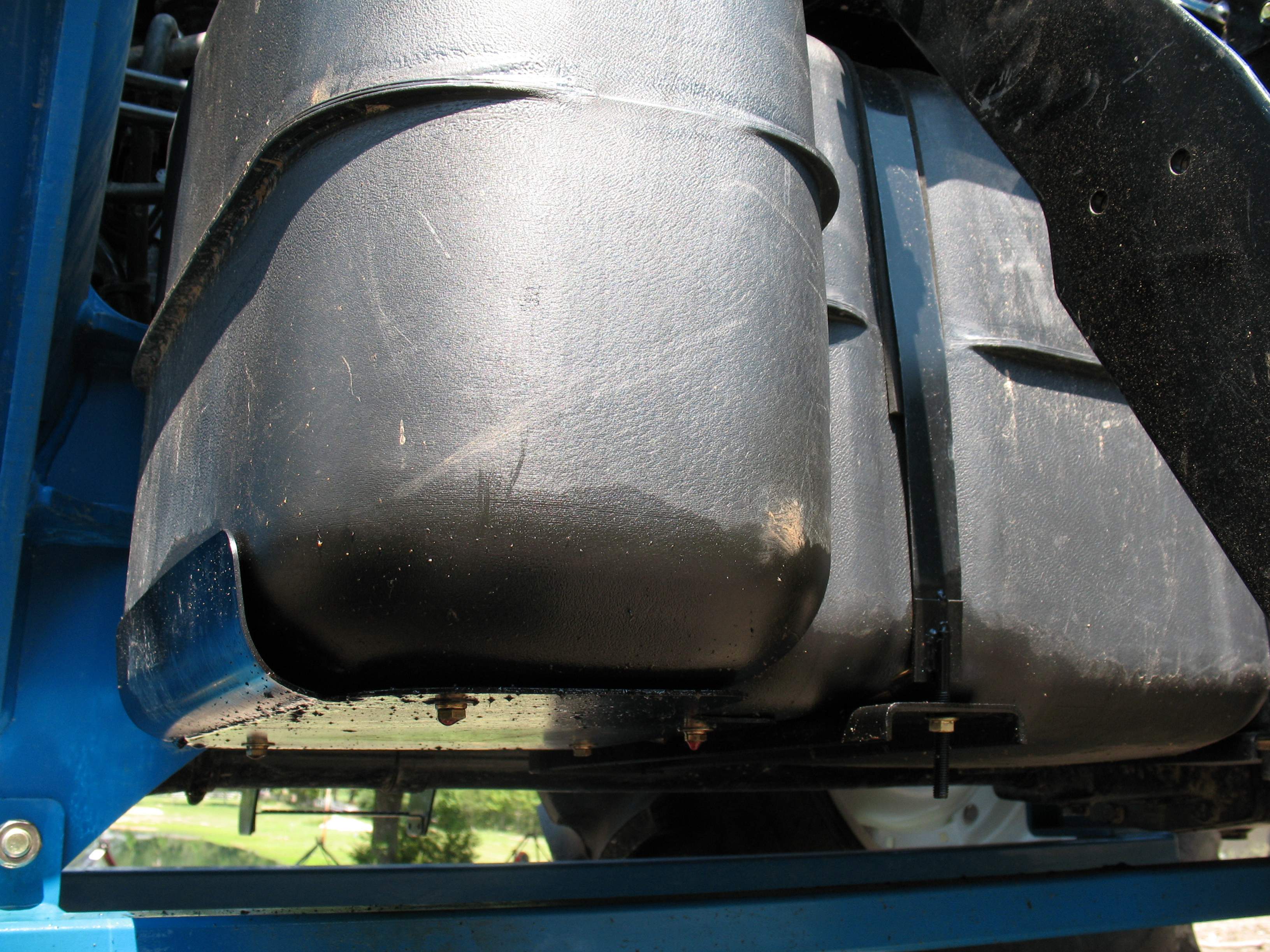

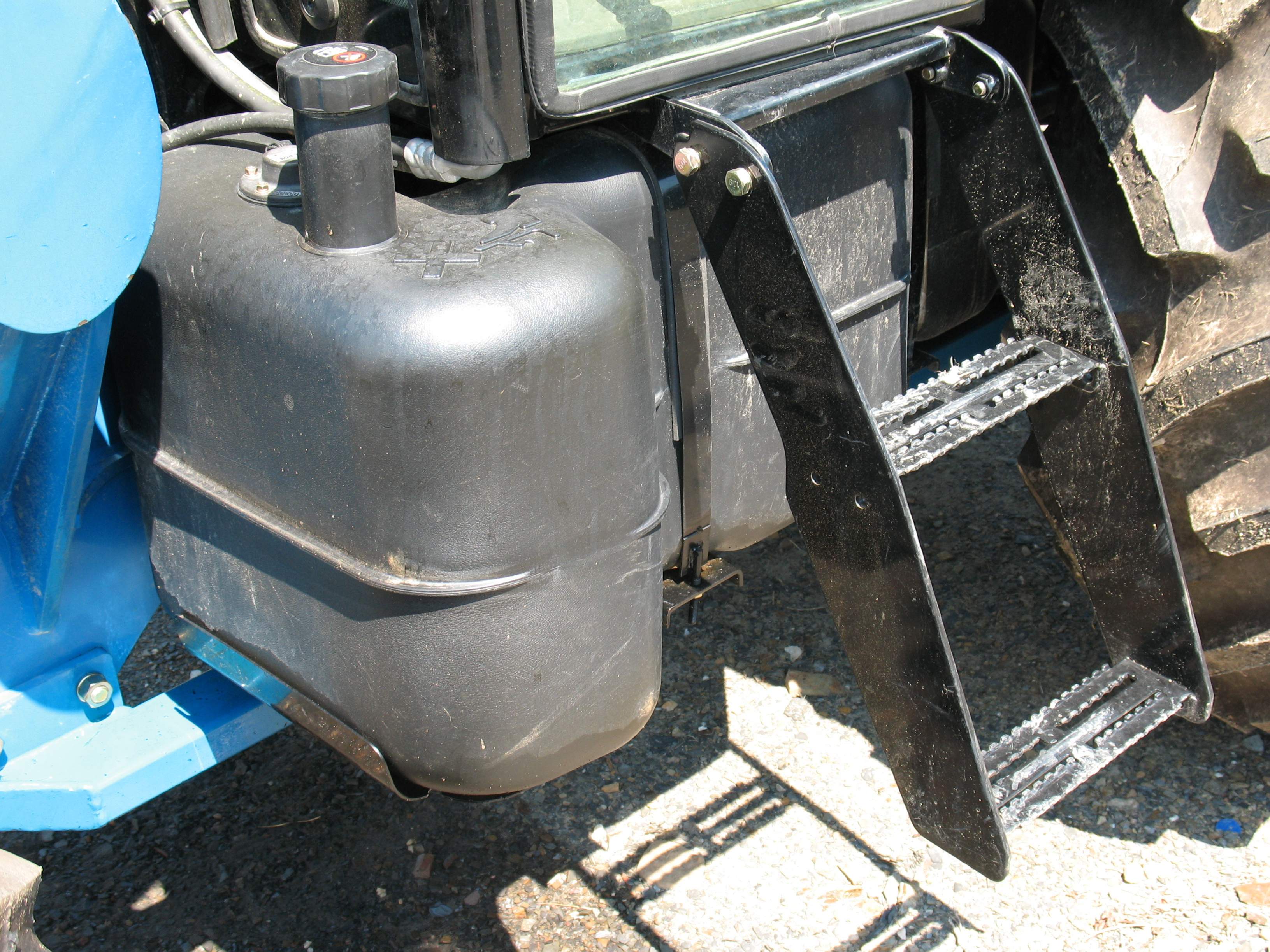

My tank is a little different but the same screws. I can see if hitting the plate on something could stress were they are attached.

Trac, you have the same issue. If it isnt leaking yet, it likely soon will be. Soon as my knee surgery heals a bit more, I'm going to take off my tank and do some mods to the support. May even be able to epoxy up those leaks for temporary fix. It could be months before a new tank gets here from Korea.

Check with your local dealer, the problem is not new. We were shown a new updated mount at LS in February for the "P" series tractors. We had one leak on the U5030 too. The skid plate is mounted on metal studs with a plastic insert in the tank. One bump on the skid and it will leak. If you over tighten the nuts you can crack the tank with the insert. I've not seen an update for the "U" models yet.
