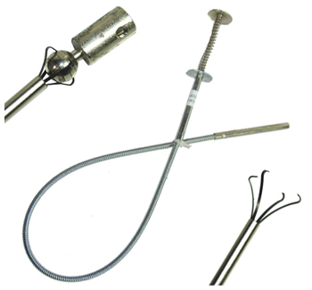

I think this is the tool that johnthomas wrote of. I find it handy in countless situations. Just push the plunger and the fingers extend from the flexible shaft to retrieve an object that would be otherwise difficult to reach.
That's it. It can be handy and if it were longer or if mine were longer I think it would work if I could snag either end of the spout. The fingers on mine don't open very wide.

I did the same thing on my CUT. I went to NAPA & bought the tool JohnThomas is referring to. With that tool, flashlight & some patience the nozzle will come out.
