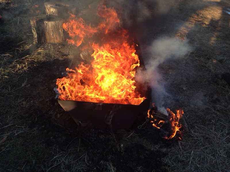

There was much more liquid than I thought in the tank, from watching it pour out I'm guessing 20+ gallons @ 2/3 - 3/4 diesel and the rest nasty water.
So this is what happens when you dump the questionable contents of a used fuel tank into an old loader bucket and set it on fire.
It was interesting to hear the water boiling off as the fuel burned. It was a good time to get rid of the wad of net wrap and trash that has piled up in the RTV.
Also bought a new filter element at NAPA for $16. The wiring is spliced together and looks sh##ty so I'll replace that and it needs a swivel in the fuel line. Also discovered that it is a manual nozzle that must be held. :thumbsdown:
Still thinking this was a good deal over new!
