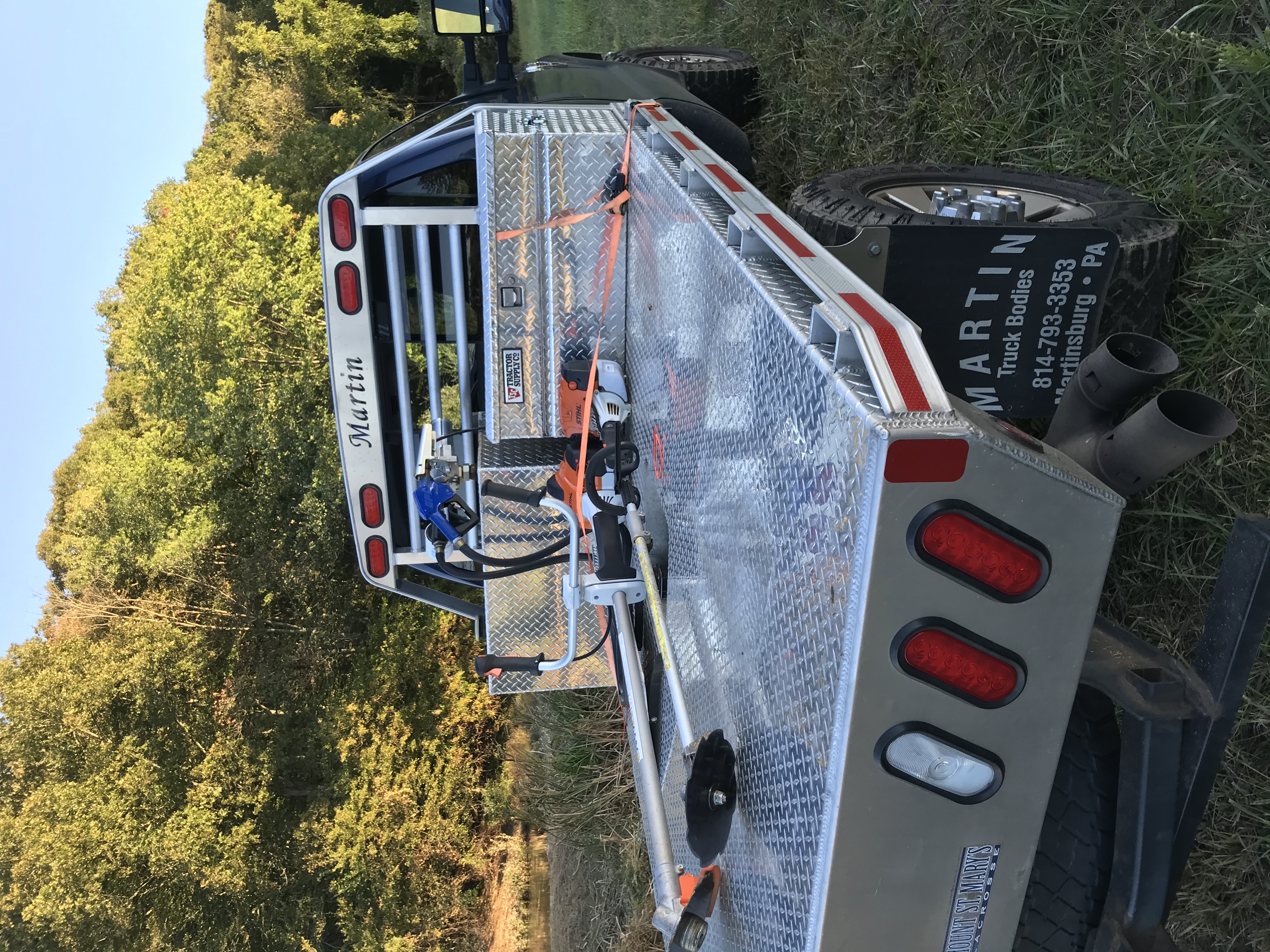

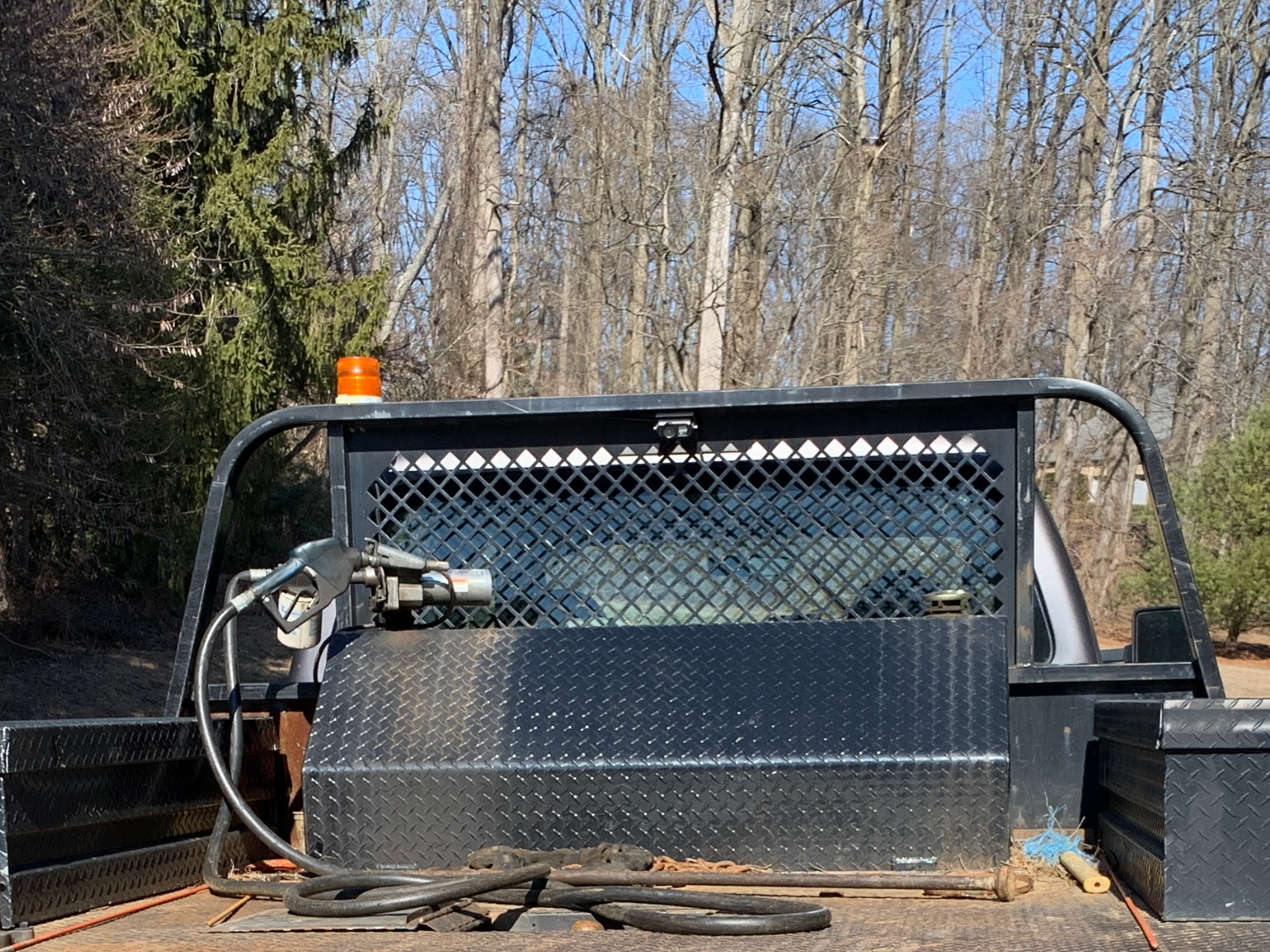

I have 2 GPI 15GPM 12V DC pumps on 2 of my trucks. Never a problem. They are mounted in Dee Zee aluminum transfer tanks. I got them at Tractor Supply.
Putting a 106 gallon Dee Zee and a GPI 20GPM with a 1” hose for my new RAM 5500.

I have a transfer tank similar to HayDude's (post #10). What I found is do NOT use an aluminum pump and I'd question an aluminum tank as well. Actually, the problem is aluminum threaded fittings since the threads eventually deform and start leaking. I've used thread sealant and lock nuts to keep it from moving, but ended up replacing the pump with a cast iron one. I currently have a steel tank and a cast iron pump.
I used to have an aluminum tank for gasoline which worked well because I did not use a transfer pump on it. I had a welded on connection to transfer fuel from the tank to my main vehicle tank via a switch in the cab that ran a holley pump mounted on the frame rail.
So, I guess the bottom line is use steel or if you go aluminum, be prepared to weld the fittings.
