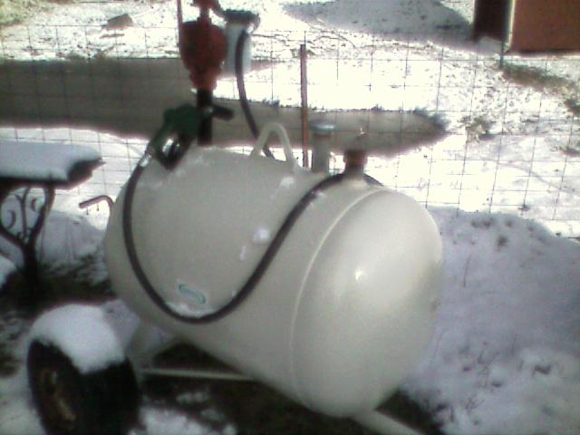

I have a 100 gallon fuel transfer tank and would like to build a small trailer to haul it around on. Anyone have any luck building one?

TS sells all the trailer supplies to fabricate one ... you could do it in under a day once you had the parts

heres my 110 gal fuel tank made from a large discarded propane tank. i cut the collars off the top and bottom and plugged the original hole for the valve, laid it on its side welded on an axle and tounge and 3 weld in bungs on top and had me a heavy wall fuel tank for about 20 bucks in weld in pipe thread fittings

Cory, how's this project going? I'm looking forward to more.:thumbsup:
It's actually operable. Not finished, but operable. I will post some more next week, the trailer is temporarily at the cabin.
