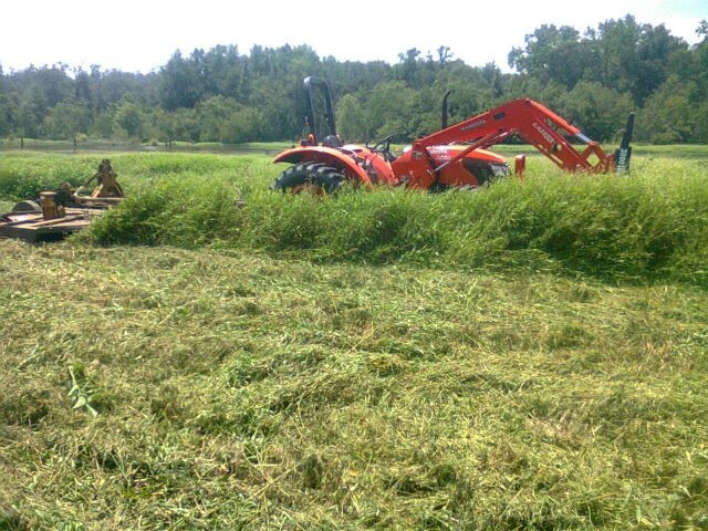

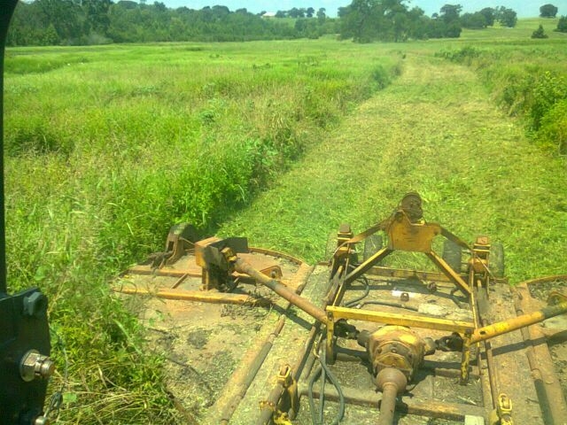

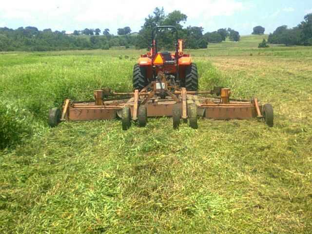

   / Full RPM or high idle? Bush hogging fuel efficiency #109
I had to run around 2500 rpms cause I was using all 46horse's mowing bottum 4.JPGmowing bottum1.JPGmwing bottum 3.JPG
