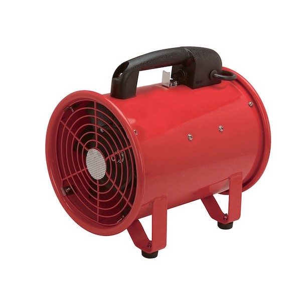

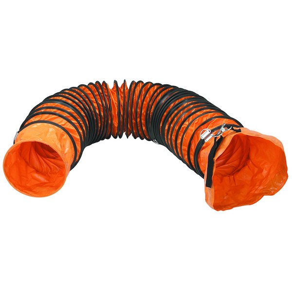

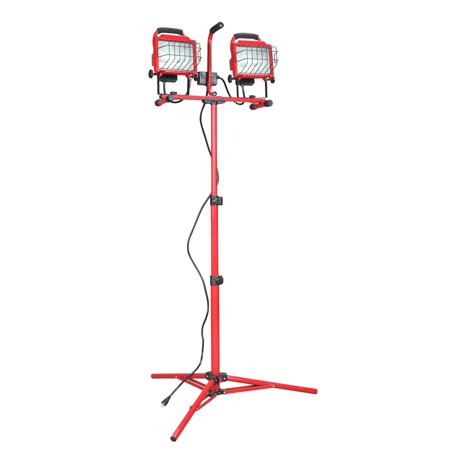

What about rigging up something using these two HF components? Maybe position the ventilator in the window and block around it and then add some type of non flammable filter screen on the free end of the duct and attach to a portable light stand. This will cost about $150. Where am I going wrong?

For safety reasons the motor is usually required to be explosion-proof- totally enclosed fan cooled (TEFC) which costs more than your average blower motor. The blower wheel and housing are also epoxy coated or made of a non-metallic material. Static electricity can easily be created within the blower housing as well as the exhaust ducting which can cause ignition of any flammable gases, vapors, or dust particles in the airstream.
I keep reading about this danger but I see so many people rig up fans to ventilate their shop that are cheap and not explosion proof. But I hear you though! Just wondering for light duty DIY shop type of set up, do you need a $2500 or higher fume extractor?
   / Fume Extractors... why so much? #10
No that's what he's trying to say is that stuff that is marketed for that use is required to meet a list of requirements of osha for approve it, that list requires it to function in situations that you will never create in your home shop.
