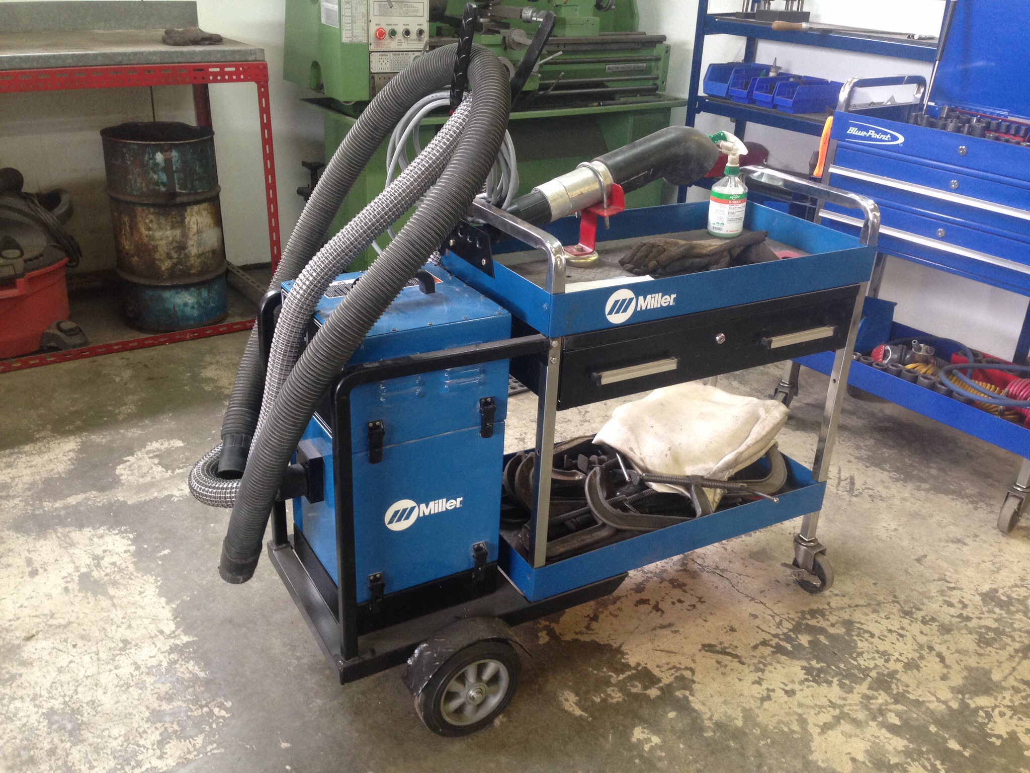

I have Miller's smallest portable fume extractor. It works fine IF the intake can be positioned close to the work.
I bought it "new not in box" for approximately half the regular price, but STILL overpriced in my opinion.
A local welding shop had a job welding some panels at a shopping mall and rented my extractor as part of the requirement of their contract. They said it really wasn't a large enough unit to be efficient but fit well in their work "footprint" and kept the mall management happy.
I was happy as the rental income paid for the machine.
If you're not using a shielding gas, I'd go with Shield Arc's 90MPH winds.
Here's a pic of the Miller mounted on my modded out tool cart.
Terry
