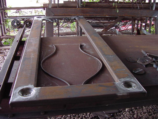

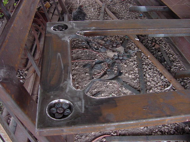

I conned wannabesoninlaw to take some photos for me. I've got this supertrick new tool to bend heavy steel on edge.
Here's a before and after picture. The finished piece is in my left hand and another piece to be done is in my right.
If anyone asked you can tell them a finished piece starts out as half by one and a half bar stock.

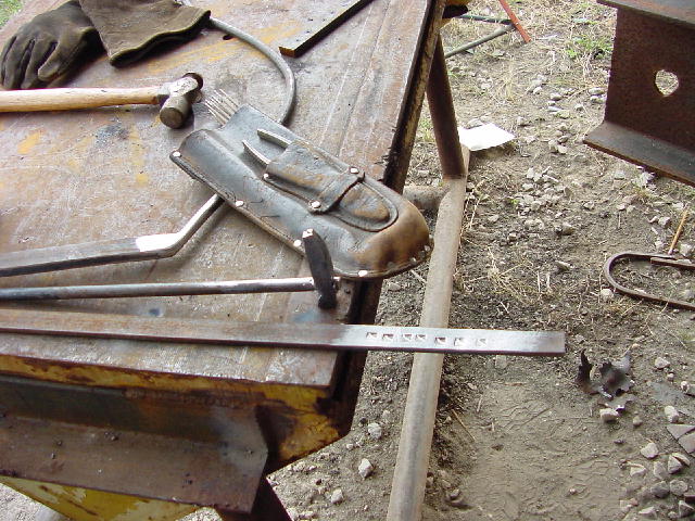

This is the tool. It started out as a piece of two and a half round hot roll that was bent by an uh oh. The bend happened to look like what I wanted for a die.

This is that trick bender getting after it. Half inch by one and a half inch hot roll bar stock being bent on edge or as they say in France when it's spring and the grass is real green, the hard way.

Russ I've got a customer that I do work for every couple of years or so. He's Swiss and was trained to be a machinist from junior high school. He's told me about their first project being done with a hack saw and files to hundredths tolerance.
When I work for him it's by the hour. He's my helper. I can't buy such help. And what's really neat is he enjoys it more than I do which makes me both proud and jealous.
What I think is important about the bender I've got in the pictures above is that you don't absolutely have to have the latest and greatest and trickest and neatest equipment just to do something. Sometimes a little luck and a bit of effort will do just fine thank you.
Few things make me prouder than convincing a willing soul to jump in and use what's at hand to do what has to be done. I mean anyone can do it with the right tools right?

I demonstrated the bender to two different customers this morning. They were blown away that a little man with some kind of belly could move that much metal so easily.
For me it's still one of those things that is almost like magic. BTW I got the idea from a picture of two blacksmiths doing the same thing with a flypress. I don't know why but I figured if they could do it with the repeated applications of a couple ton of pressure I could do it with just more applications of a three pound French hammer./w3tcompact/icons/laugh.gif

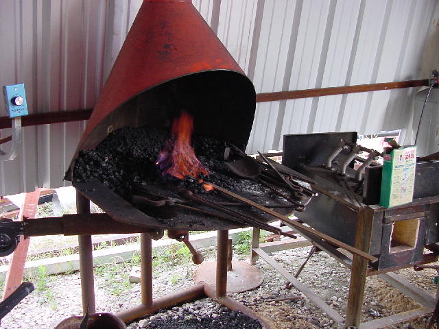

There's a lizard in the fire!
