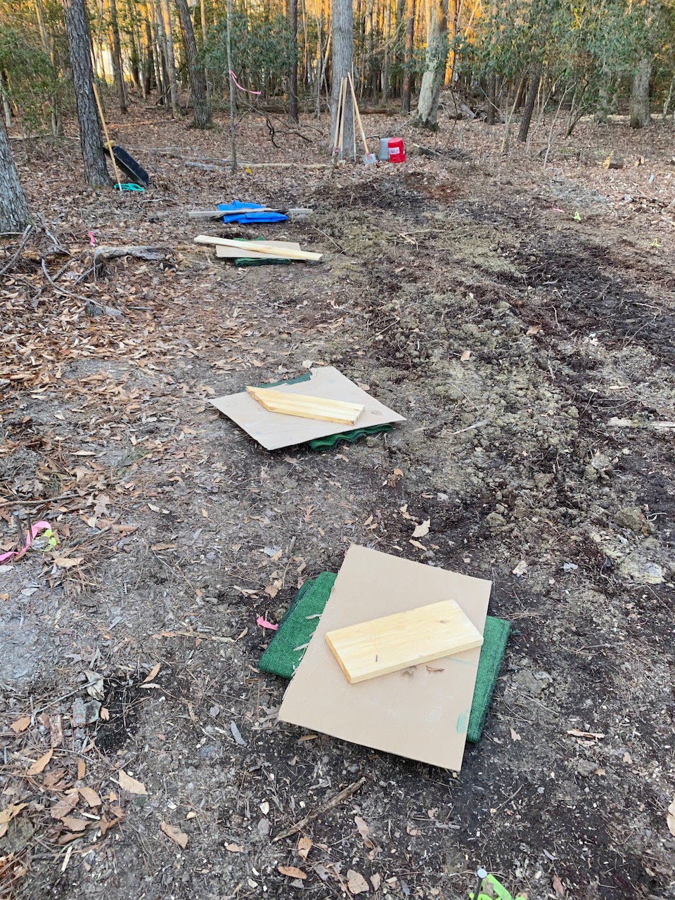

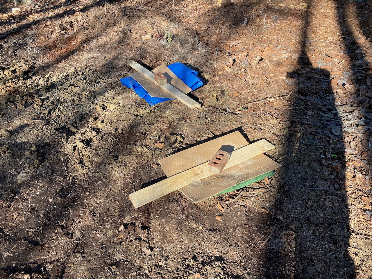

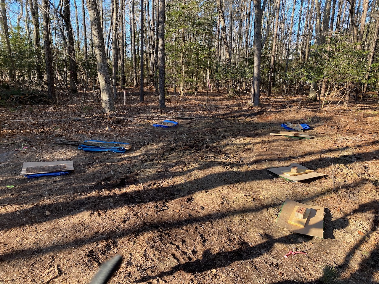

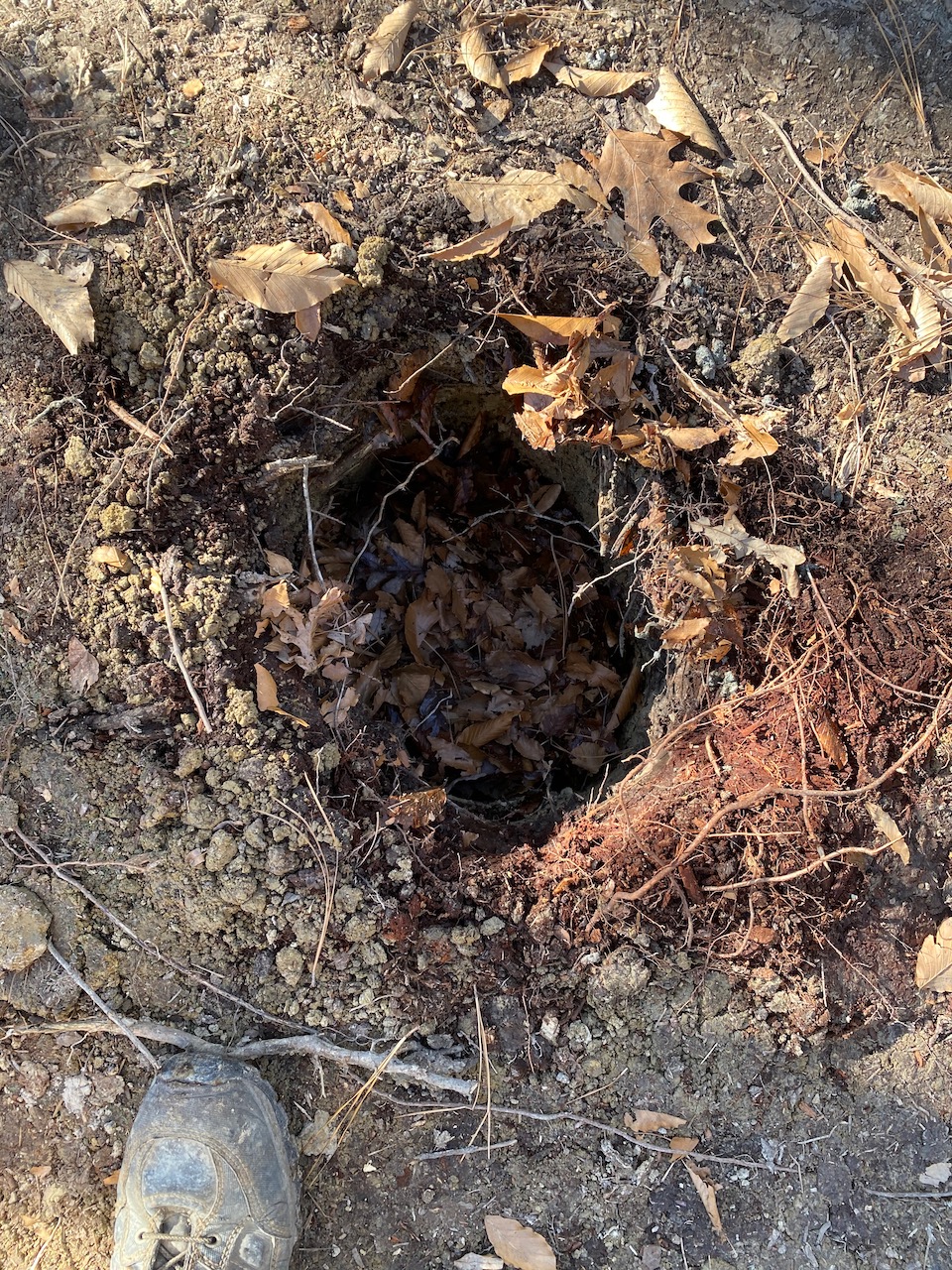

I wanted to post a couple pics of what I did yesterday to protect some concrete pole barn footings from an overnight temperature of 20F. This was based on how we used to layer hay over the top of winter concrete pours back when I grew up in New England.
First off, these were 28-32" below grade, which helps a lot (our frostline here is 12"). Due to a rainy year, these holes begin to fill with water as soon as they are drilled, and that eventually covers the concrete -- which is OK for the concrete, but drastically slows the cure time. Because of that, the concrete needs extended protection.

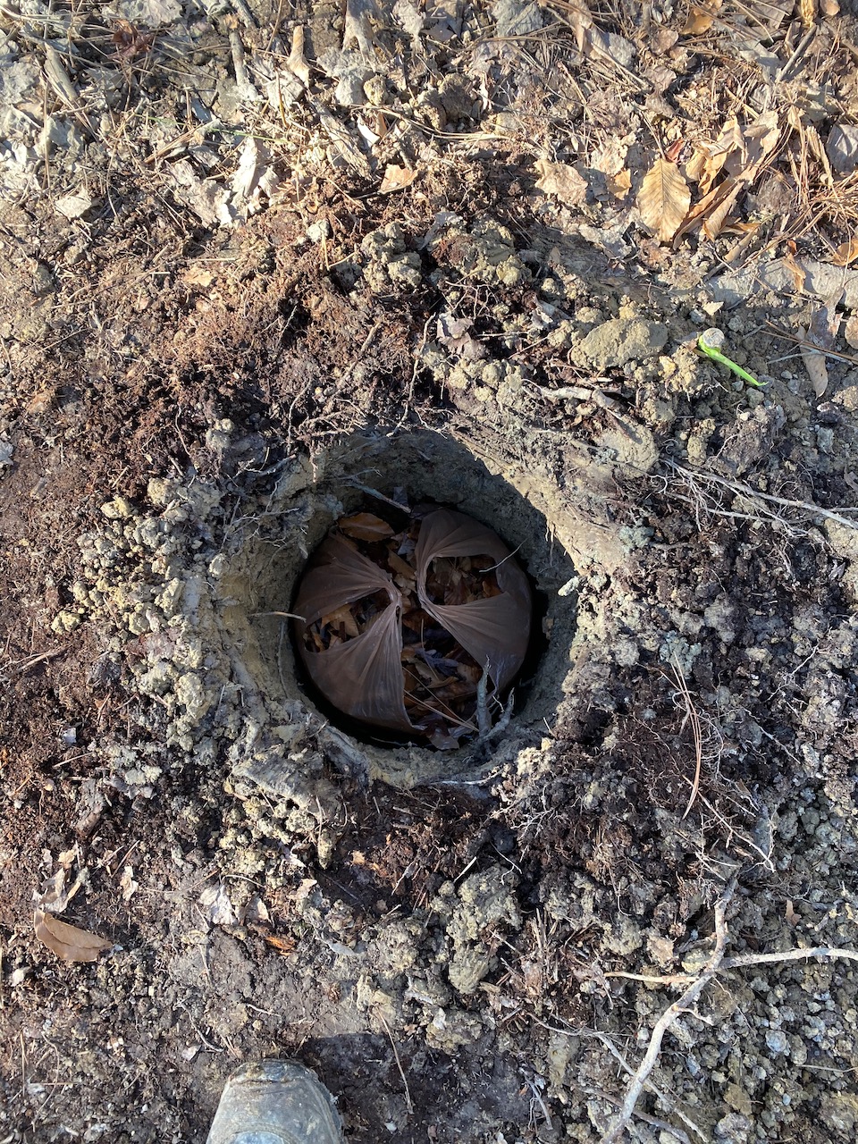

After I poured the concrete, I placed a plastic grocery bag full of leaves on top of the footing. Then I dumped another handful of leaves on top of that to fill the hole about halfway.

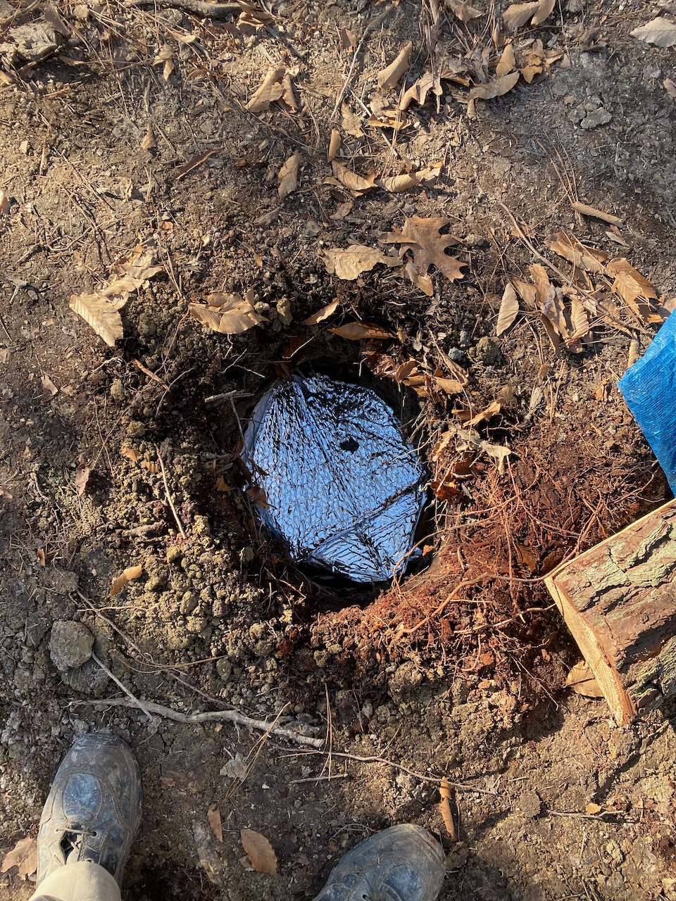

On top of the leaves I placed scrap radiant barrier bubble wrap (comes in frozen food shipments my wife gets periodically).

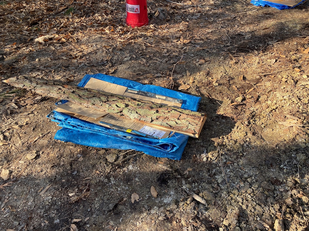

Then on top of the hole is another layer of radiant barrier, a thick layer of scrap carpet or folded up tarp, a piece of cardboard, and a piece of wood to weigh it down.
I've use this method down to 20F temps and it has worked fine. I think having the concrete so far down in the ground makes this a lot easier than if it was a slab or shallow footing. Really, all this method does is provide a couple buffers between the ground temperature and the outside air temperature.
