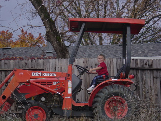

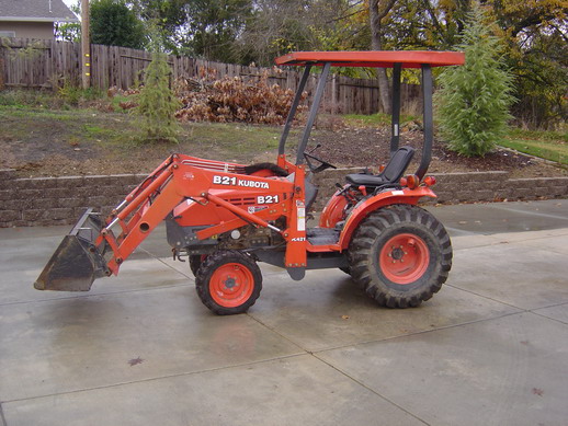

Finally had a chance to finish up the job. Once the subframe was installed the rest went really fast. Put the loader back on and the ROPS in less than 1 hour. Then another hour to put the fenders and tires back on.
Then the true test, no hydraulic leaks, went into every gear, pto started, 4wd worked.
The only issue I ran into was the differential was locked, but after pressing the pedal a few times it came loose.
All told took about 8 hours to disassemble, 12 hours back together, and 3 weeks waiting for various parts to arrive.
merry xmas -yubby

   / Fun with a B21 Differential
#33
See attached picture for smiling operator!
cheers -y

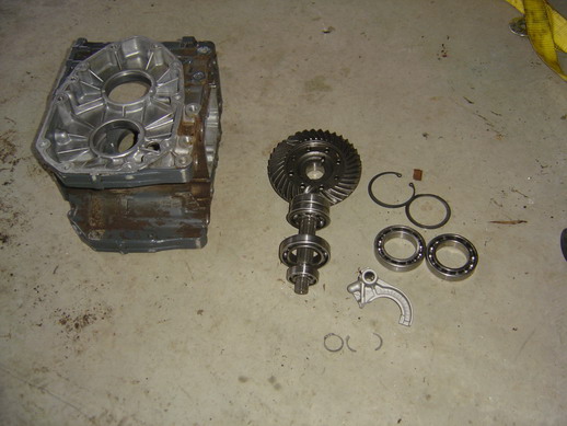

It looks like yubby has not posted since 2012. If I may ask, how many hours on your B21 and what is the work history of it?
   / Fun with a B21 Differential #37
I was afraid Yubby might be available! It has 1500 hrs on it and I知 not sure of the history. I think I might have caused it by being pretty rough with it. it seems to be a weak point. I busted my differential case as well. Oh well, live and learn.
   / Fun with a B21 Differential #38
In my case, it was parts of the transmission breaking off internally and getting into the differential gears. My full rebuild is posted.
   / Fun with a B21 Differential #39
Oh great, I have about 1600 hours. Tick, tick, tick,,,,
I am not hard on it but the previous owner could have been, I do not know.
   / Fun with a B21 Differential #40
One of the failure modes is to force the range shifter and break an internal part. I think an owner who cares (not a renter) can avoid this behavior. It is interesting that many/most CUTs don't shift ranges easily since the gears are often straight-cut, and sometimes under small loads.
I think the B21 is a good tractor, if somewhat under-powered, and with a weak 3-point. Many of them are in rental fleets.
