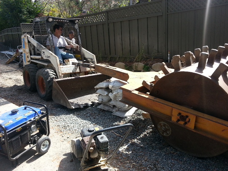

A customer of mine sent me this pic last week telling me he wanted to be able to push it with his Bobcat skid-steer.
I had no idea at first how I was going to accomplish it. This is what I came up with, though my first thought was to weld it to the bucket.

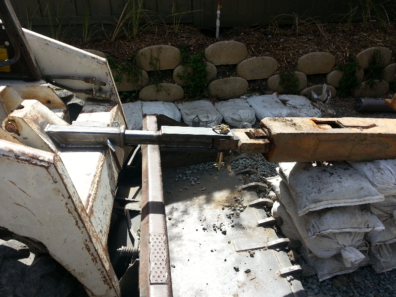

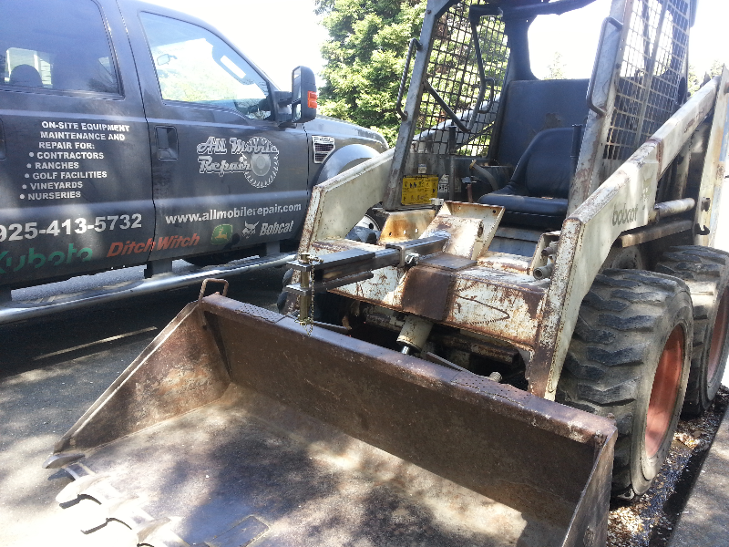

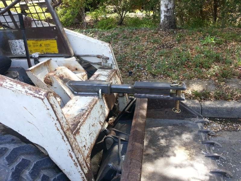

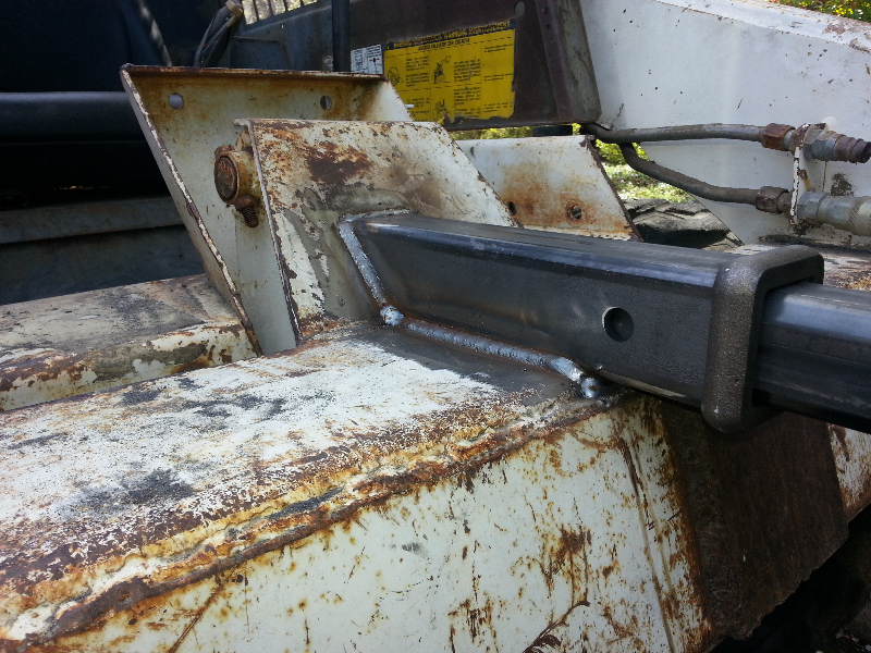

Here are more pics.

And another, my phone app keeps crashing.
I think it turned out pretty well, the customer was very happy.

Nice welds. Attachment looks like something from a horror movie...
/ Fun with implements #8
I bet he will soon want a tongue jack on the roller, too. It looks heavy :)
Bruce
#9
I bet he will soon want a tongue jack on the roller, too. :)
Bruce
Yeah, we already talked about that, probably when I'm out there in the next couple of weeks doing some other work.
/ Fun with implements #10
That looks like an awful big load for the skidsteer as the weight has a lot of inertia. How does it handle it?
#11
He drove it a little while I was there and seemed very happy with how it handled.

Yeah, there is hardly a flat spot on his property. He's in the process of replacing 600+ ft of driveway up to his house. He should get good use out of that roller.
/ Fun with implements #16
I don't even want to think about what would happen if that broke off facing uphill! I can't imagine how it turns, since Bobcats don't have steer wheels.
#17
He keeps the roller downhill. I watched him back it up his curvy driveway. It really seemed to handle it just fine. It pivots on the pin and steers without a problem.
#18
I did send him a text this morning recommending that he definitely keep the roller downhill and though I have faith in my welding, if something were to go wrong I'd rather see the roller in his neighbor's pool, than having it harpoon him.
Brian
