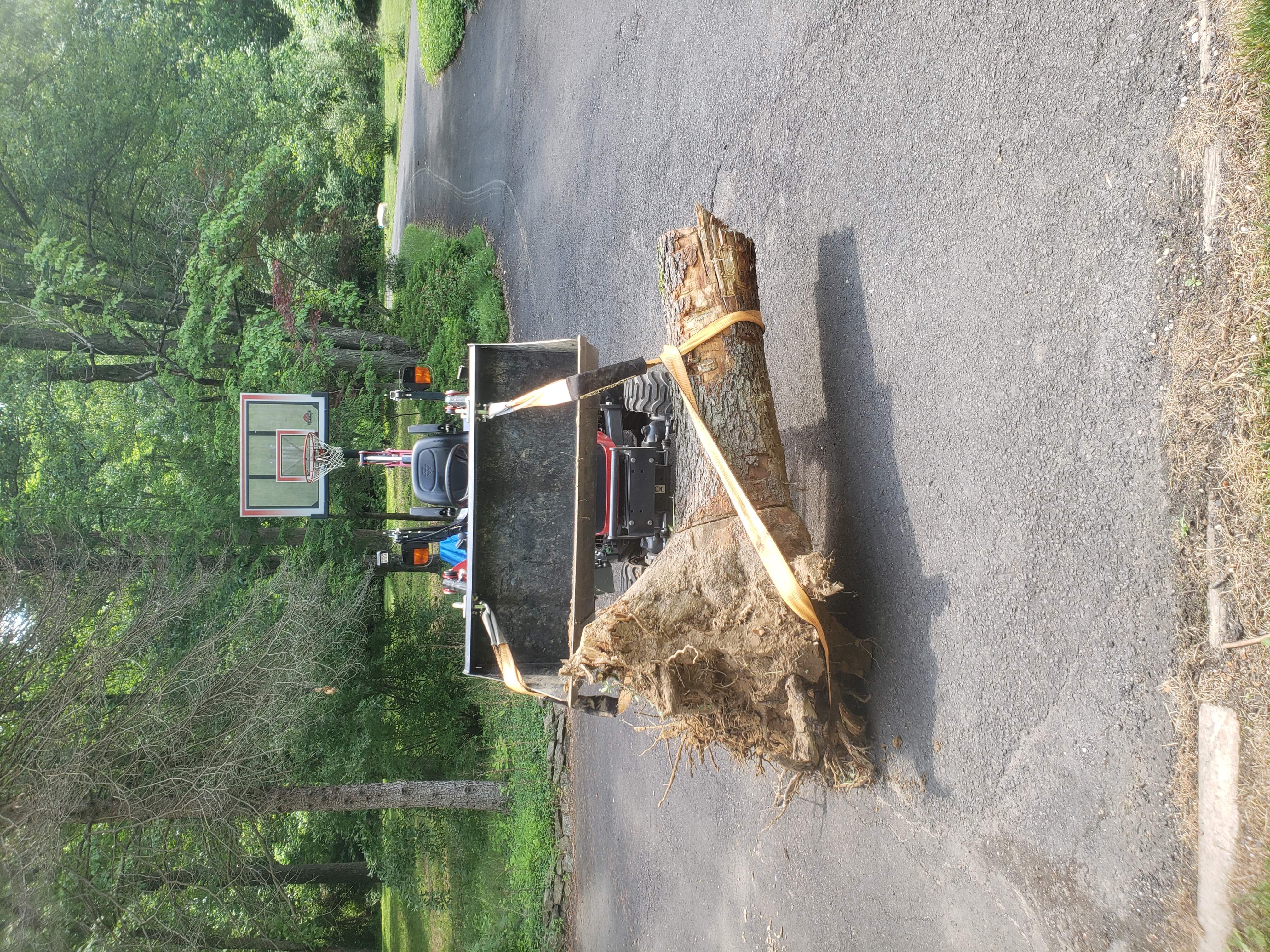

I have a SCUT and have pulled out stumps up to 24" using the BH and a Sawzall. BH to dig out and cut smaller roots. Sawall to get through the bigger stuff.
Took me 3 tries for an 18" cherry, heavy enough that I dragged it out since I could not lift it.
I am probably 20 or so stumps on and have 2 stump graveyards, Stump20200620_122537.jpg
Patience works in this case, my BH still looks perfect as I don't over stress it too much and try not to go at an angle, seen too many people bend their rods try to lift at an angle, or worse, torque the boom.
