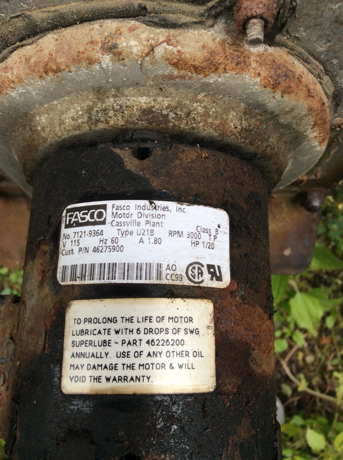

My furnace has a power vent exhaust that has a fractional horsepower motor on the outside, north side of the house. (Subject to -20F on start, but quickly warms with furnace exhaust). The manufacturer has some pretty specific oil requirements, and dire warnings if you don稚 buy their brand. They spec a SWG Superlube 46226200.
Is this something special or is there a readily equivalent instead of waiting a week or two for it to arrive.
I have the exhauster apart right now.View attachment 573741

yes The new 90% furnaces vent with pvc. the exhaust motor comes in the furnace.
I use to install fans like you have on 80% furnaces and use metal pipe with the joints sealed.
On these systems, the fan draws the combustion products to the outside the home, But I have always mounted these fans on the interior wall. Never outside
The newer 90% furnaces that push the flue gasses to the outside through PVC and are under a positive pressure
On the 95% units, the blower does much more than simply help the exhaust escape. It throttles the burner and feeds it the gas/air mix. It also draws the combustion air in. The entire operation is dependent on the fan and it has to be inside the unit. All venting is done through glued joint PVC. Not likely to leak.

Yes, this is a very good choice, provided it will still pour at -20 degrees. Not sure about that.

Yeah, If the exhaust motor don't run, nothing runs. Just giving the simple explanation.
I have vented them like his too, but never installed the fan outdoors
