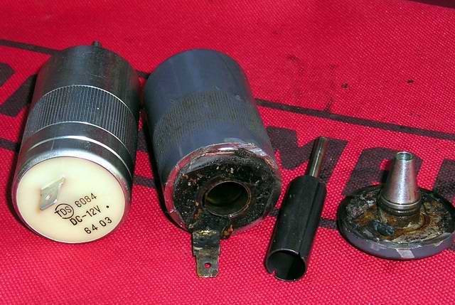

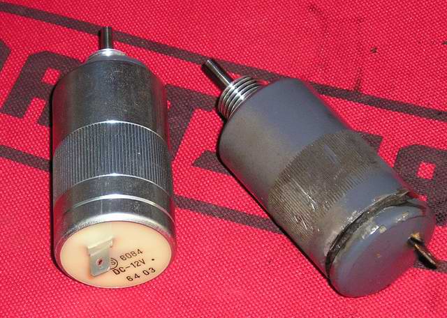

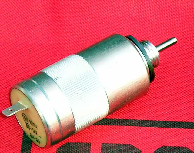

Here are some pictures of the new and old solenoid. On the new solenoid, you can just see a gray washer on the threaded end. It contains an o-ring that seals the opening when screwed into the injector pump. Evidently, the valve inside the pump is surrounded by fluid. In the third picture, you can see the internal o-ring on the cone shaped piece I cut off the back of the solenoid. That keeps the plunger sealed at both ends.
There is an internal coil spring missing because it went somewhere in my garage and I haven't found it yet.:rolleyes: You can see the spade connector is burned and so is the potting compound. It stinks.
I checked the new solenoid with my voltmeter. It is exactly 12 ohms through the coil. That means it should only pull 1 amp. Even I can do that math.:)

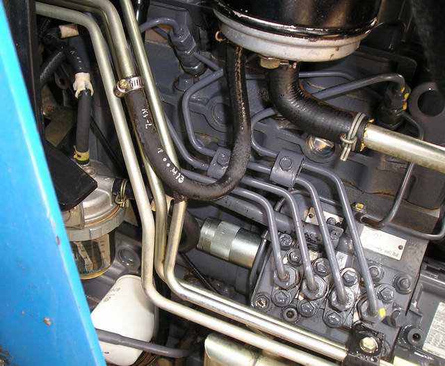

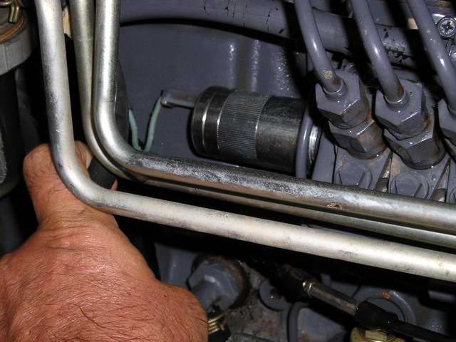

Here are pictures of the solenoid installation. I removed the top two hoses to my FEL so I would have more room, but that's all I had to do. You can see just how easy it was to replace the solenoid.
...and it works great. It only gets warm to the touch, not hot. I mowed all day without a problem. I think I can put this problem to rest.:)
