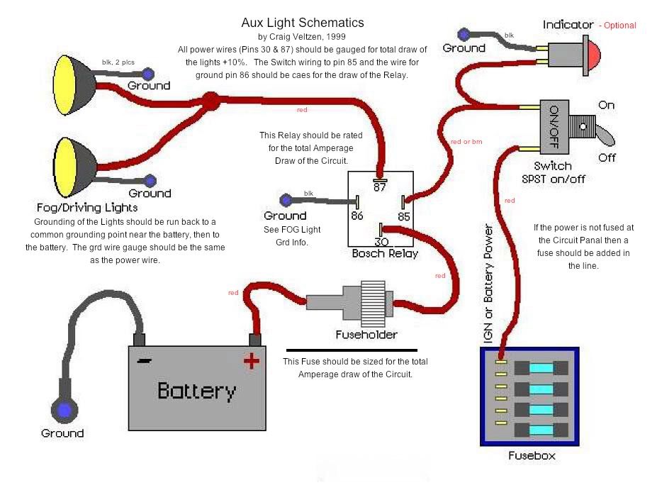

The idea of using a relay is to keep the higher current flow outside of the cab or from under the dash panel, in turn reducing any chance of causing a fire.
I know you guys are up on all of the LED Lighting and the need or not for a relay but if your happy running 10 amps thru a switch, no matter what the rating of the switch is... Good luck.
Here is a schematics I have passed around, luck to Ya no matter how you do it !
