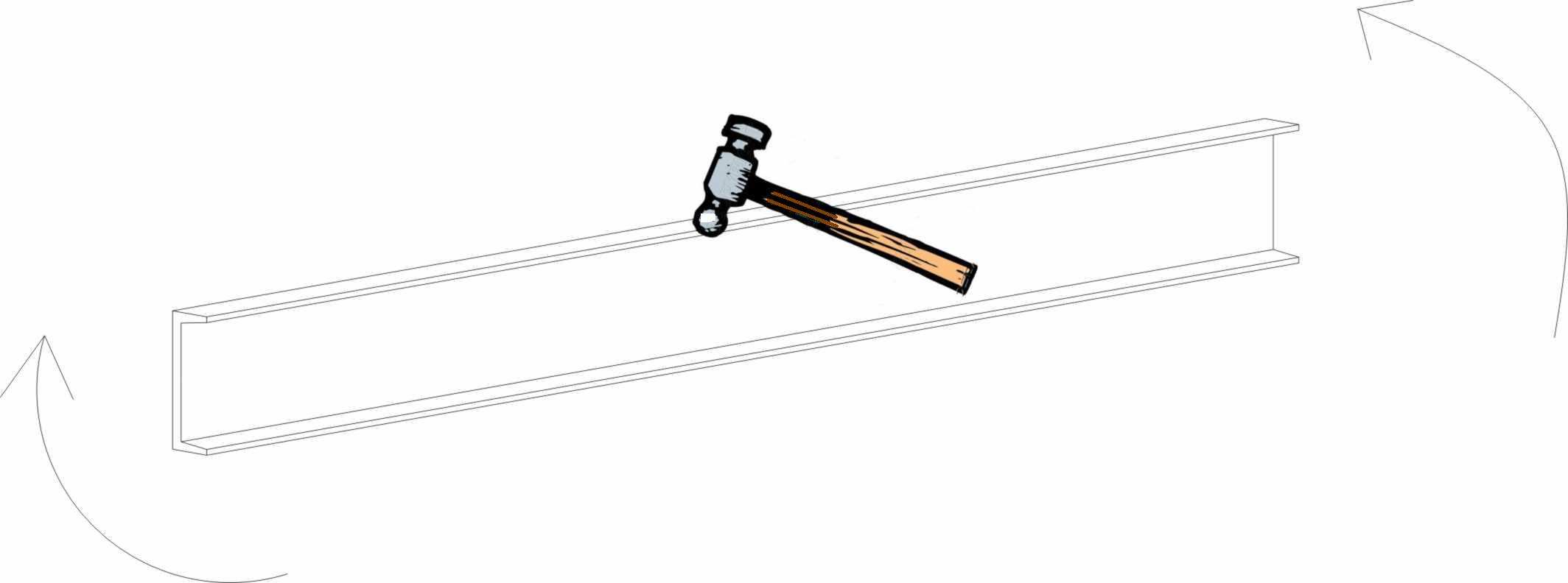

Its funny you mentioned controlling and correcting warpage and have the Ball peen hammer as I have seen many a "welder" use it for such.
Take a ball pein hammer and say a 10-lb sledge hammer for a dolly and you can straighten a section of C-channel, by beating on the toes of the C-channel.
Thanks!,
Ive never heard of that being done before with a ball pein, just another sledge, Does it take a good lick with a ball pein to start to straighten it out?
Yes you have to beat the dog sheet out of it!
I really don't like that method, because it leaves dents in the toes of the C-channel. But without a strong back and hydraulic jack how else can you straighten C-channel in that direction?:confused3:
