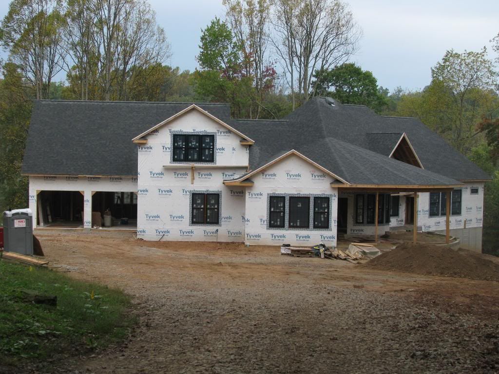

I built my three houses acting as my own GC in 1991, 2000, and 2010 ( the last one paid for itself). I would not do it any other way. I purchased the land, obtained all permits, bought all materials, arranged all inspections, bought insurance and did quite a bit of the work as a laborer where I could be useful. I am not a contractor or engineer but know how to plan things and hire the right people.
First and foremost, understand that you assume all risk. By that I mean make sure the land is approved as a buildable lot (wetlands, zoning, flood zones, drainage). And beware the possibility that animal habitats such as frog environments or vernal pools can give you a great deal of trouble and even halt your project. I made an offer on the land contingent upon 1 obtaining a building permit, 2 obtaining a septic permit from the local healtlh jurisdiction, 3 any extraordinary blasting requirements. That said, once the seller agreed to the offer, I immediately hired an excavator and soils scientist to assess soils and design a septic plan (about $900 for all), went to the building and zoning departments to ensure there were no problems based on zoning or encroachments. Now, knowing there are no big surprises, I proceeded with the land purchase.
Now you can put your plan in place. Key people really are the excavator and concrete guy. Concrete guy will price based on your plans, excavator has to walk the site to determine layout, shaping the property, drainage, driveway, etc. Once you hire these two contractors, insist that they meet on the site to ensure they agree on elevations and locations.
Once you're out of the ground, the stress seems to diminish, at least for me it did. Coordinate other underground stuff like power supply ( find out what power company, phone company, and cable needs for trenches or conduit). Start this early because utilities work on a slower schedule. If you have to cross a road with utilities, especially underground, it costs a bunch. Well driller can come as soon as concrete walls are poured so coordinate trench with excavator.
Lumberyards, electricians, framers, insulators, sheetrockers, painters, plumbers can create their bids based on plans. I called usually 3 of each unless I got a strong referral from friends. (I was new to my current area and did not have a lot of contacts here---- at my original home state I knew by word of mouth who to hire and not hire).
The rest is planning coordinating. On this last job, plumber and electrician got started as soon as roof and windows were in. They arranged inspections with town inspector ( they all know each other). Insulator was done in a day, sheetrockers were done in a week.
Now I had a building with electrical service and dry with heat running ( subfloor radiant heat) to do my painting, flooring, cabinets, doors and trim and basically finish the job.
Mind you, I built these houses and worked on the road, most of the week I was in hotels, so it's doable. I had confidence in the people I hired and just kept everything moving.
I know GCs that build a great house but I prefer to use my own specs. Call me old fashioned, but I do not like the floor truss systems in use today--- bouncy but fast to install. I insisted that my plumbing be copper pipe as I refused to use PEX (again, my preference).
From start of framing, I usually moved in within 4 months, with some work left to do but still comfortable.
I won't build another house only because I won't leave my present house on the hill-- this is my last stop.
