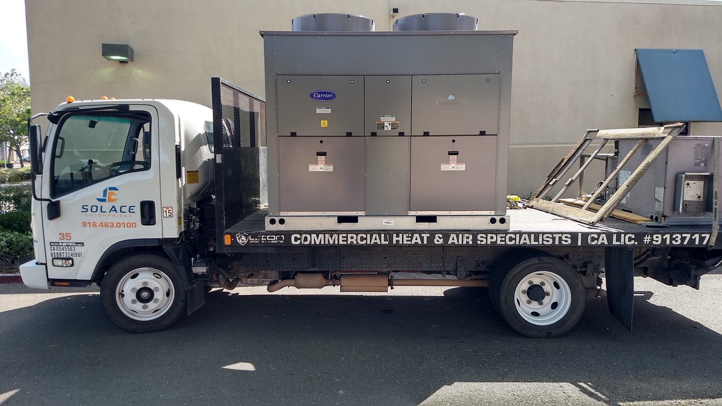

Yes… referral from our sister facility about 100 miles away in Sacramento where everything has A/C
The unit was damaged loading and never left the yard in middle America.
It’s 410 so if it lasts through our new 15 year commitment here we will be good.
Also having a small Carrier gas pack package unit replaced in the middle of the building since crane will be onsite.
The company was very detailed and 2 men did the site survey and found my crane recommendation helpful… same that installed in 1995.

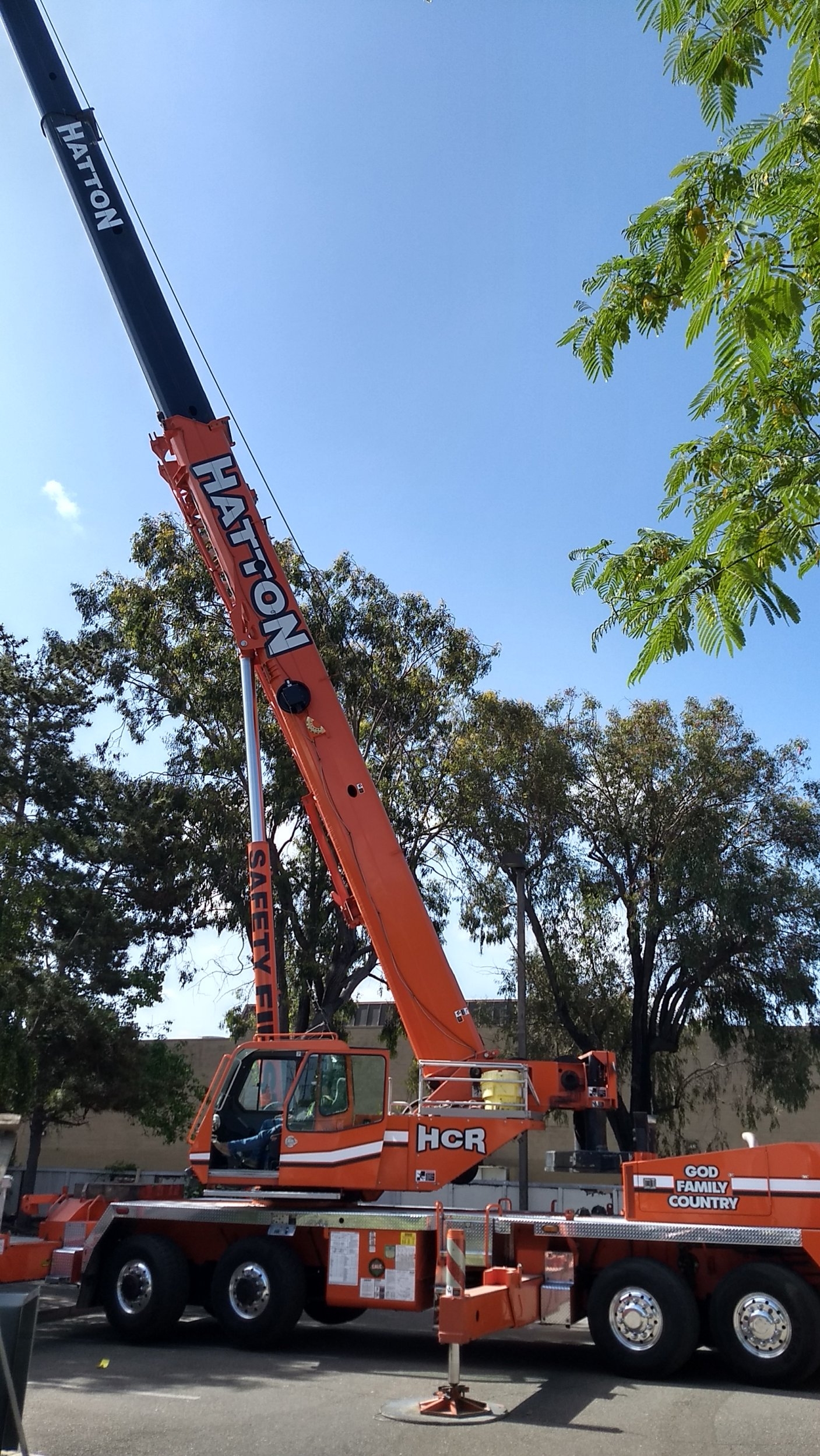

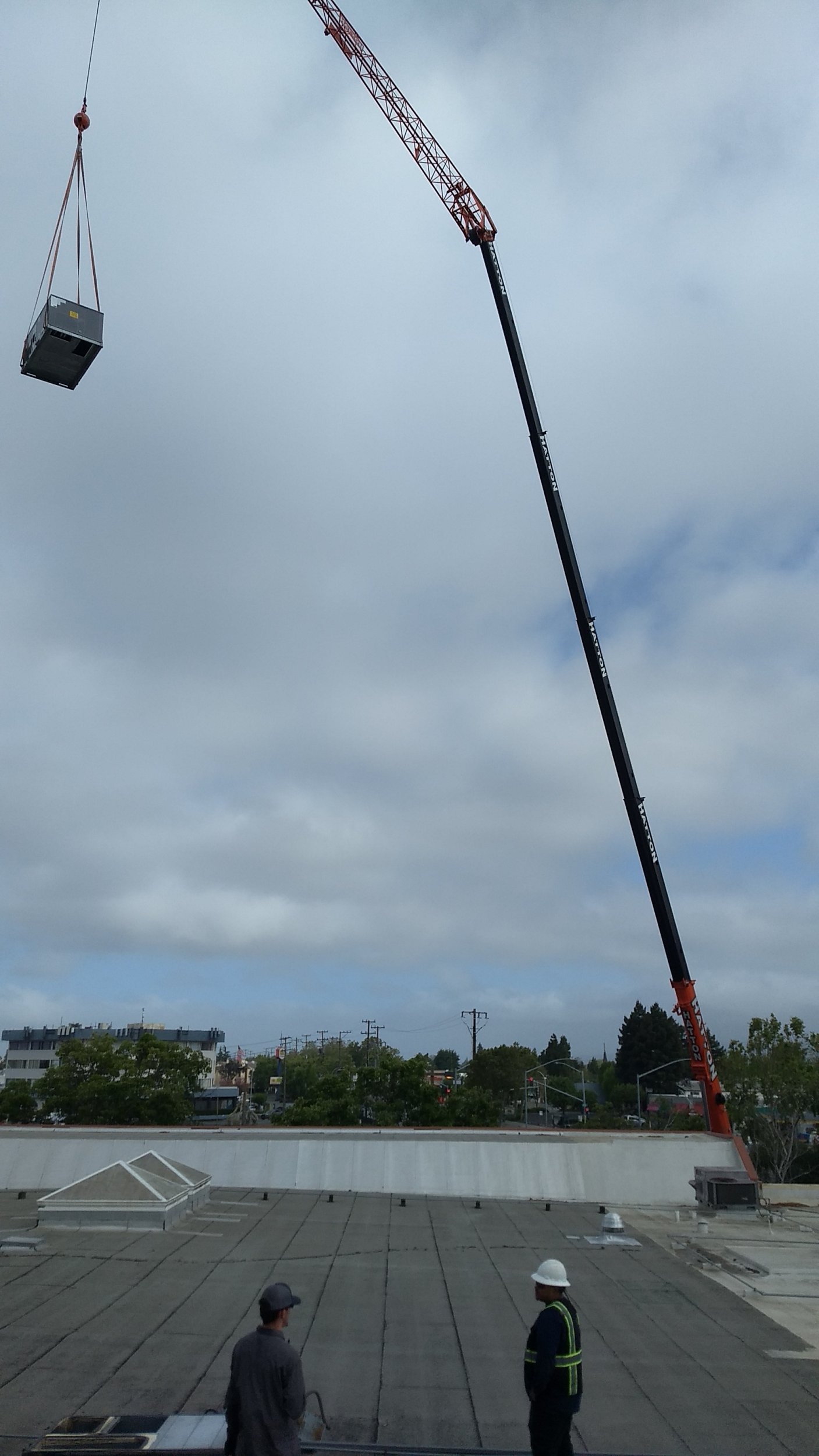

A long time coming and being that the original unit damaged in transit the timeline was extended...
Ordered a 100 ton crane for the pick and so far all is well...
The large crane due to the significant reach…

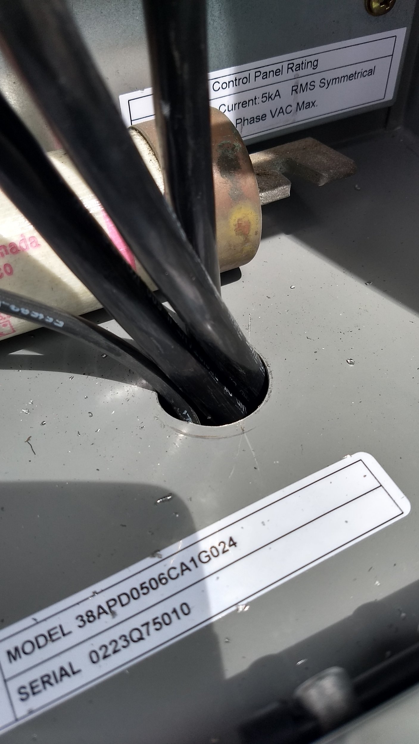

Have a glitch with the new Carrier unit as it shuts down every night for 2 nights in a row.
Because of the environment the original unit had Hot Gas By Pass… this one does not nor does it have vfd compressors…
Tomorrow Hot By Pass will be installed…
I am the first to admit I have much to learn but I know my building as I was part of the original design team in 93-94 and Hot Gas By Pass was essential being that the cooling is required down to 53F outside ambient air temperature…
The lead from the company installing is very receptive and knowledgeable as he is the one that has to make it all work…
Realizing it’s in process I still gave him my punch list and we went over all items and one he even took a picture because he missed it… 5 guys on the weekend didn’t have the luxury of open supply house if something needed and it had to be operational.
No bushing protecting 480v 3ph conductors passing through rough jagged sheet metal.
A 480v short on a 125 amp circuit is not a problem I want to have!

That’s a good catch. The extra fuse in the bottom won’t help if the feeders blow.
