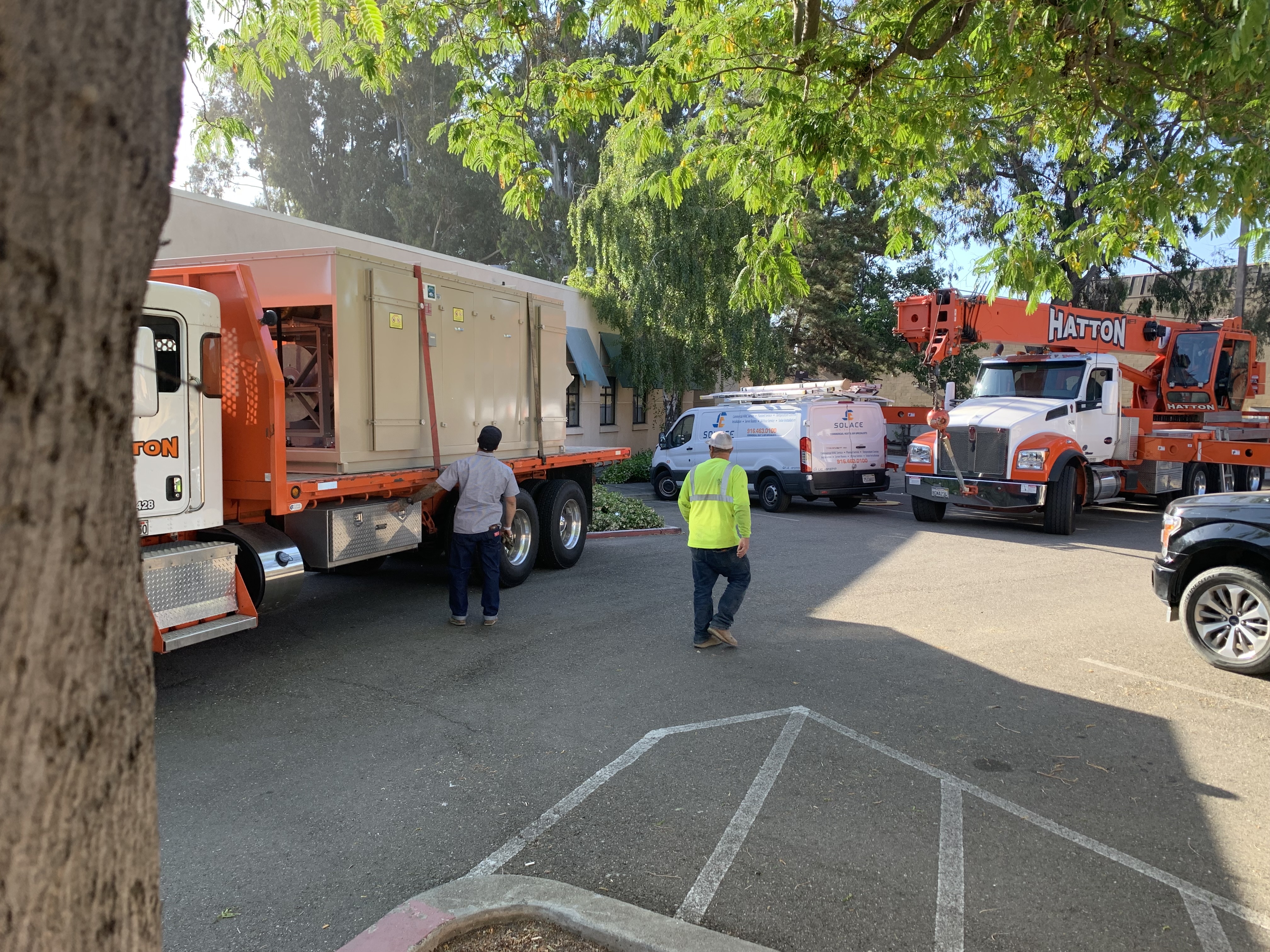

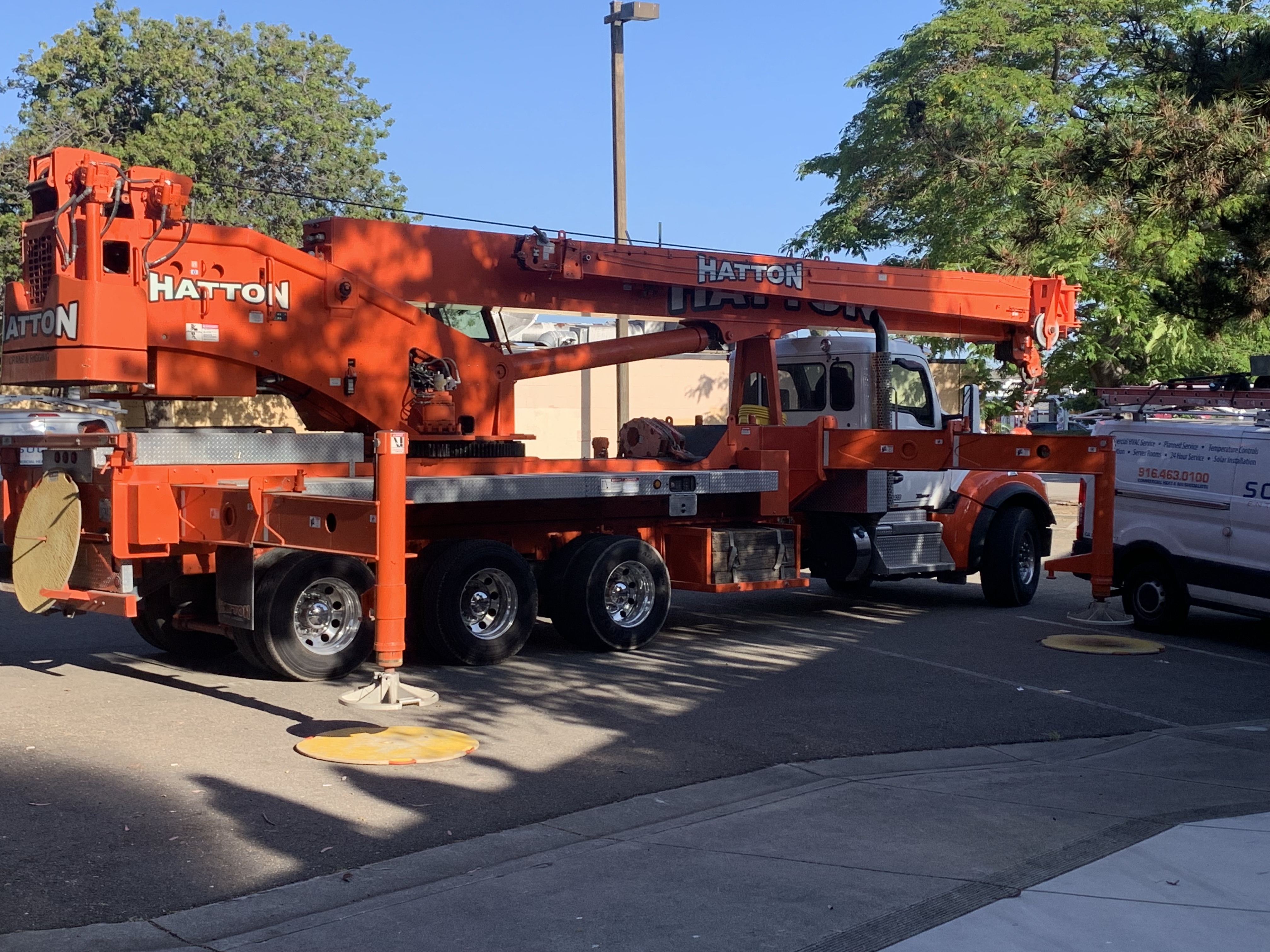

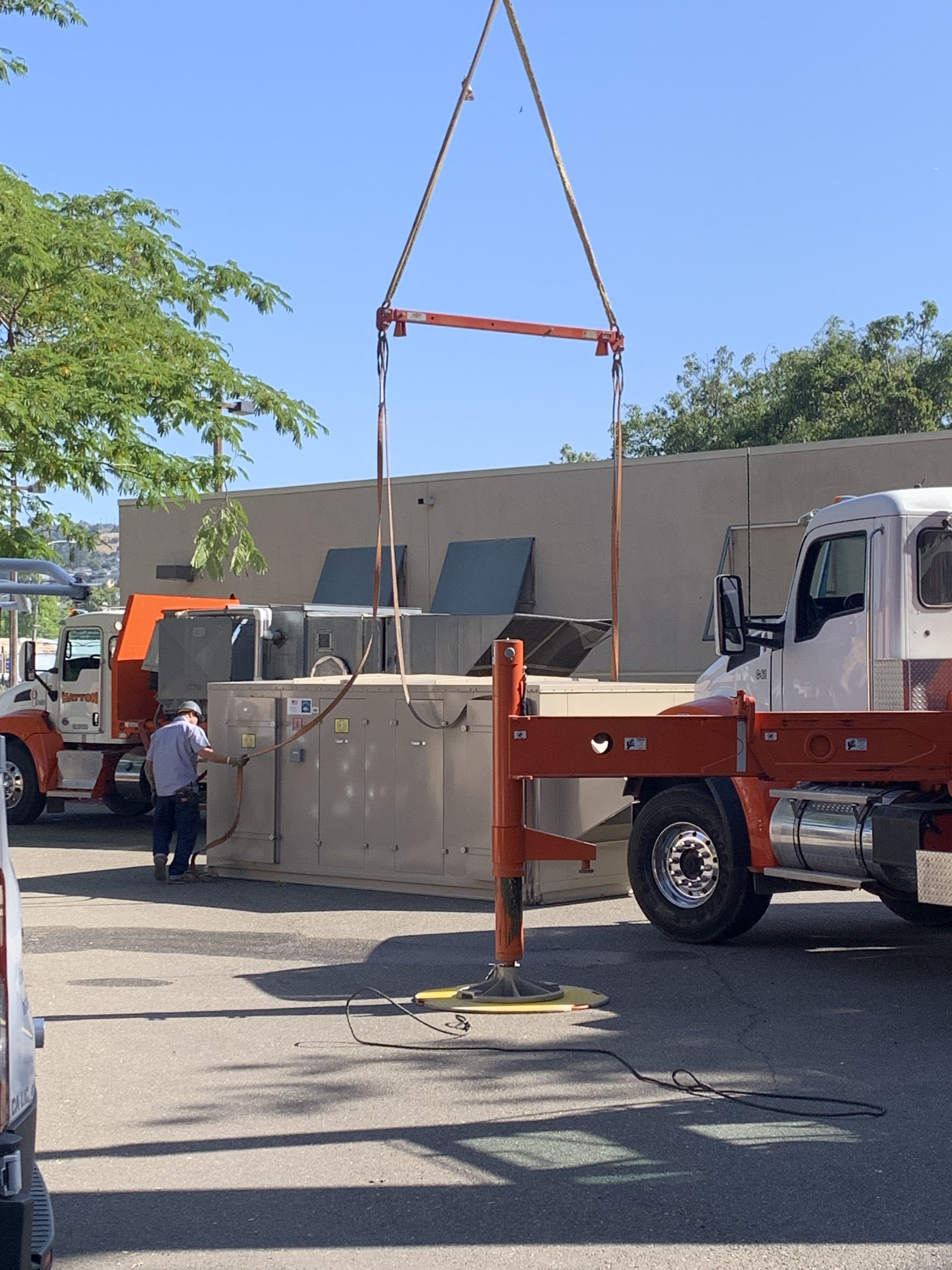

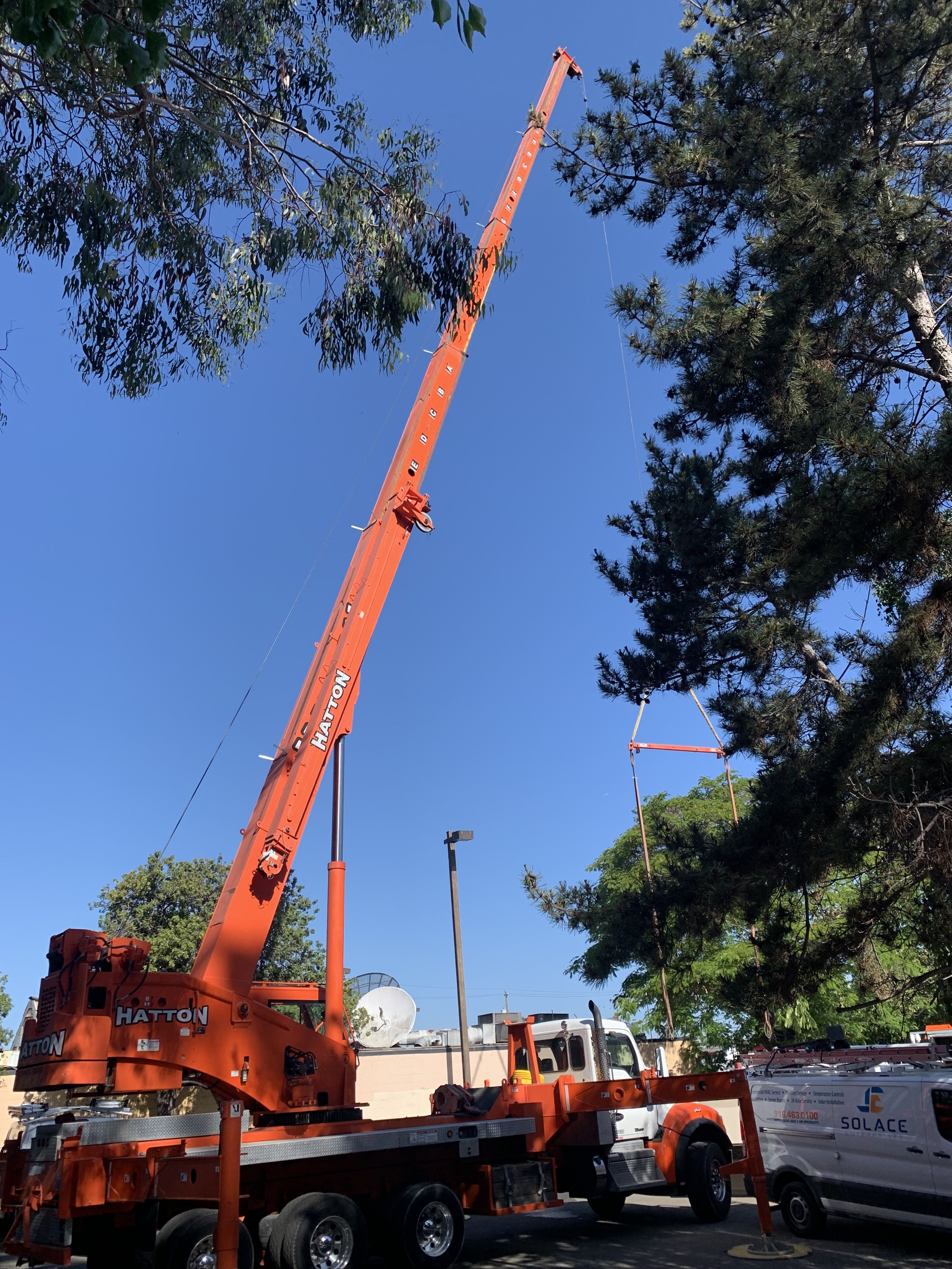

Weekend Work
Air Handler Replacement for operating rooms…
New unit uses already obsolete 410 refrigerant…
The old unit has been in service 30 years 24/7 with a Baldor motor only turned off for belt changes.
Service consisted of a shot of bearing grease every 30 days for 30 years… made in USA

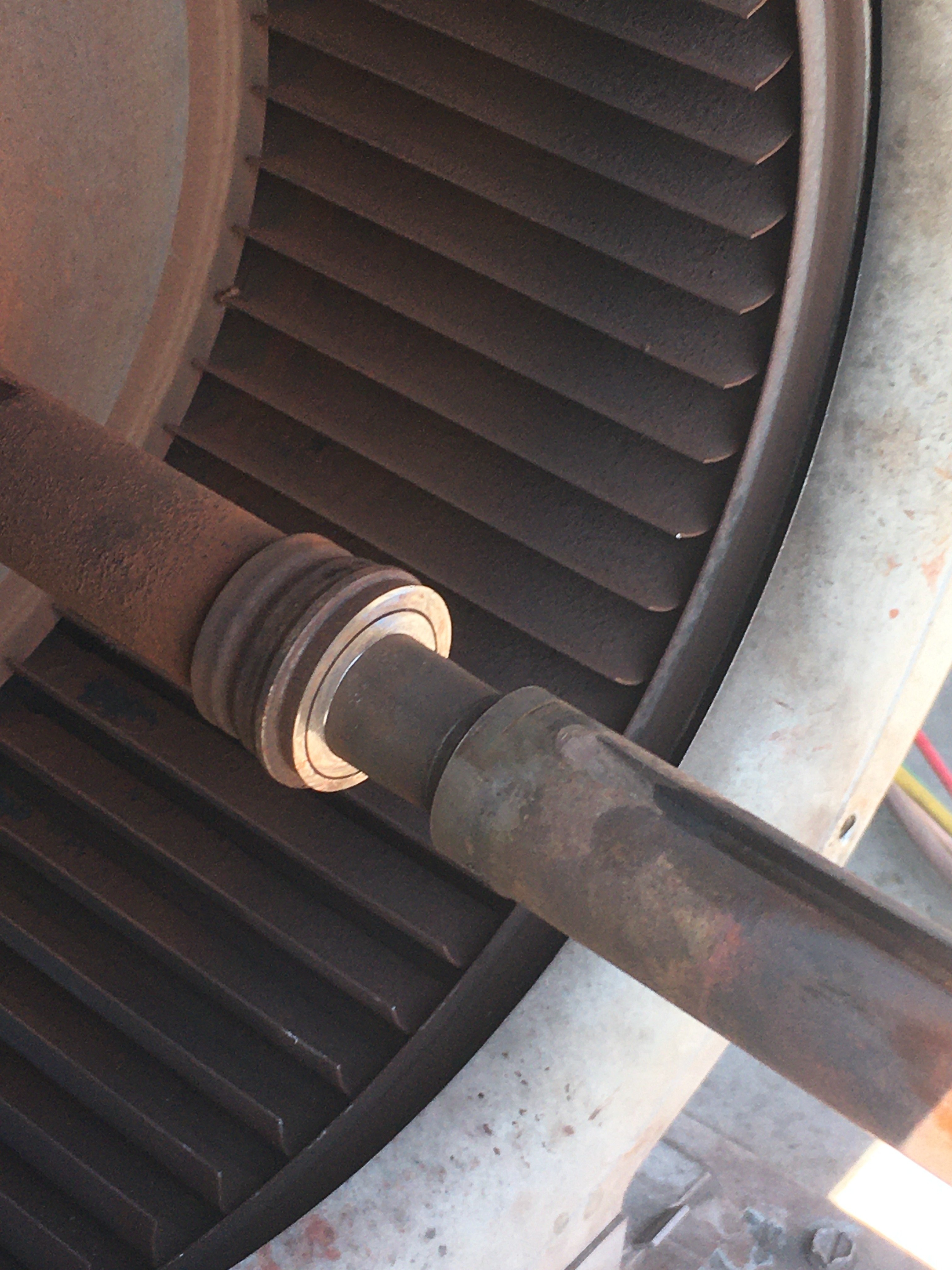

Daikin… I have one package unit on the roof and it’s the newest not counting the Bryant recent install…
Maybe I got a bad one but it was advertised as a direct Carrier replacement but it was not… had leaking coil and bad compressor under warranty but took months to get the coil from
Asia.
Staff reported a odd sound last week which I traced to the Daikin
Bad blower shaft bearing the cause.
Note the shaft is 1” dia. and the groove pictured worn into the shaft is from the bad bearing.
