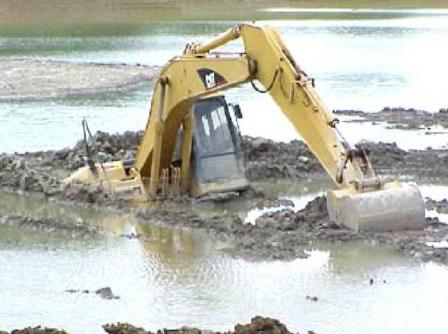

How about just going to tracks?! Certainly you wouldn't get stuck with tracks...right?
