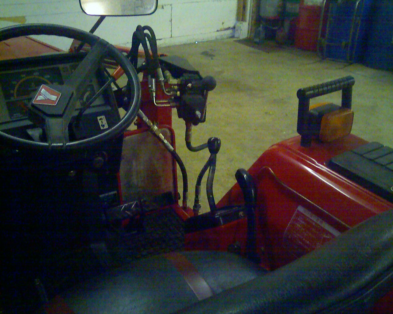

Thanks for the reply, I'm going to have to mess around around with the UFO settings a little more after reading Mickeys post. F-series are really nice tractors, thinking of getting another one like a F/X 26 in the future which I believe are a little larger frame and more operator room. I still really like my F22 and the manual shift does not bother me as I think the gears are synchronized and I can upshift on the go very smoothly, just would like maybe a bit more space and weight. I am posting a pic of my operator are for jimmer2880.

Thank you. I see now, it's actually on the inside of the fender. Mine, is mounted on the fender itself, facing up and towards the front.
you can see it here
