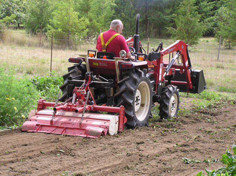

5'8", 220. I hit my leg on the turn signal stock almost everytime I get on the machine. Reaching down on either side for either the 3-pt controls or the tans range lever on the left, they are too close for my liking. I think the seat is biased a little to the left as I don't have any problems seeing the 3-pt controls but I'm up against the range lever. It's just a straight line movement but it is somewhat easy to move the lever mid-point between gears. The parking brake lever is behind my lower left leg.
Wishing things were not so compact.
Here is some info you may find useful. With nothing but me in the saddle, my machine tips the scale at 3900#, 2140# on the front and 1760# on the rear. Yep, the front axle load is greater than the rear.
To get an idea of size, here is a pic with me in the saddle.
