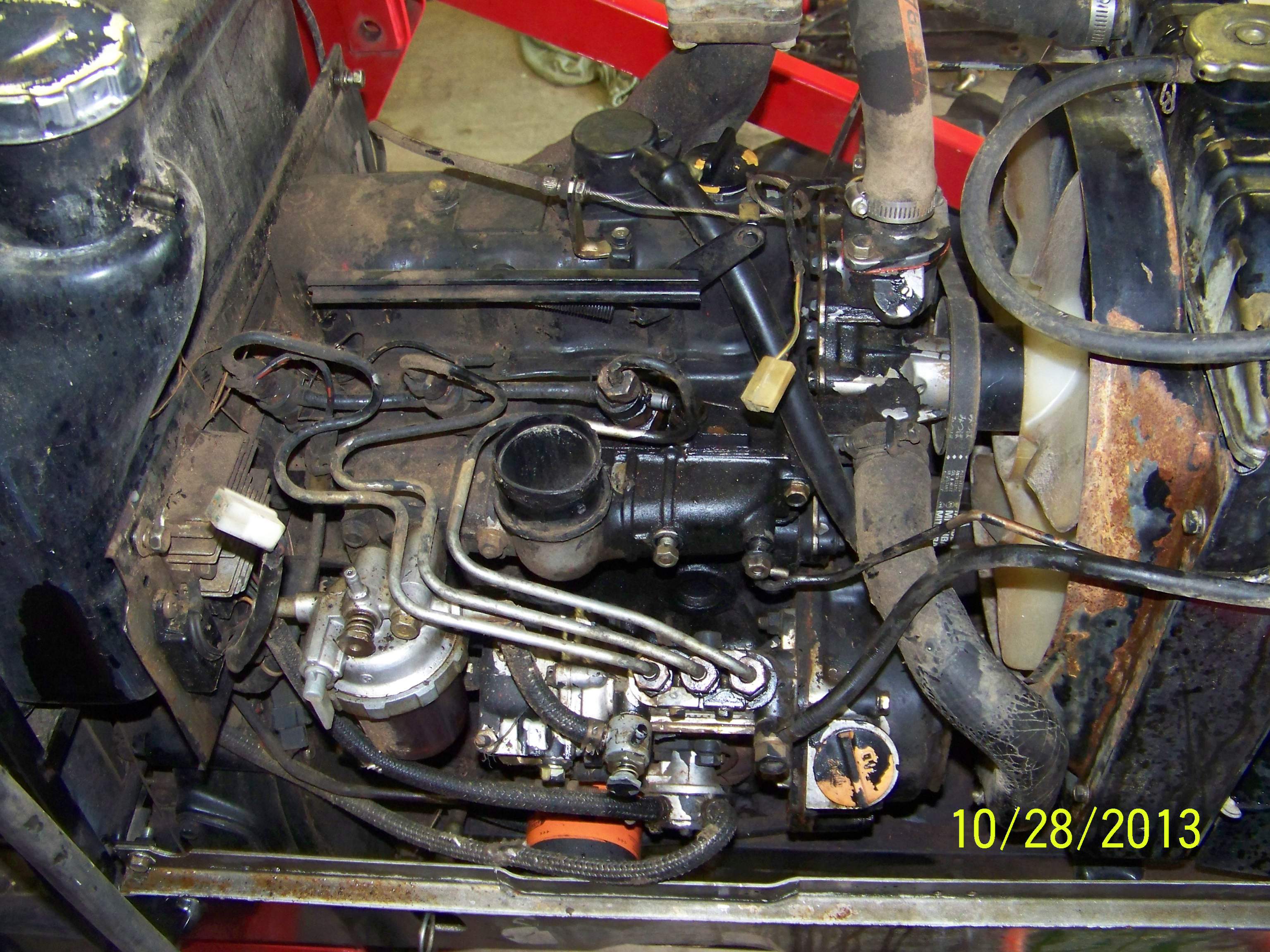

Can those of you that own FX24D tractors post some photos? Mine is used and has been amateur engineered on several engine modifications. I would like to see what an original engine compartment looks like.
I am missing a coolant overflow tank. The battery is not secured. The radiator is secured at the bottom, but has a lot of movement. The fuel switch/bowl looks like it may have been replaced with an aftermarket model. Some of the tubing has been replaced with clear tubing.

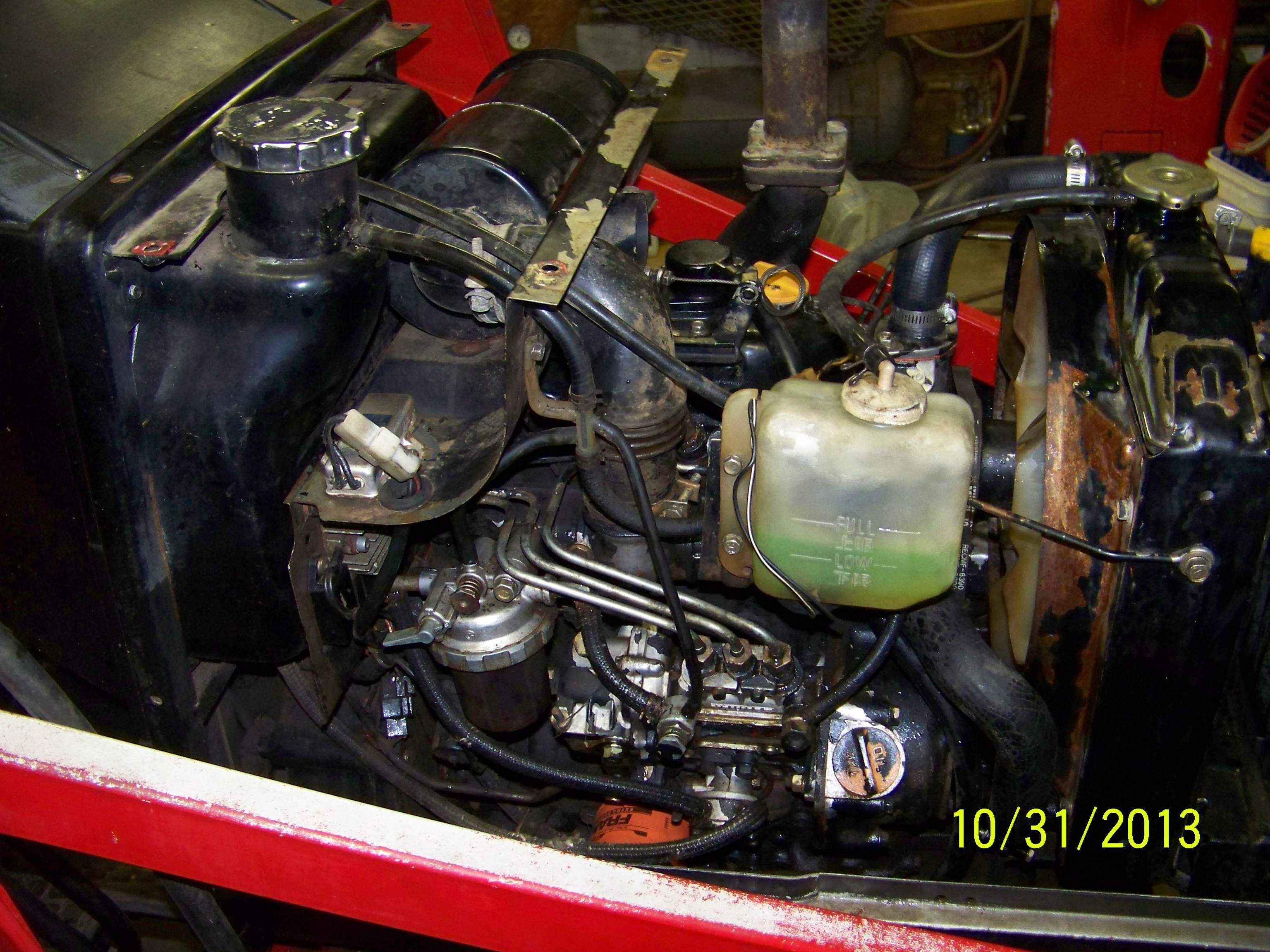

Here are a couple of pictures of the one I am in the process of replacing the head gasket. I will post some showing the complete engine sometime tomorrow. 100_6481.jpg100_6480.jpg
That is not the correct upper radiator hose. Pictures tomorrow will show the correct one.

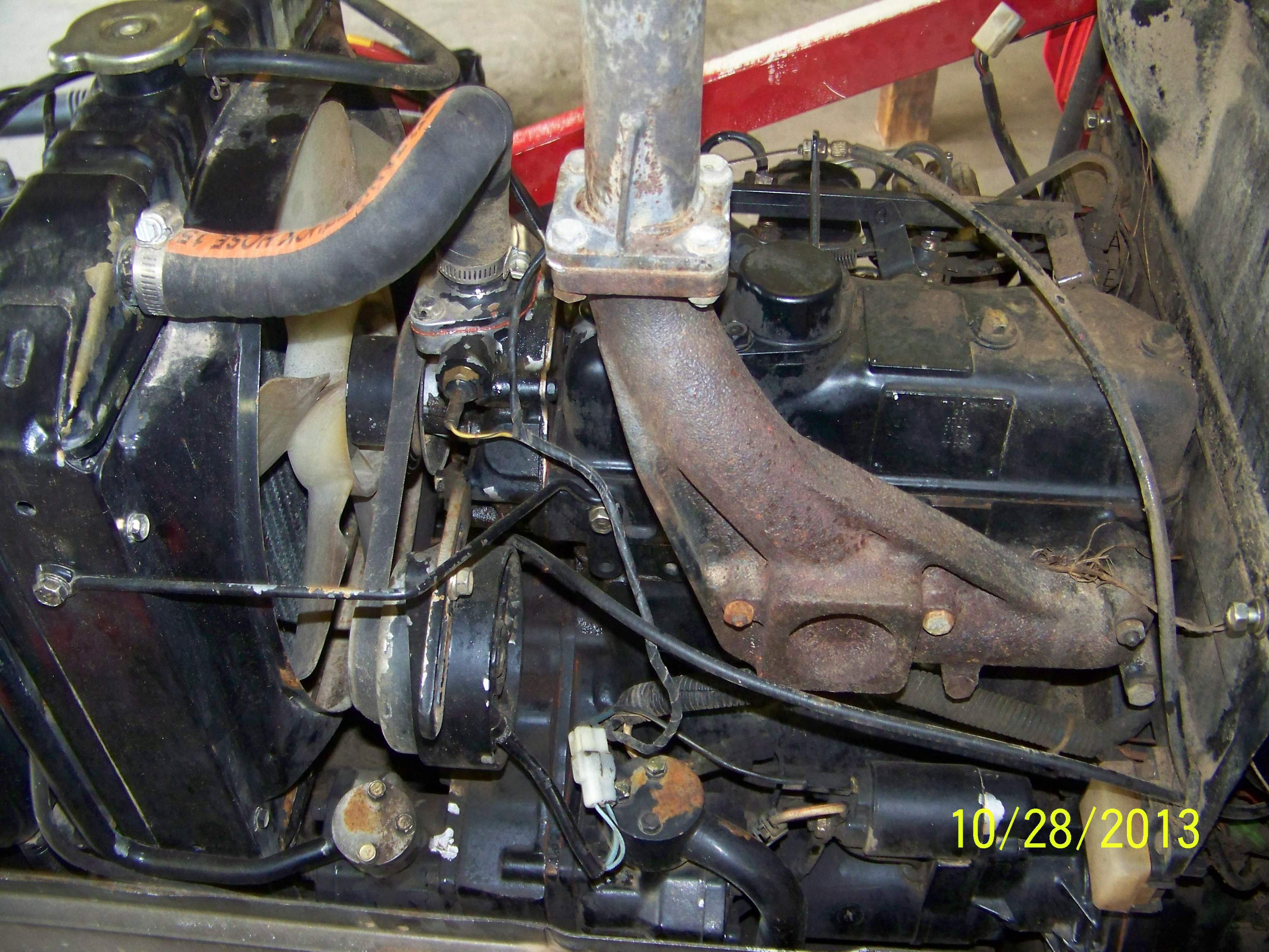

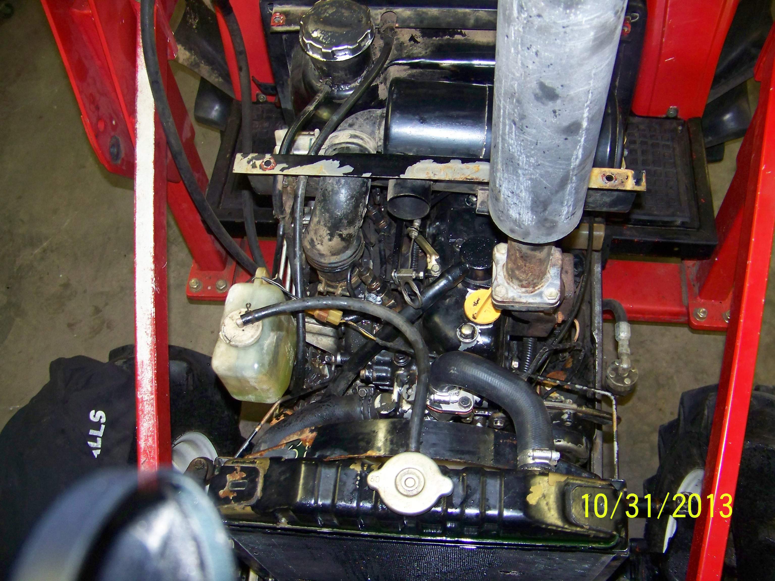

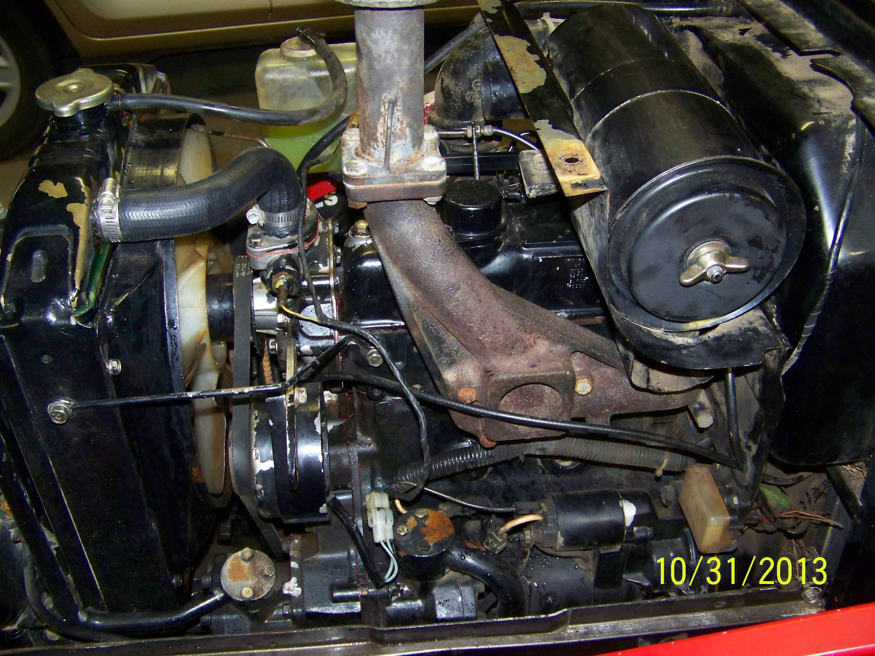

Here are some pictures of the completed assembly. If you need something particular let me know pretty quickly. Hoping this tractor will be going to it's home pretty quick and I won't remember much in a couple of days. :D

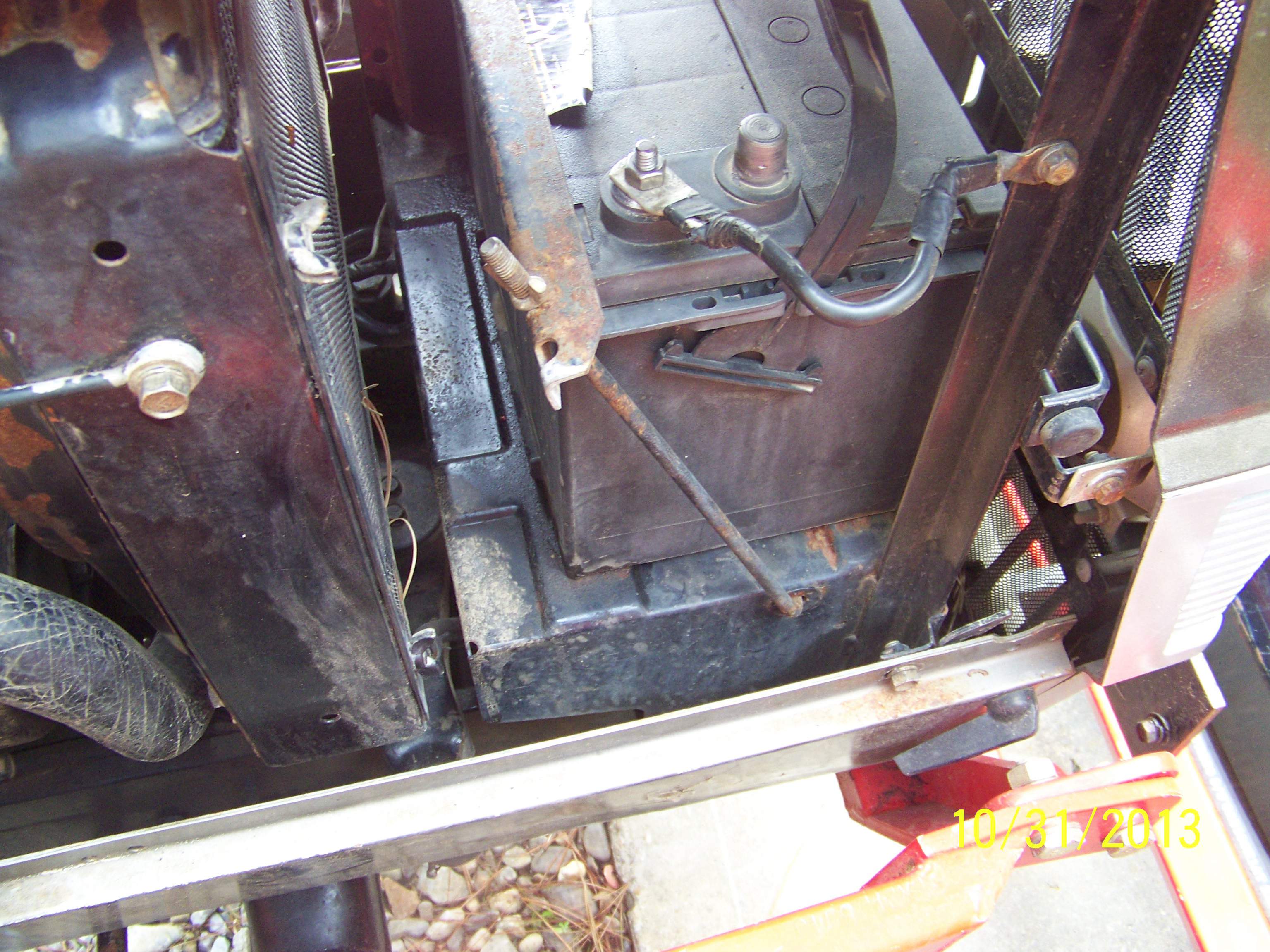

These are excellent and very helpful. Can you please take one more photo of the battery compartment that shows how the hold down is connected at the bottom? Thanks!
It is good to see how the coolant overflow and radiator are supposted to be attached. I will have to do some more amateur engineering to rig something for both of them. I think my battery tray is missing. It is sitting loose on a shelf and held in place by a piece of wire.

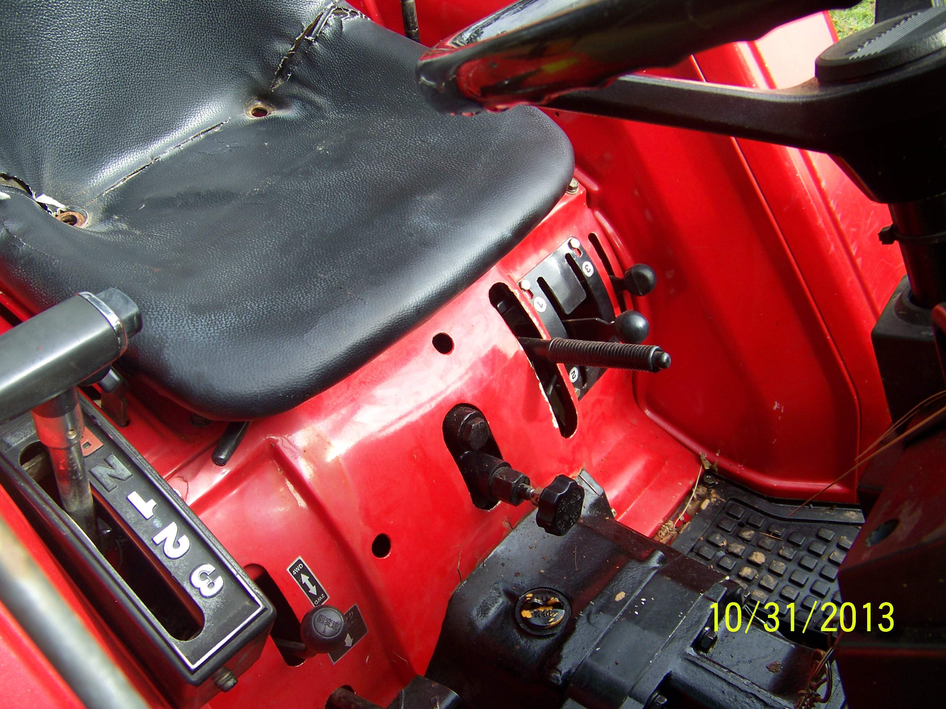

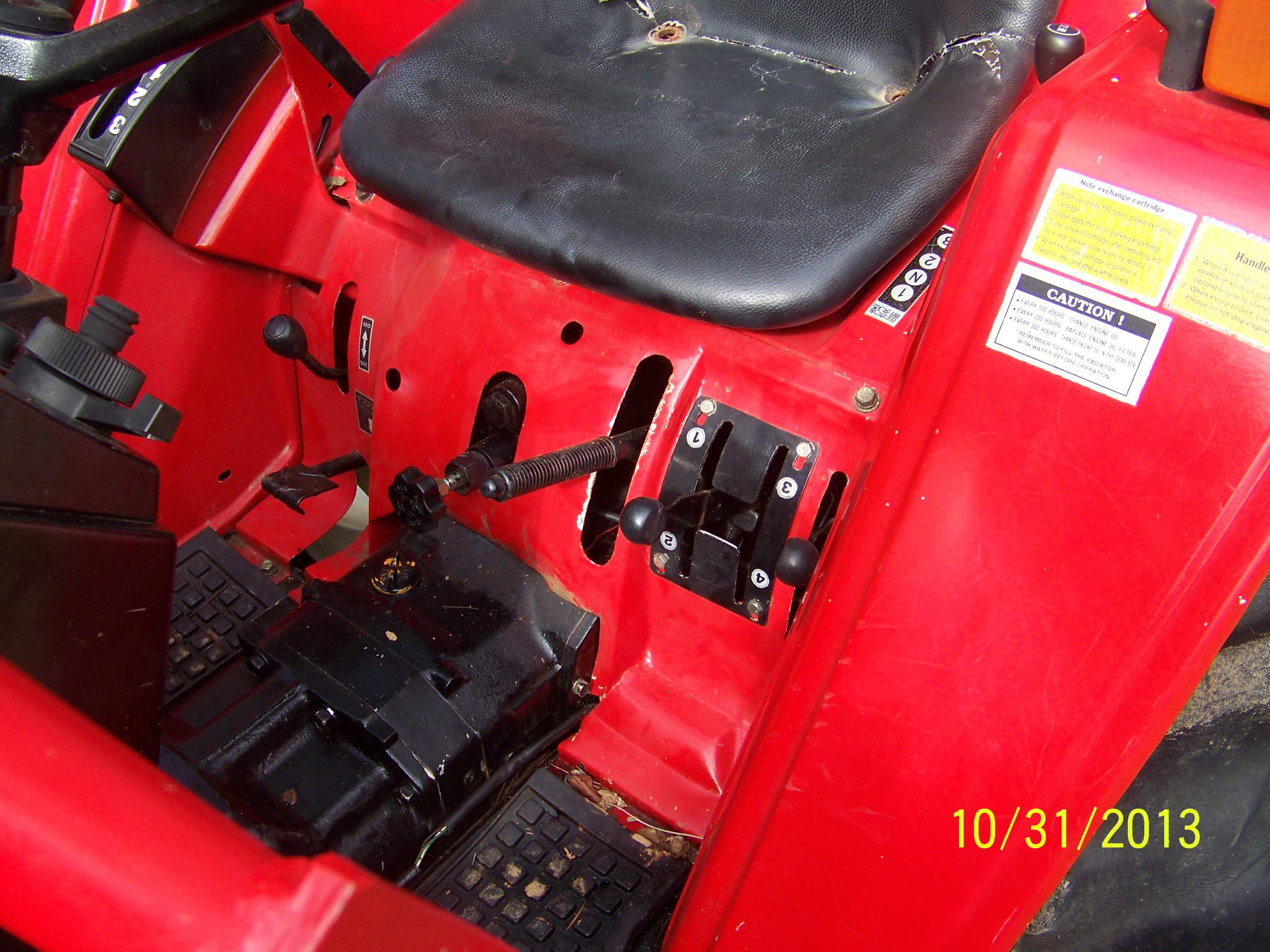

Some more pictures. The side panels are at the owners house. Pretty sure Hoyes has cylinders for the Bulldog loaders. I have the same 285 loader on my ym2002d. I am going to attempt to load a video on the "Drive train FX24D" thread. May or may not work.

Thanks again for the great photos. That must be a different year than mine. The battery tray is completely different. The tractor in general looks better than mine.

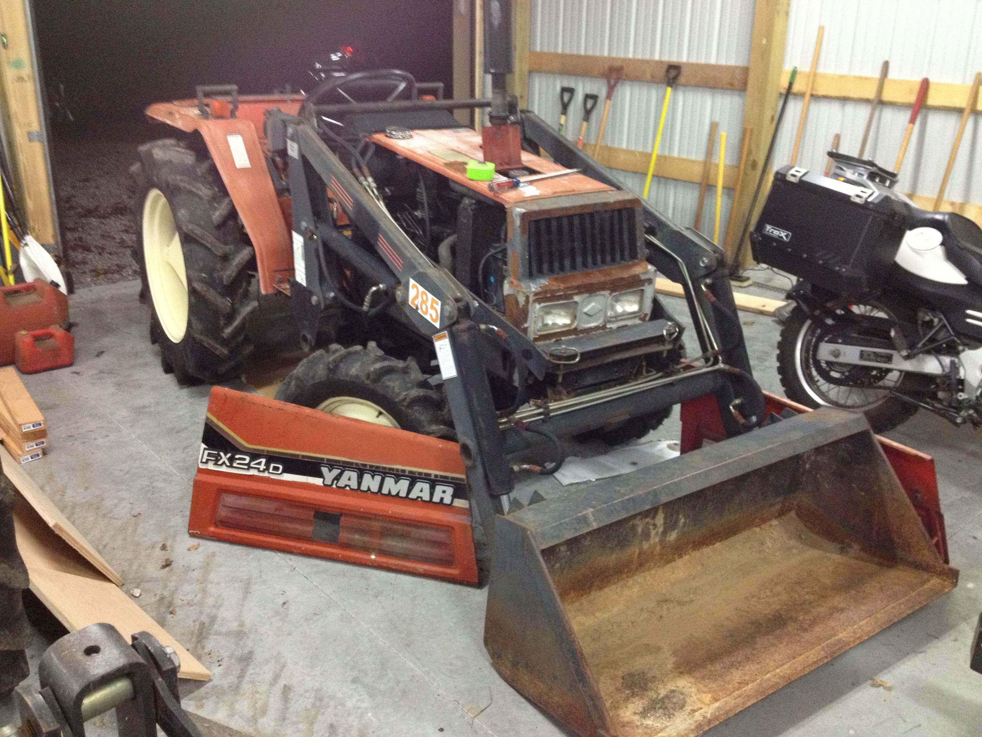

These are the best photos I have right now. I can take more this evening.

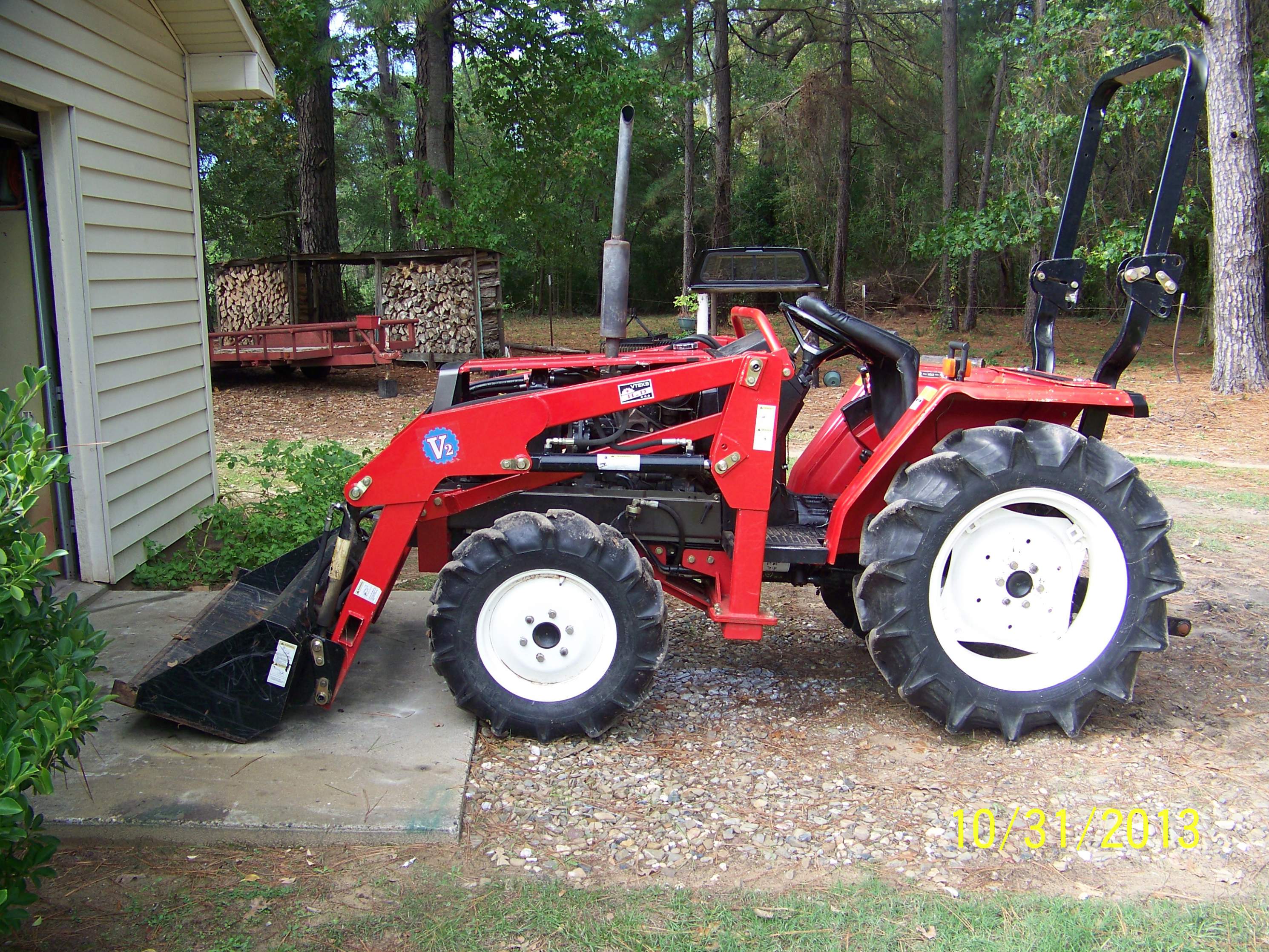

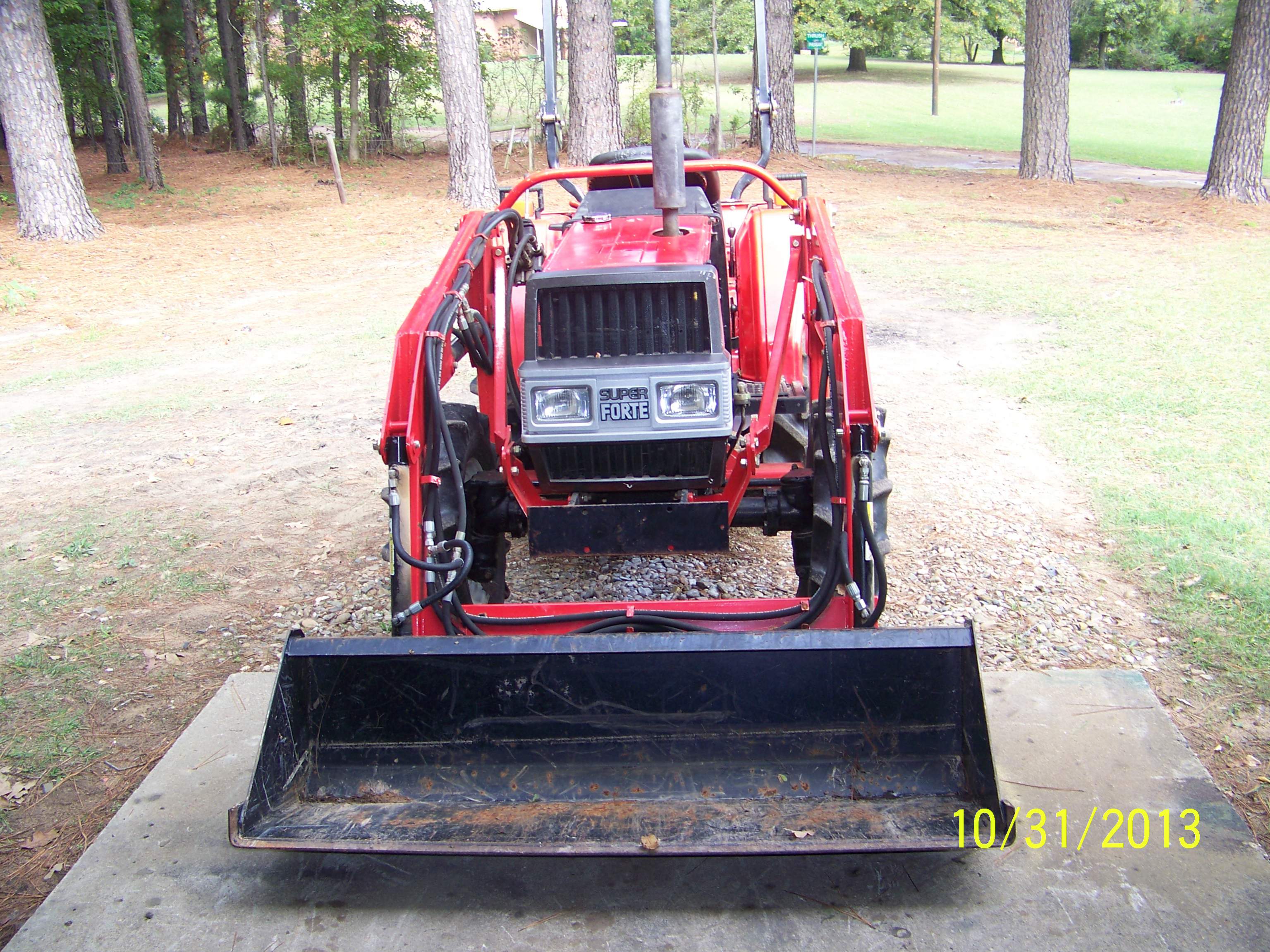

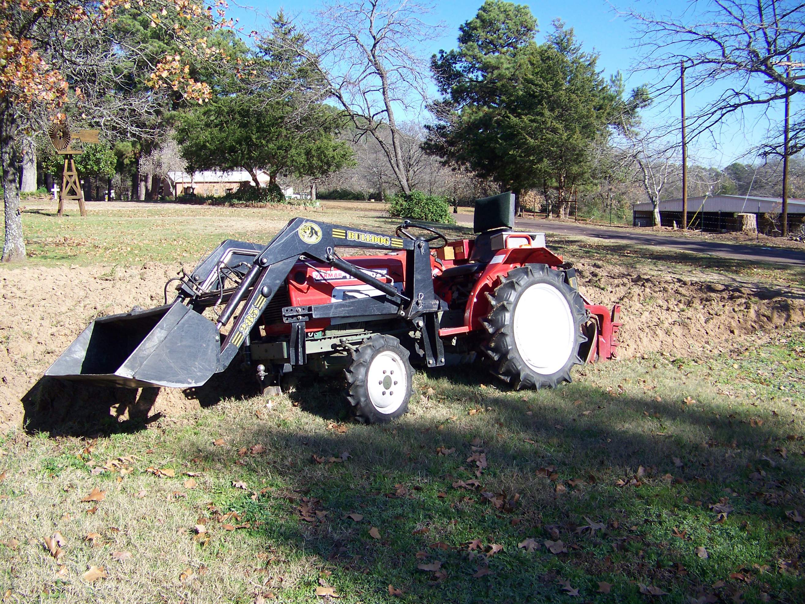

Hmmmm, that is sure not a Bulldog loader. I have been to LCI quite a few times and never saw anything but Bulldog loaders on their tractors. I'm wondering if yours is from their early years before I became acquainted with them. Posting a picture of my Bulldog 285 loader. The thing I like about it most is taking two bolts loose, unplugging my quick connects and I can leave it hanging under my shed. Not exaggerating, I probably take it on and off at least once a month. I mow around lots of trees and the loader is a hindrance to me in tight quarters.

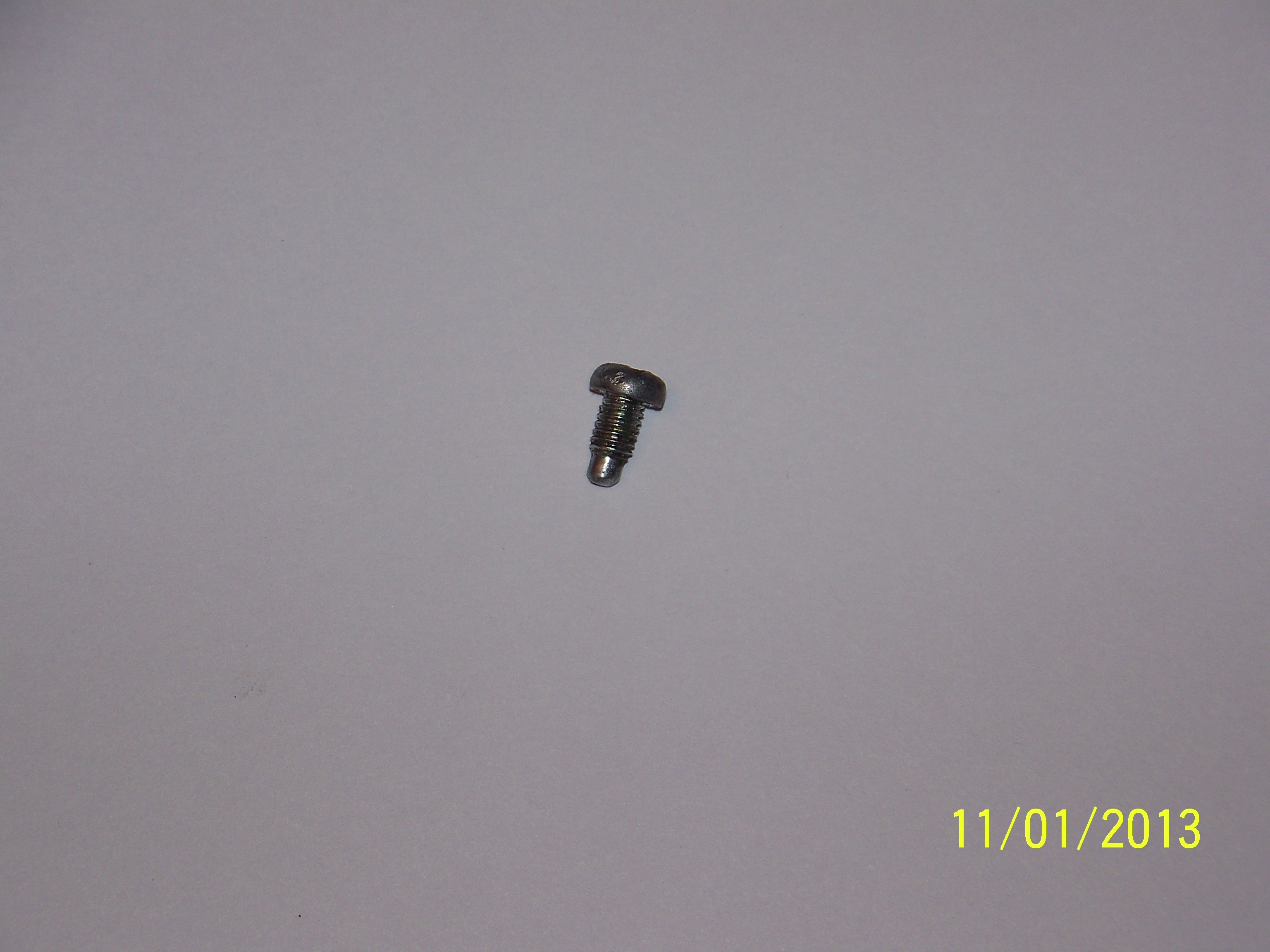

100_6511.JPGHere is the 4m-.7 setscrew that holds the fuel valve handle. Has a special rounded end. Picture for what it is worth.

Yours is definitely in better condition, and it looks like a more simplified design. I don't think I could remove mine without removing the muffler as well. But, the muffler is only held on with a U-clamp right now, so it wouldn't be too difficult.
Is LCI gone? I couldn't find them anywhere on the internet. I even called a few places in that area of Texas.

Thanks. I found a flush allen head screw that fits. I may try to round off the end to prevent more damage to the slot in the valve handle. I will keep looking for the correct screw.
I think I fixed it with a $0.60 screw and $0.50 o-ring. As long as it works that beats $50.

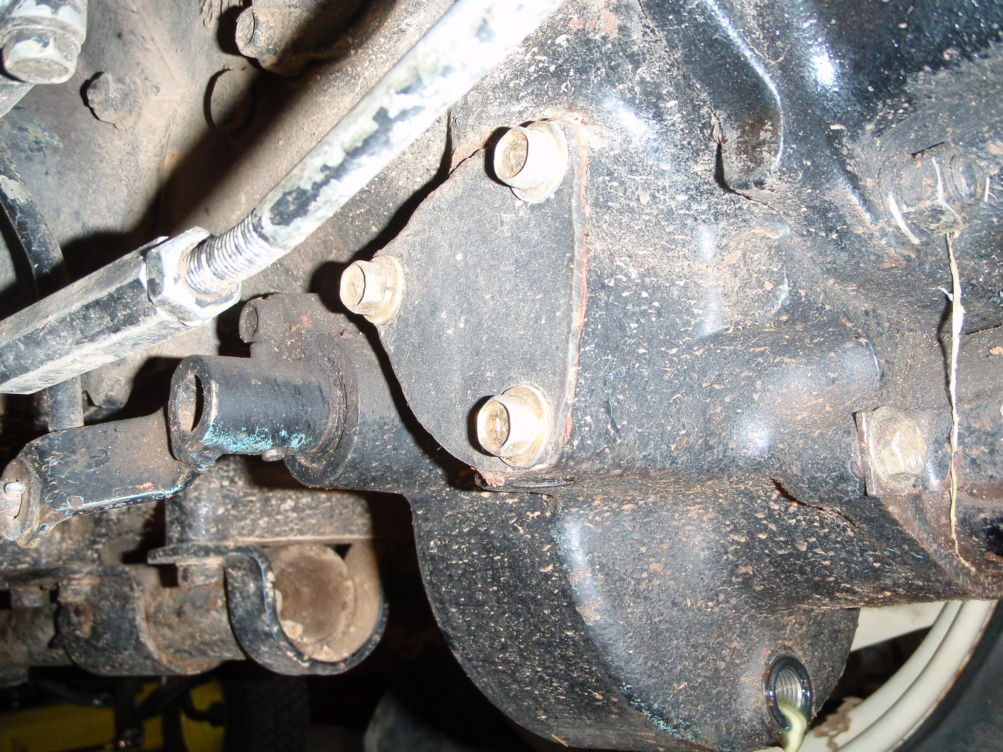

GWSMITH or someone else with an FX24D, can you please verify something for me? Is the metal plate with three screws in this photo the cover for the hydraulic screen? This doesn't look the same as the cover that Hoye has, or what is in the manual. It looks like someone may have cut a piece of sheet metal and used some silicon sealant instead of using the replacement part. Thanks!
