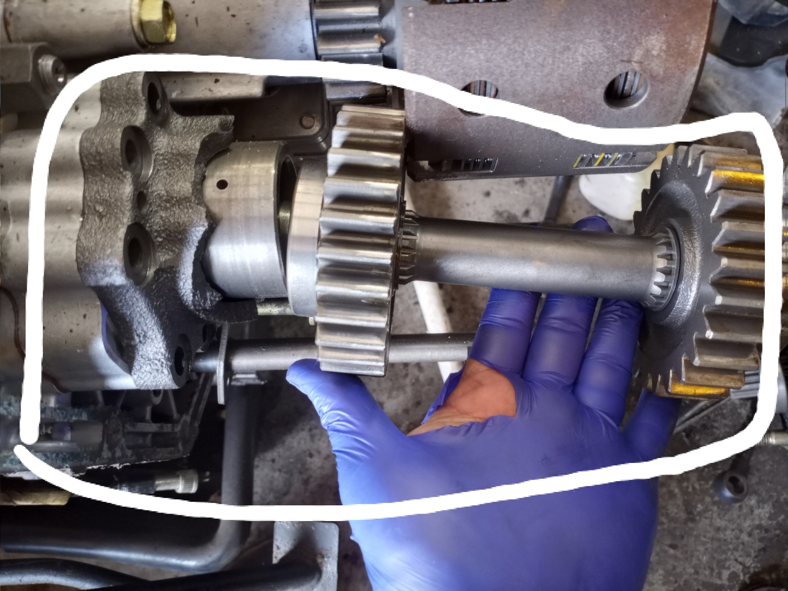

I need a transmission or the hydrostatic pump for either the fx32d or fx42d. I have a broken pump housing that we can not find. I am trying to get one made but that is not looking very feasible right now.

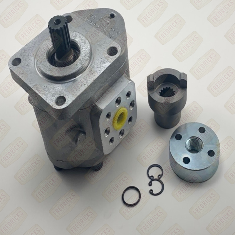

Hydraulic pump - HP-12A - Fredricks Equipment Parts - Your home for Yanmar, Mahindra, and Bad Boy Mower parts!
Hydraulic pump – HP-12A
$499.00
Description: Hydraulic pump with coupler
Applications: 2620, 2820, 3220, 336, 3110, FX26, FX28, FX32, FX42
Part Number: 194278-41120-X (194640-41110)

I did the part that I need is also broken on this unit. Thank you for the help.
/ fx32d/fx42d
This is not the pump needed. It is the hydrostatic pump located in the transmission.
/ fx32d/fx42d
this is the broken part I need

The break appears to be from the rear end of the tractor flexing upward or downward.
Do you have a bucket loader and/or backhoe on it.

I have a bucket and a box blade

If you find the pump to repair your tractor, I would suggest that you run heavy steel reinforcing rails from the underbelly frame of the loader to the rear axles to prevent it from breaking again. I have the Yanmar loader on my YM336D, which lifts about 3000 lbs and I have a 9' American Trencher backhoe that weighs 1800 lbs on the rear. So I have 1" thick steel bars there to prevent any movement.
You probably should use at least 3/8" or 1/2".

Thank You for your advice I did not think there would be that much flex to break something like this
