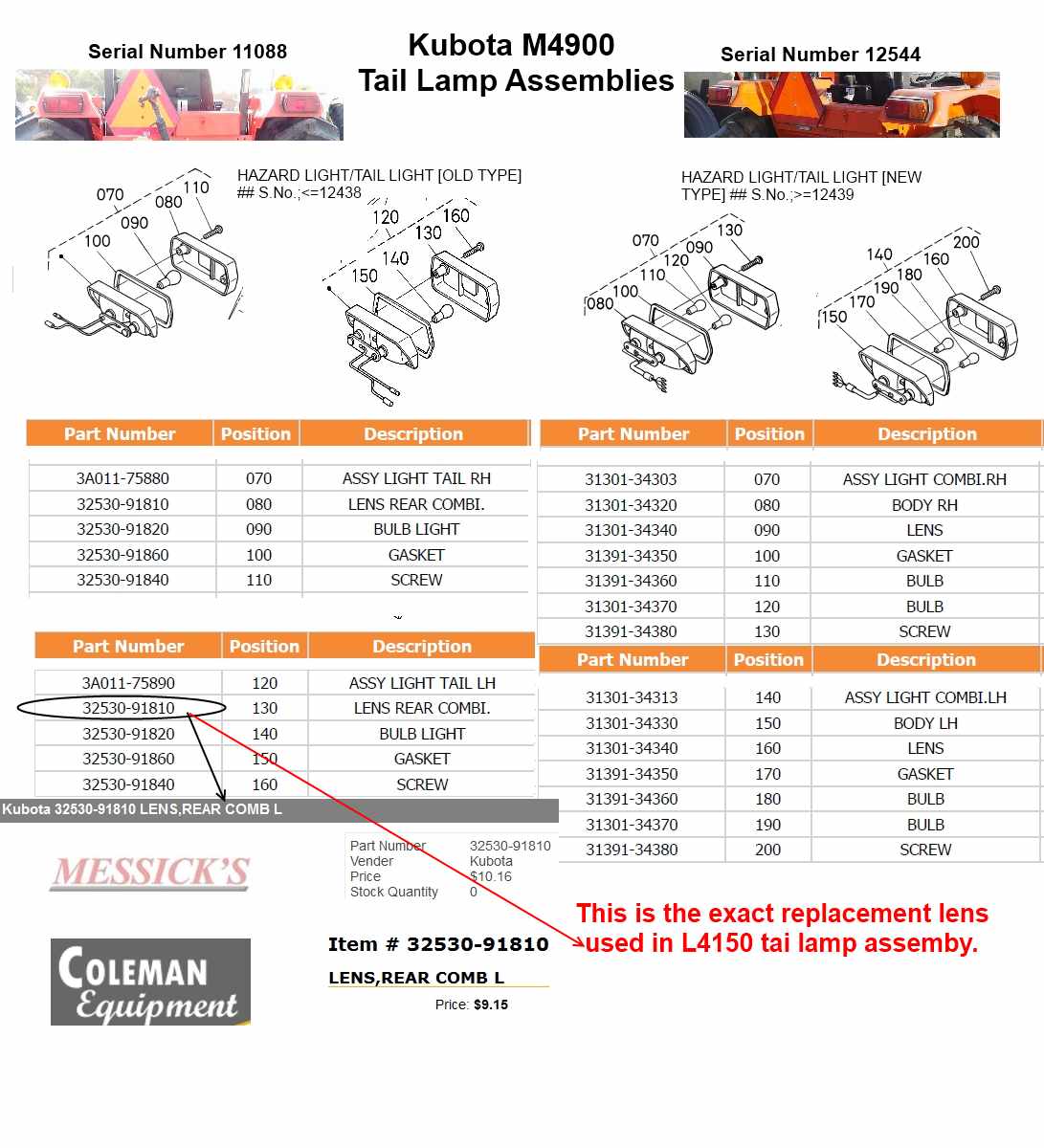

I needed to replace broken tail lamp lens on my L4150 but the parts manual only showed a complete tail lamp assembly for around $67.
Stumbled across a parts manual for a M4900 that showed tail lamps that looked like the same ones used on L4150 however they had different part numbers. But these tail lamps allowed buying each component of the assembly including the lens.
Well today I picked up the lens for the M4900 (part number 32530-91810) and it is perfect match to the original lens used on L4150. Only paid $10.
I have include the M4900 info here for reference if anyone else should need it.

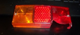

Can I get a measurement? I need them on a Montana and they look about it. Montana also wants to sell the whole unit at $86 ... mine are 2.5" by 6" ... center to center of the holes appears to be 5 and 5/8"

   / FYI - L4150 - Tail Lamp Lens Replacement
Sorry, Don't think it will work in Montana.
The L4150 Lens is 3" x 7.75" and have tapered ends.
   / FYI - L4150 - Tail Lamp Lens Replacement #4
AH Shucks ... I can order a lens from the Cobo Lens company (MFG) minimum order 5 lens and 14-16 weeks out ... comes from Italy and that would be a lifetime supply!!! $9.90 each still cheaper than the entire unit.
