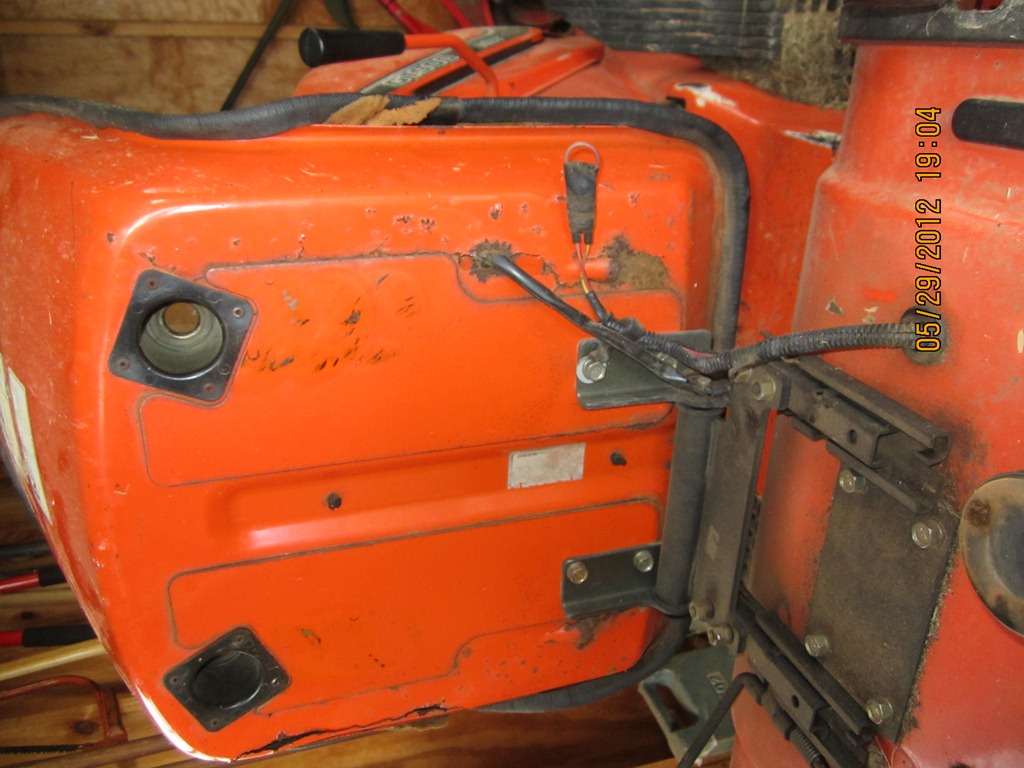

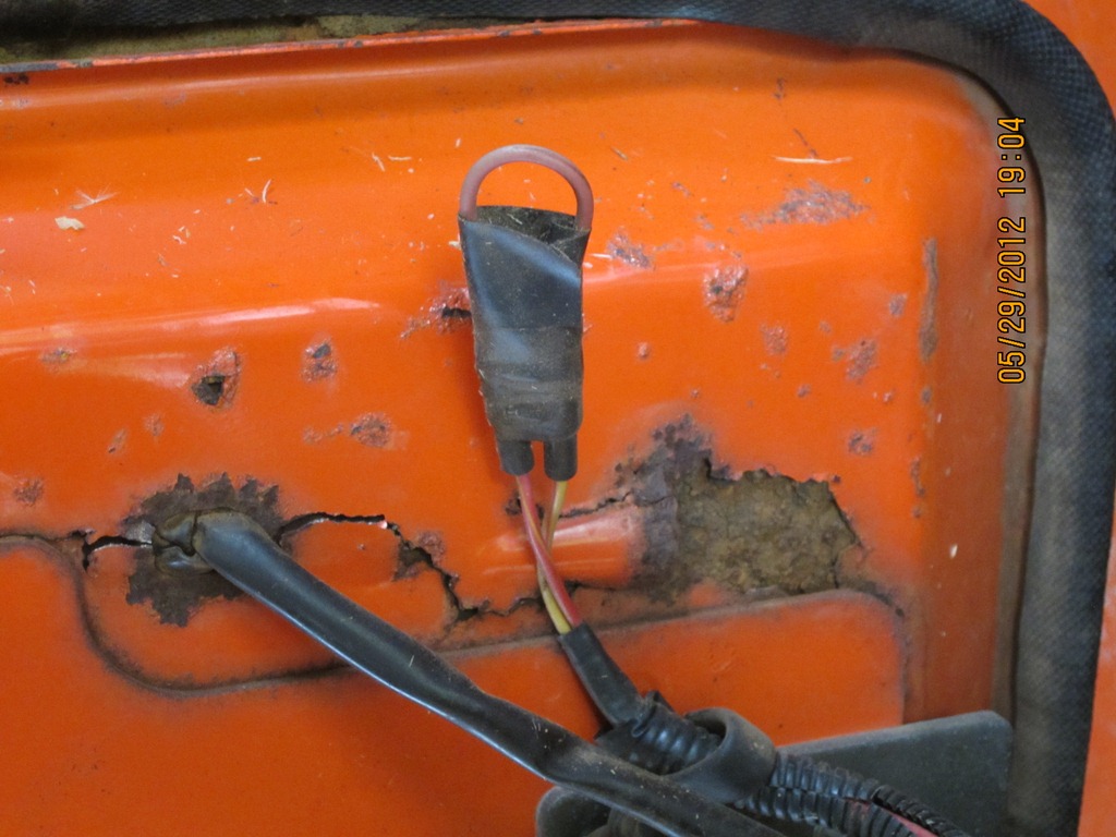

I would also bet on the seat safety switch. Mine acted up, and the bypass solved the problem. Be sure to cover the bypass in electrical tape, as I created a shorting problem by not properly insulating it the first time around.

I took a look yesterday and found that my seat has no wiring at all, so a previous owner must have removed the seat safety measures.

/ G1900s stalling on sharp left turns #9
There must be some wiring. You should search it out, because if the fix has come loose and the connection is loose, that could account for the intermittent engine operation.

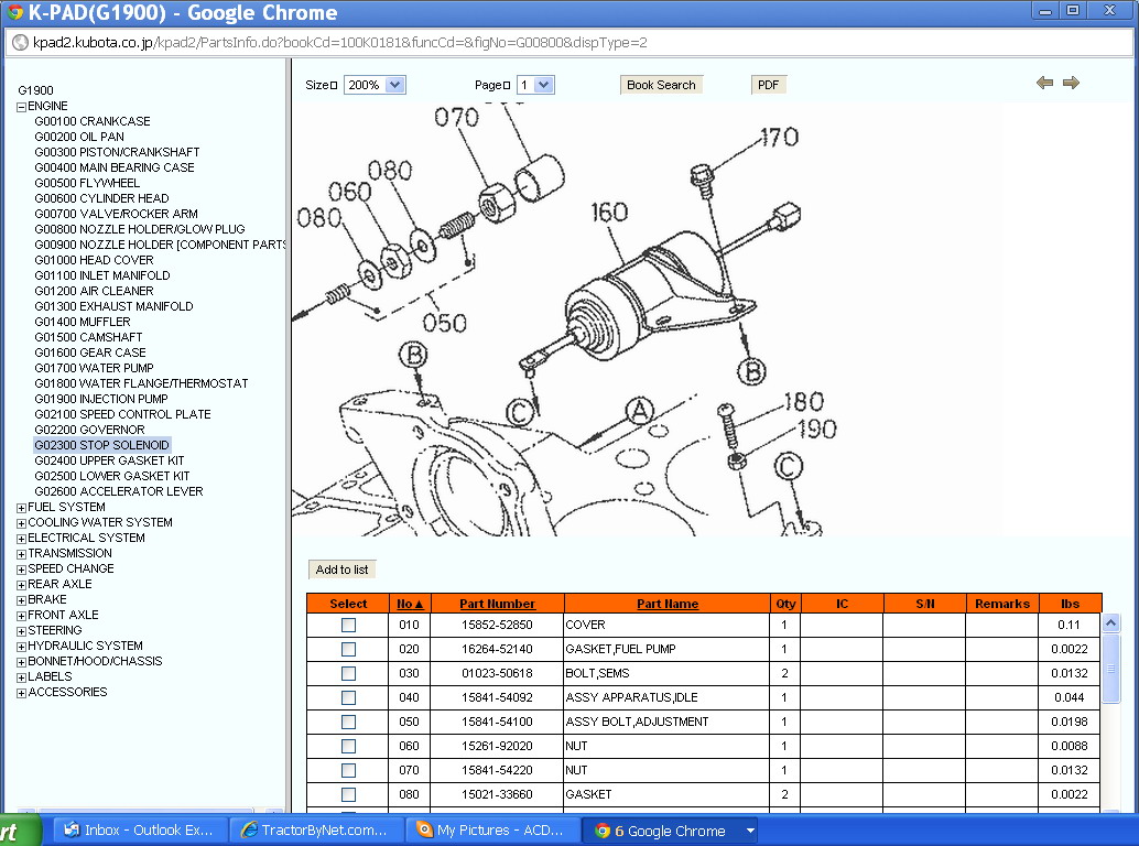

Josh, my G1800 has the seat switch disabled. It was that way when I bought my G1800 a couple of years ago. The seat switch makes contact when the operator is present and opens when you get out of the seat, so all you have to do is put a jumper between the wires in the connector to bypass the switches operation.
To ensure your safety circuits are not causing your machine to shut down when you turn left, you should open the hood and disconnect the fuel cutoff solenoid. It's located above the water pump and looks like the illustration below with a pigtail connector. Disconnect the solenoid and then drive around making left turns. If the engine no longer dies, your problem is electrical and something is causing the solenoid to shut the engine down. If the engine still dies, then your problem is probably fuel feed related to a dirty filter or faulty fuel pump.
BTW: While the solenoid is disconnected, you probably won't be able to stop the engine with the key. Reconnect the solenoid and then turn off the key for normal operation. It's important to turn off the key after the solenoid is reconnected because the kill signal to the solenoid is only there for 10 seconds after the key is turned off.
