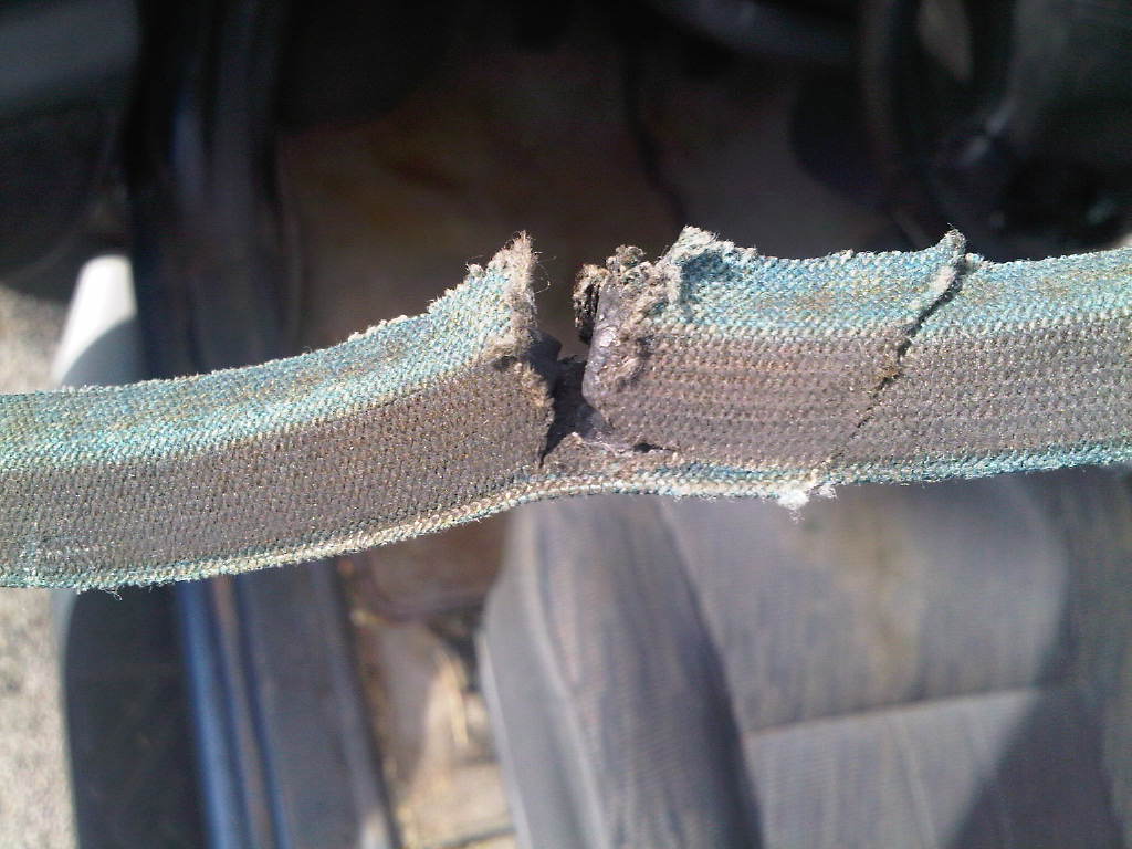

I went buy the dealer this morning. It was cogged and said "Bando REC SB-31" on it and it measured 33" outside circumference, ~5/8" wide, ~7/16" thick. So it's a BX30 belt.
I hear you on the wrapped belts handling slippage better. Makes sense. Attached is a picture of how the dead one died. I don't know what would cause that. Rubber is still very flexible.
attachment.php
I would lo0ok at the OEM belt to make sure it is notched, but if this it engaging the PTO by tightening the belts, I would recommended a wrapped belt... In my experience unwrapped belts don't handle slipping during the process of engaging anywhere near as well as wrapped belts do.
Just my :2cents:

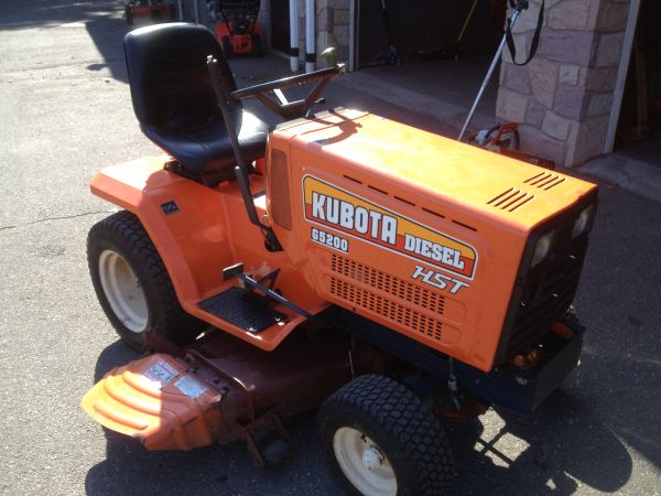

Thanks for the cooling advice - I'll keep on top of that. We share a diesel affinity. For me it has to do with build quality, durability, available torque and low fuel consumption compared to gas powered. That reminds me - I gotta call that guy and tell him we have a deal. That thing is a wee-beastie.
   / G5200 Front PTO engagement belts #16
Took delivery, yesterday.
The pump was just replaced, but I'll keep an eye on the temperature when the temperature warms up again.
#17
Looks great! Prettier than mine. How much you give fer it? How many hours?
The thing will PULL. Very useful even without the mowing deck. Great compliment to my little Yanmar 1610D tractor.
   / G5200 Front PTO engagement belts #18
$2000/670hrs. We paid almost as much for a new Craftsman in 2007 with a bagger and trailer. The Craftsman is on it's 2nd engine and I never know what will go wrong with it next. Had to rework the battery tray on the Kubota as the battery in it is not the right size - too big. Next job is to make an adapter for the deck and hitch so we can hook up the Cyclone Rake. Now we can sell the Craftsman in the Spring!

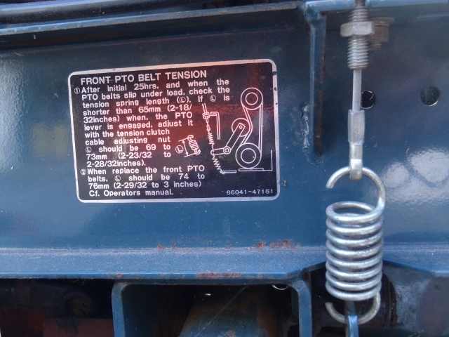

So far, so good with the replacement belts.
Had to re-tension the PTO cable today after a full summer of mowing:
