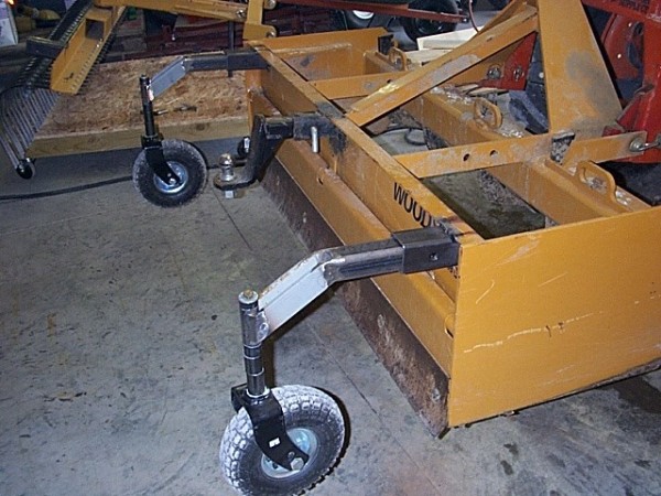

/ Gage wheel project
Here is a pic of the box blade with the tube welded up, I will use the same gauge wheels with the box.
Here is a pic of the new gauge wheels on the box blade. Must have missed getting a pic on the rake.

Nice work on the wheels. Can you turn the pins inward instead of shrotening the bar?.............chim

The wheels are rated at 300lbs a piece and the box blade is aprox 650lbs. The weight will be distibuted between the wheels and the 3pt so they should be ok. I'd get better wheels if it was used everyday for sure.
