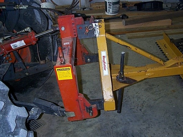

   / Gage wheel project
#23
Here are some more pics.
Landscape rake modified to fit in the quick hitch. The 3pt pins had to be moved inward 3/4" to fit.

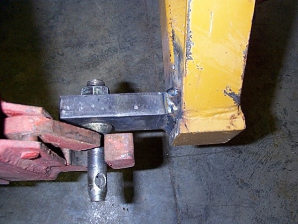

#24
Here is a close up. The pins were originaly welded to 3/4" flat. The local steel shop only had 1/2" so I welded up two pieces ground it smooth then welded to the frame so it now a 1" piece.

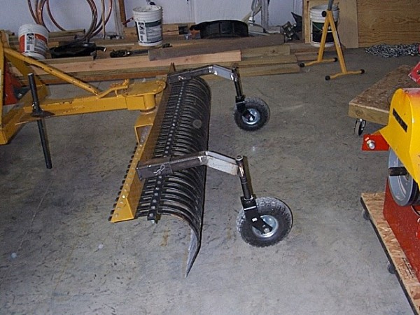

#25
Landscape rake with the gauge wheels

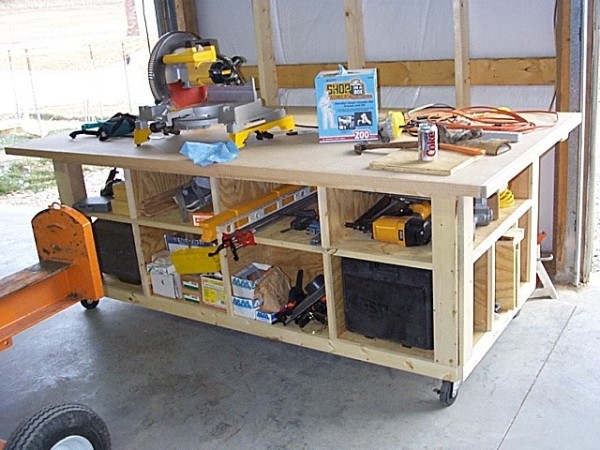

#26
My roll around work bench I built two weekends ago. Debating on putting doors on it and it still needs corner trim. I used for a little grinding on the gauge wheel stuff. /forums/images/graemlins/grin.gif

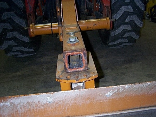

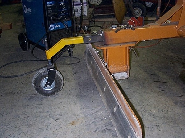

#27
The start of adding a guage/tail wheel to the rear blade. This is the first hole I have ever cut with a torch. Before this my experiance was about an hour of cutting up scrape. Bought a Victor super range II.

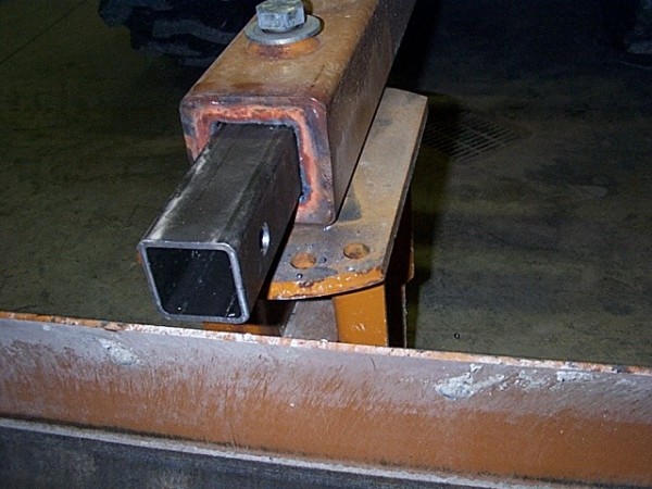

#28
2 minutes worth of grinding later it fits!!

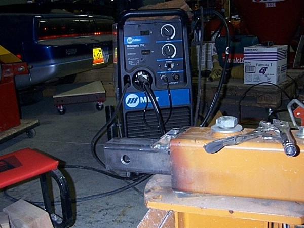

#29
Here it is welded up with a little support just in case I put the hitch on it to move the car trailer. The tail wheel would be probably be fine with out it.
#30
Here it is with a tail wheel double checking the hieght adjustment.
