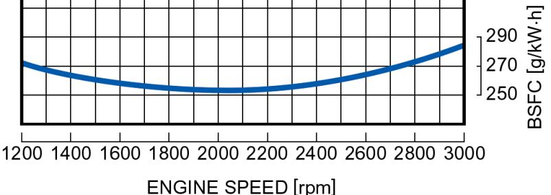

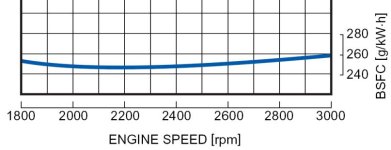

Sorry, but this is nonsense. Turbodiesel engines have lower friction/hp, higher HP/weight, both of which are critical factors affecting fuel efficiency in a vehicle application. The most fuel efficient engines on the planet are turbodiesel engines and they have held this status since the 30's.
I second that. Turbos have lover specific fuel consumption. Turbos recover energy from exhaust and use it to cover suction losses in the intake.

MY Kubota (NA Diesel with 39 HP) can burn a little more than a gal per hour if you work it really hard but that is NOT TYPICAL.
You don't get something for nothing. Fuel consumption is related to work performed (assuming efficiencies are similar between the large and small engine.) A smaller engine, turbo or not, may burn fuel at a slower rate but takes more hours to do the job. The larger HP machine doesn't always burn more fuel per hour but will if you ask it to do work at a rate faster than the little machine.
This last statement (given similar efficiencies) has to be true.
The "basal metabolism" of a diesel burns fuel when it runs whether or not it is doing anything useful. The larger the displacement the greater the basal metabolism. Turbo diesels have a dual personality. At idle or light loading (low turbo boost) their basal metabolism is low like the non-turbo engine BUT when worked hard (significant turbo boost) they produce more power per unit of displacement than non-turbo and typically do it at least as efficiently (fuel consumed per HP-Hour) and sometimes more efficiently.
The chief reason folks get the idea that turbo diesels burn more fuel is because they can BUT while producing more power. Properly operating turbo diesels DO NOT burn more fuel to do the same job and may burn less.
