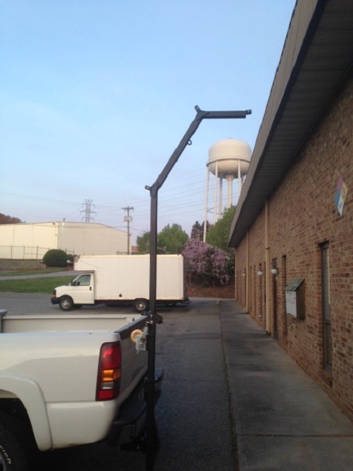

Several years ago , seen something similar to the picture below .
For the price they wanted , My Brother and Me decided to build our own .
Went to a local steel place that has a lot of recyled steel and purchased what We thought We needed . Some are rated at 300 pounds , while others are rated at 500 pounds . Based upon the size of their tube for 500 pounds , Ours is likely 1000 pounds or better . 2" x .25" wall round tube for main upright and vertical top . Vertical top is also supported by a brace of 4" x 1/2" flat bar , similar to the brace in the picture .
Started with a piece of 2" square tube that was a custom made hitch extension that was made for Me by a shop when I pulled my boat behind my camper . We added a piece of 1/2" plate to that at the end , to which We welded a 12" piece of 2.5" round tube that the 1st section of upright goes into . That 1st section , maybe 3' to 4' long , has a large piece of 1/2" plate welded to it for a electric winch . Then there is a coupler of 2.5" tube that the top section goes into .
The upright sections rotate 360 , thus once game is lifted it can be swung around to rear of vehicle for loading .
This past elk season , scored a 6 x 5 that hanging weight was almost 400 pounds without head and hide . Thus while hanging on the hoist while skinning , likely exceeded 500 pounds . Hoist No problem , H.F. winch , think it is the 2000 pound winch ??? , Well not so much . Got it almost all the way up , but had to manually lift / help it the last foot or so .
Yesterday , We decided to modify that hoist to make it easier to assemble . Lifting that top section up to drop it into the winch tube was a BI*** , with 3 of Us . Thus We ended up and cut the reciever extentsion , added a piece of 1 3/8" solid rod through out the entire length . Were We cut the extension tube , We welded a 7" x 1/2" round plate to the 1st section and also welded the solid rod to it . On the other piece of the extension , We welded another similar round plate , but did not weld the solid rod to that plate . 1 3/8" holes had been already drilled by My brother in the round plates , thus the rod is solid all the way through . In those round plates , the first has 2 holes , the second has 1 and the 2nd is also notched for 1/3 of the distance . Hard to explain , but the assembly , when installed in my hitch , will now rotate from vertical to a little past horizontal , thus eliminates having to " Lift " anything more than waist high . The 1st plate has those 2 holes , 1 hole for a pin to hold the hoist in a vertical position , the 2nd hole had a pin welded in place to act as a Stop , thus the reason for notching in the 2nd plate . When we lift it to vertical , it will not be able to go completly over the other side , as the second plate hits the stop .
I won't be able to get pictures till next week , but emailed my brother to go out to the shop to take a picture of Our " work " , so hopefully will add one later today .

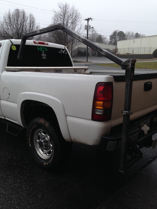

He is the one I put together made from iron that was left over from the cultivated build. 2x2x1/4 sq. tube HD! 3/32 cable.20170204_104758_1.jpeg

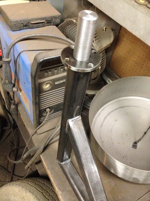

Here are a couple of pictures of just the base unit that slides into the reciever .
Dang thing weighs likely 40 or 50 pounds + , thus We have it the entire set up in components and now We will assemble in the horizontal position then rotate vertical either using the winch or winch and 1 of the many 27' 4000 pound ratchet straps that I have around here . I am the youngest at 57 , thus We be to old for to much manual labor . As they Say " Work Smarter , Not Harder " !!:thumbsup:

In the second picture , the " Leg " off to the side that can be seen , is a piece of additional 2" reciever tube welded to a pad that will slip onto the 1 3/8 solid rod that extends out of hitch extension and also slips into the extension thus it makes for quite a brace or " Foot " on the back to hold the weight .

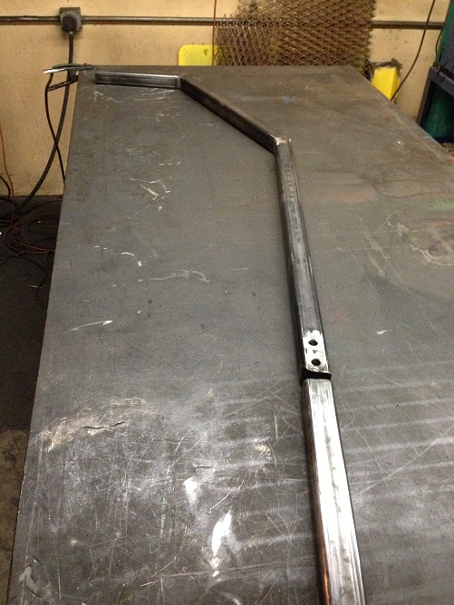

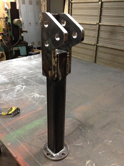

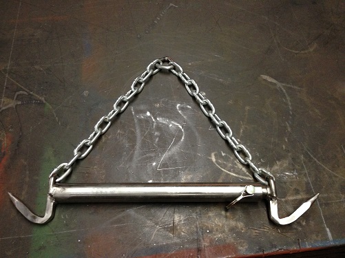

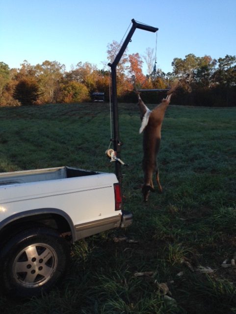

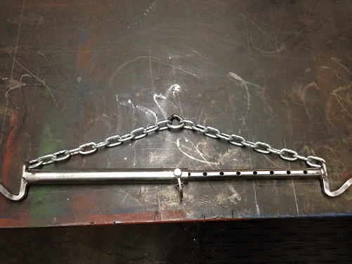

Here's one I made last winter, put an offset hitch on the truck so I can still pull a trailer and let my tailgate down. I even made a stainless gambrel that adjust for large or small deer.

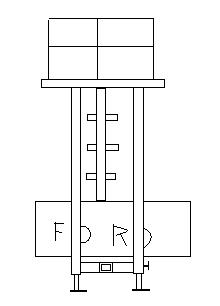

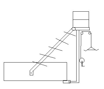

Here is one of them not yet built, but in my head. This is a combined gaming hoist/ feeder filler like this model of game hoist 5 Best Deer Hoists of 218 – Hunting Fishing Plus - Hunting Fishing Plus Please excuse the poor Cad tool (Paint) and everything is sure not in proportion or even close to scale, but you get the idea. Also feel free to make any suggestions my way.
My feeders are quite high, and now I stand on the bed rail and closed tailgate and can barely get the sack over.
I have a turn over gooseneck hitch so, so I decided to drop the ladder end into it to help stabilize it. Then pin it where it meets the platform.
Here is the rear view, and I have two vertical parts with my legs down to add extra stability.
