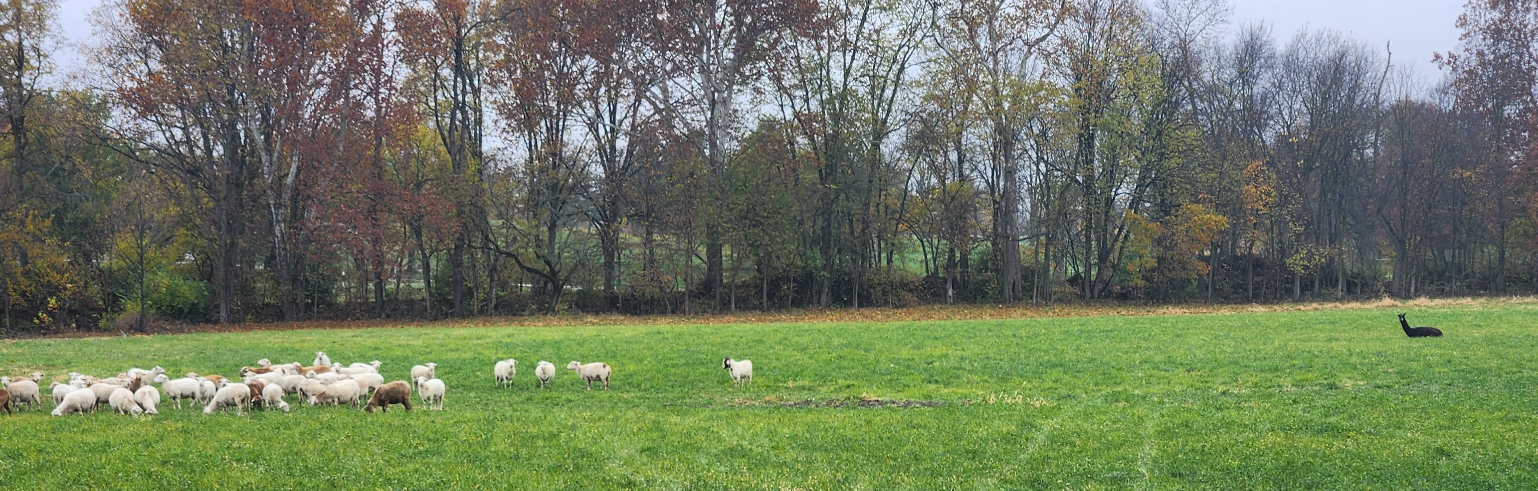

I have 50-150 Katahdin sheep (hair sheep). It sounds like you are trying to make things look nice, so you may want to run a hot wire at about 18". My sheep rub on the woven fence, which will stretch it. We've had a couple of steers and they leaned over the fence bending it down too (barb wire wasn't as effective as I expected). Most recently I had some 6 strand high tensile electric installed and really like it. It keeps a lot of the wild life out and the critters in. All of my future fence will be high tensile electric on wood posts. I had a professional installer do the perimeter, then I handle the interior fence and along the creek. The professional does much better work than I do; he has the equipment and knows the tricks to make it look nice.
I have a two rams, a llama, and goat to guard the flock. Before them, I did have a coyote problem.
