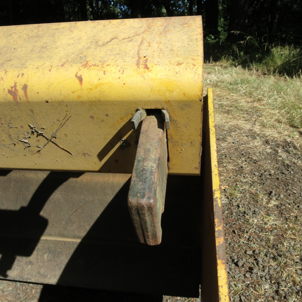

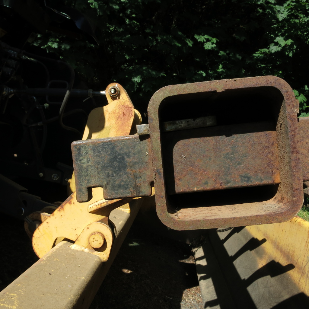

It looks like there is a lever that locks the ripper in place when there down, does that mean you shouldn't have the half or 3/4 of the way down? I understand the cylinder would be doing the work

The mechanism locks the rippers when down so the cylinder isn't taking the load.

The ripper is meant to be used fully deployed. On mine, there are two depths at which the teeth can be set for shallow or deep digging. They are held in place with a sturdy spring clip.
