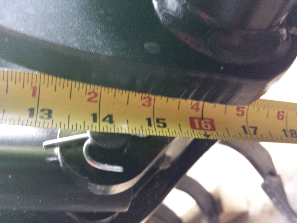

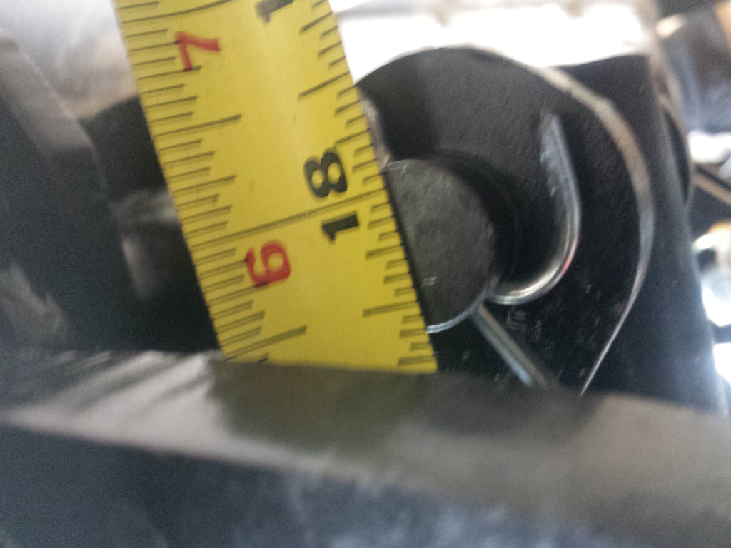

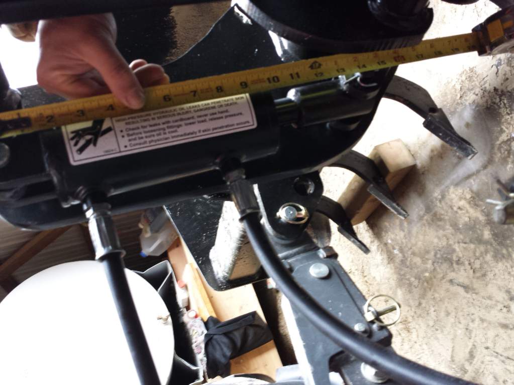

Mine is the exact same with the addition of -1 13534-1 I'll take some measurements and some pictures for you that whey you might be able to determine if its close enough

Measured the minimum length it's between 14.125" and 14.25" center to center.
17.75" long at max length
Not sure if the stroke is any longer but that's the max I can extend it while it's attached
The cylinder body is 8.5" long

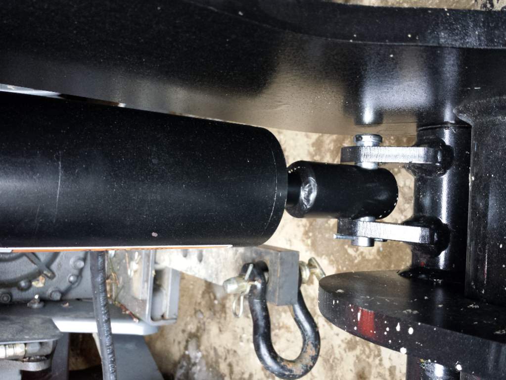

Dave, would you please get the width at the bottom between the clevis where the pin goes through the cylinder rod end? That and the distance between the clevis on the top end of the cylinder.
Any chance that you would post a picture or 2 of your Tisco top link? Always good to see what the competition offers.
